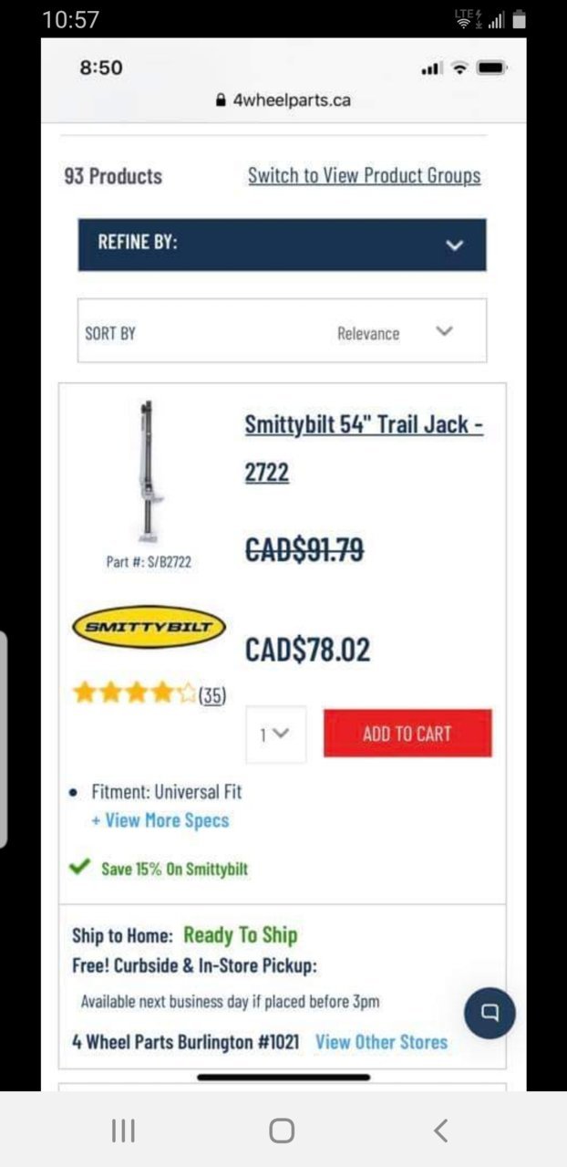

    anybody looking for a trail jack will match 4wheels price on this let me know :thumbsup:

    Those farm jacks are so handy and versatile but so fucking dangerous as well.
    I would never go under a vehicle held by one of those. Even tire changes would be sketchy

    We had a guy blow a valve stem in Bobcaygeon a few years back - only option to jack him up was with a farm jack.
    Loosened the nuts with the truck on the ground.
    Had 4 guys hold the truck once it was jacked up by the hitch.
    Used my cordless impact gun to make the change quickly.
    Dropped the truck as soon as the nuts were snug.
    Torqued it back up once it was safely on the ground.
    Still scary as shit, but effective and quick...
    I don't bring jack stands on trail runs, but I usually have a chainsaw. Could cut some logs as jack stands...
