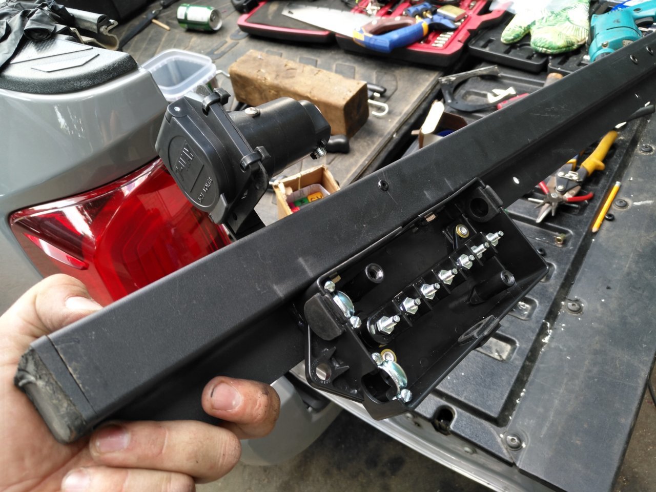

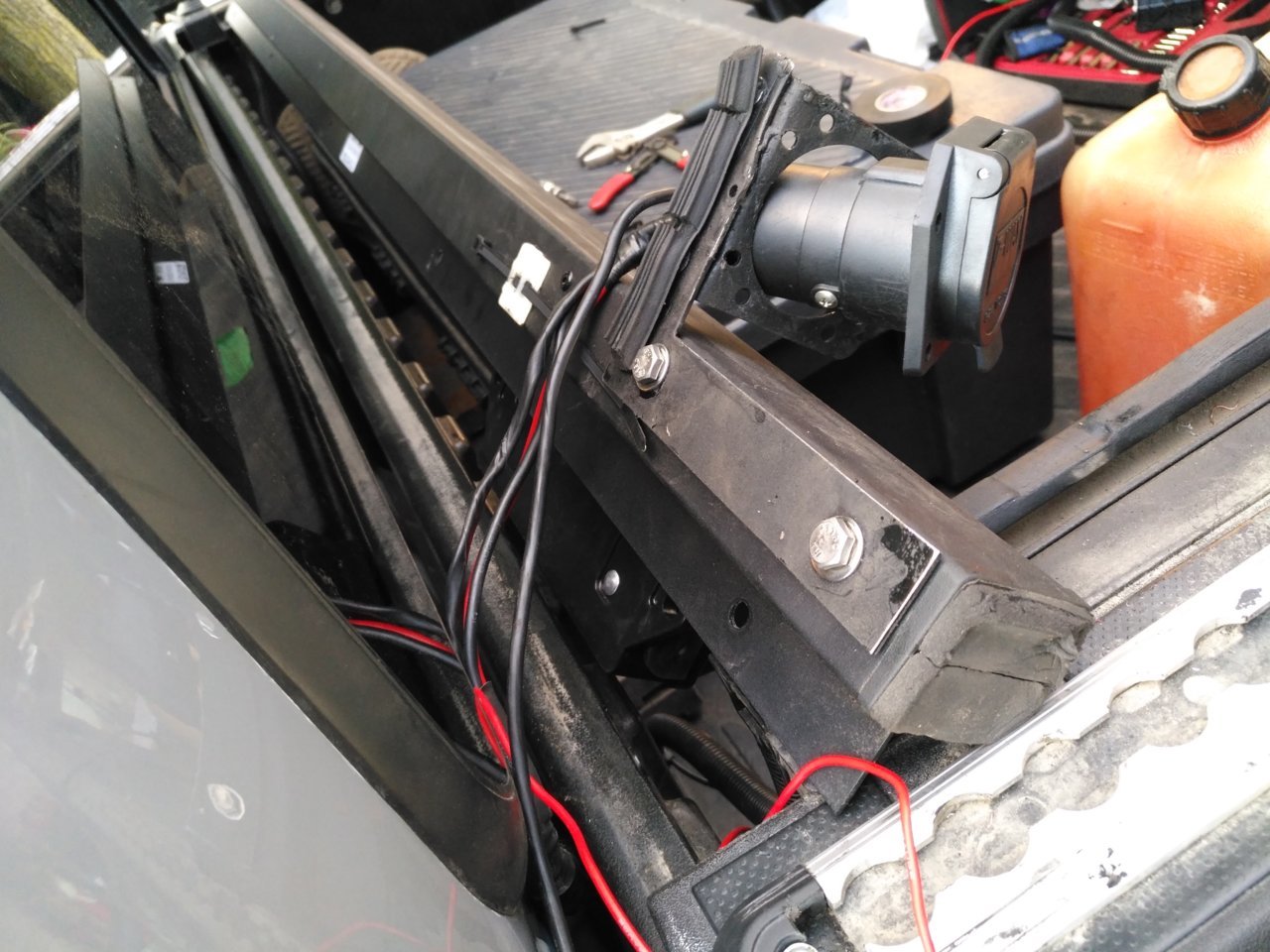

    The 7 pin trailer connector and junction box idea worked really friggen well...
    Added in 3 new wires to the wiring harness that goes between the front and the rear;
    2 sets of 10ga for the junction box and future 42"bar, reused the 2 sets of 16ga for the pods, and added a 18ga for the bed lights.
    Replumbed the harness through 1/2" non-split tube which was a pain to route from the rear to the front.
    At the 7pin connector, routed a wire for the junction box which (God, thank you for riv-nuts) and set up wiring for the bed light kit (12v led strip lighting).
    Tomorrow will be wiring the bedlights and the truck will be ready for the 42inch bar, CB antenna, and whatever else i decide to add. Other than that - I'm done

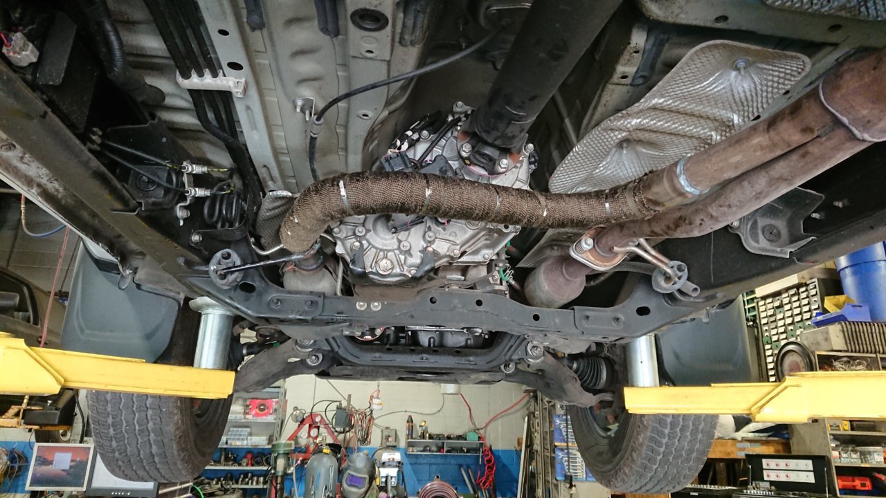

    Big thanks for all the info you sent my way and directing me to a great shop that did my exhaust reroute! I recommend this place 100%!

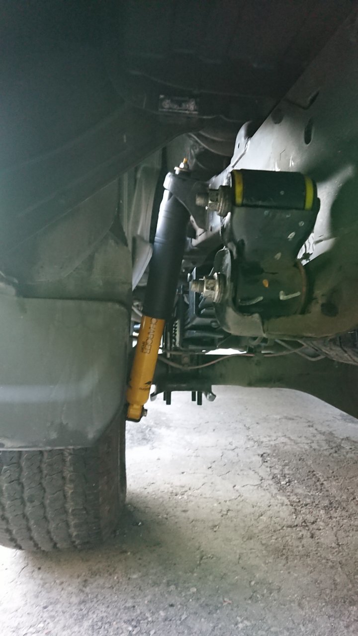

    DSC_0024.jpg He also did the alignment using a fish line , electronic level and a ruler!!! Absolutely mind blowing!!!
    I'm really happy with the outcome (despite slight vibe from the rear).
