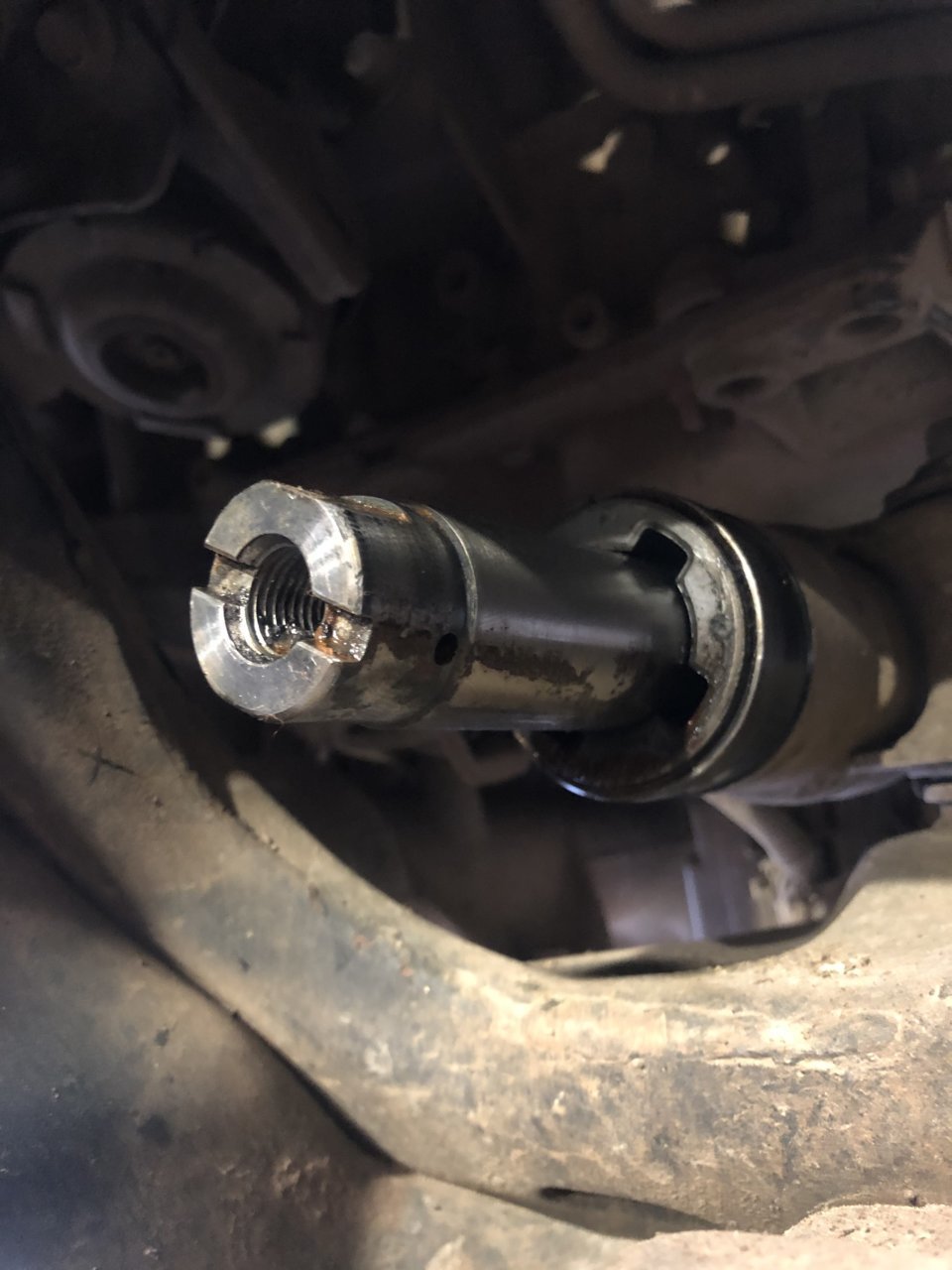

    Upon rack removal today it was concluded through my scientific ass research that the leak was caused by rusted rack that damaged seals and ATF wasn't at fault... As a matter of fact viscosity of ATF isn't going to hurt and actually improve and reduce steering fade unless you already having rack going bad and rust grown on rack scratching seals though. Check your boots regularly and make sure no water inside of them.
    you can kinda see rust here, it's all over the rack. I'll have more pictures later.
    This rack only lasted 50K since the last replacement by Toyota for general information.

    So 250K life expectancy if you aren't dunking your truck every weekend? :p
    At least this looks like something that can be mitigated if caught early enough - sand and polish the rust down.

    Pretty much, look at @tacoma16 and him still running original rack, the only thing that still doesn't leak and truck always stays at malls and takes only dirt roads, so 250K is a safe bet here :p:D
    But then we got mystical @Joe23 and his rack is pissing just from hitting curbs at the malls.
    So I would say it's a gamble here:censored:
    I expect this one to last me 2-3 years and by the time it fails it's either going to be replaced with alternative/better solution or completely rebuild.

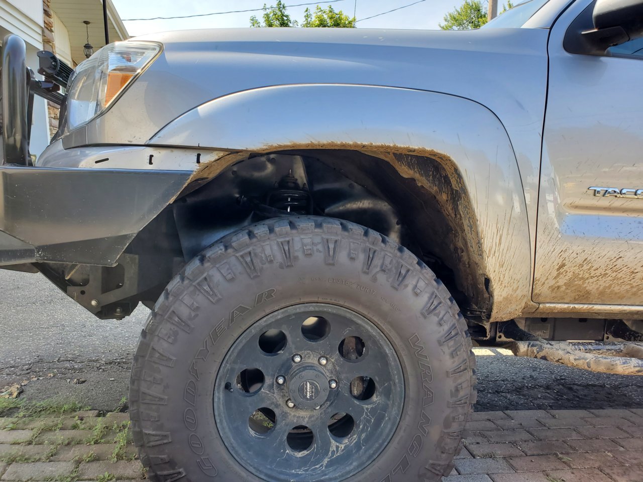

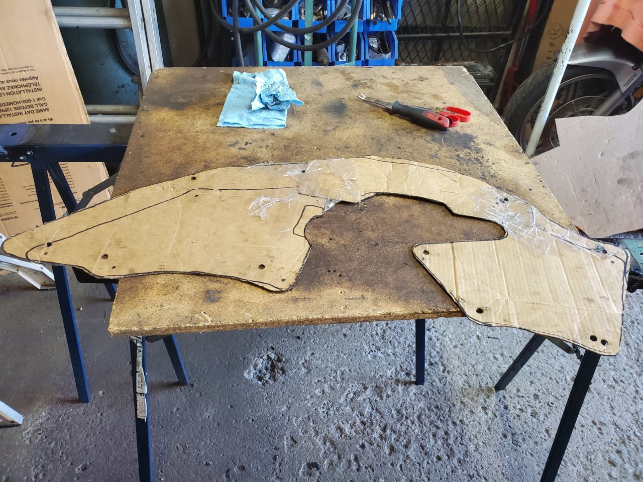

    A big thanks to the gentleman at the last who told me not to waste my money on gap guards.
    Made a Tempate and then made some guards.
    Thank you for the advise.

    Save that template! I'll need to make new ones for myself, my stock ones are gone...

    @Windigo post that and some images here; https://www.tacomaworld.com/threads...bay-splash-guard-rock-guards-template.621635/
    are you kidding me...
    MY DUDE, WE HAVE A TEMPLATE. I HAVE THE TEMPLATE IN THE TRUCK AT ALL TIMES FOR SOMEONE TO USE
    THE TEMPLATE IS ALSO DIGITAL
    AND HAS BEEN FOR OVER A YEAR NOW
    IT'S ALSO IN MY SIGNATURE BELOW THIS MESSAGE FOR JUST AS LONG.
    HOW HAVE YOU NOT KNOWN ABOUT THIS????

    I have a 2" body lift so not exactly the same mounting holes. It hear in case anyone needs it. :)

    regardless of the body lift, it'll be a nice addition to the collection of that thread. that way those *with* body lifts can also use your template

    Yes this is the way. Don't spend $145 + $55 FedEx brokerage on GearTech Customs splash guards like I did. :bananadead:
    What rubber mat material did you use?

    Cheep.rubber mats . They come in spill kits to cover up catch basins or the sewer grates. They rip very easily so ill be makingnit again soon.

    so tell me about that rust that's going through the paint then
    I'd love to hear more about it
    :pccoffee:
