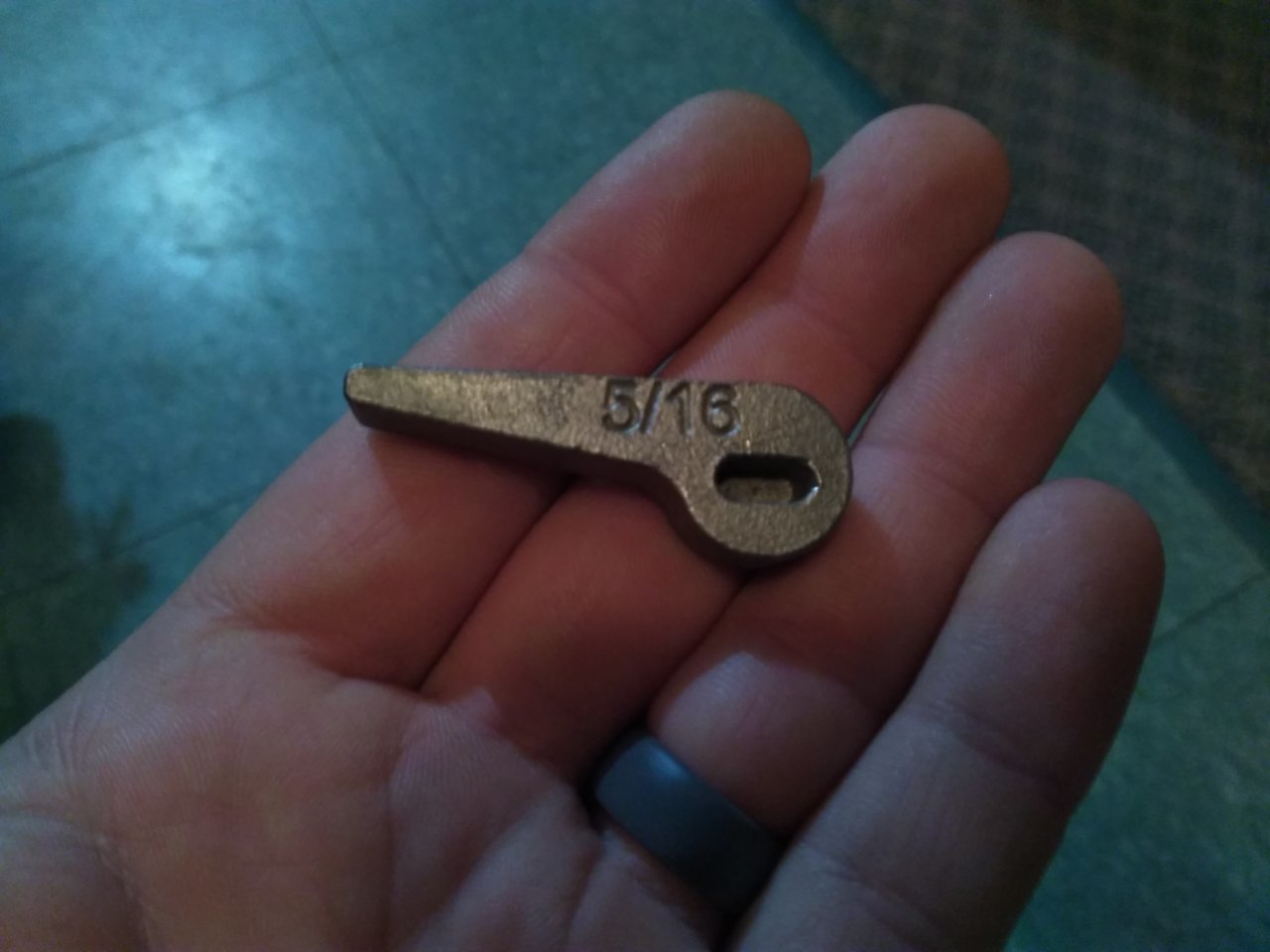

    That is mighty fine of you!!! If we weren't 5 hrs apart this would have worked out perfectly, however I still may take you up on the offer...Im leaving tomorrow to head North but working and plan to wheel later in the week. And as luck would have it, one of my meetings is in North Bay.
    I see Two options...
    1. I try and find a place to order a replacement(to you door) in time for your winch install so you dont get f'd. OR
    2. I could grab that piece from you and have a local machine shop in North Bay machine several so in the end we both have spares.

    I can’t believe it. I just found the damn thing!!!
    Thanks for your help and the offer! Wonder if I should still get some spares made for next time lol

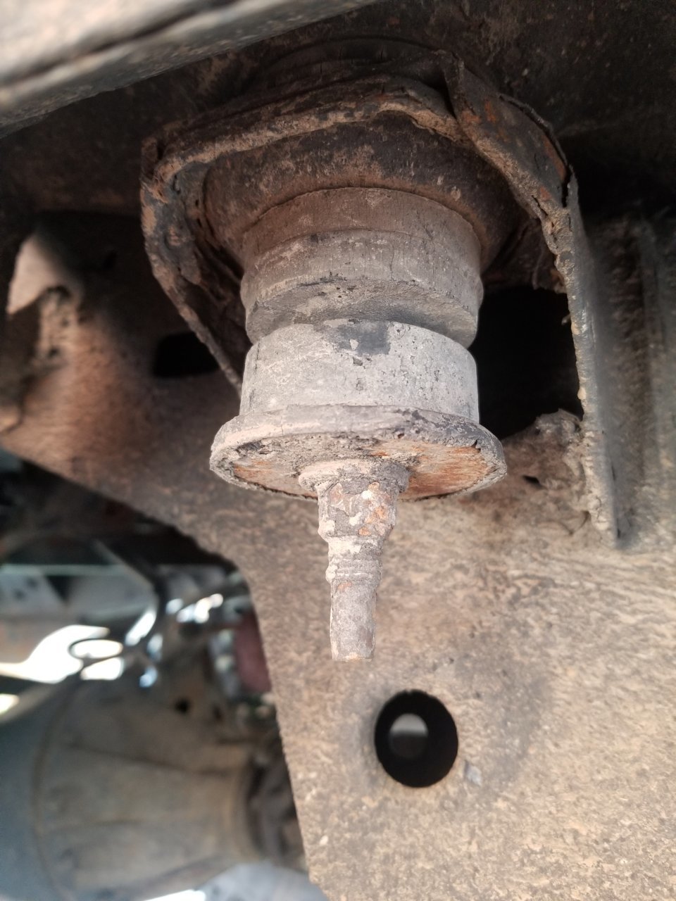

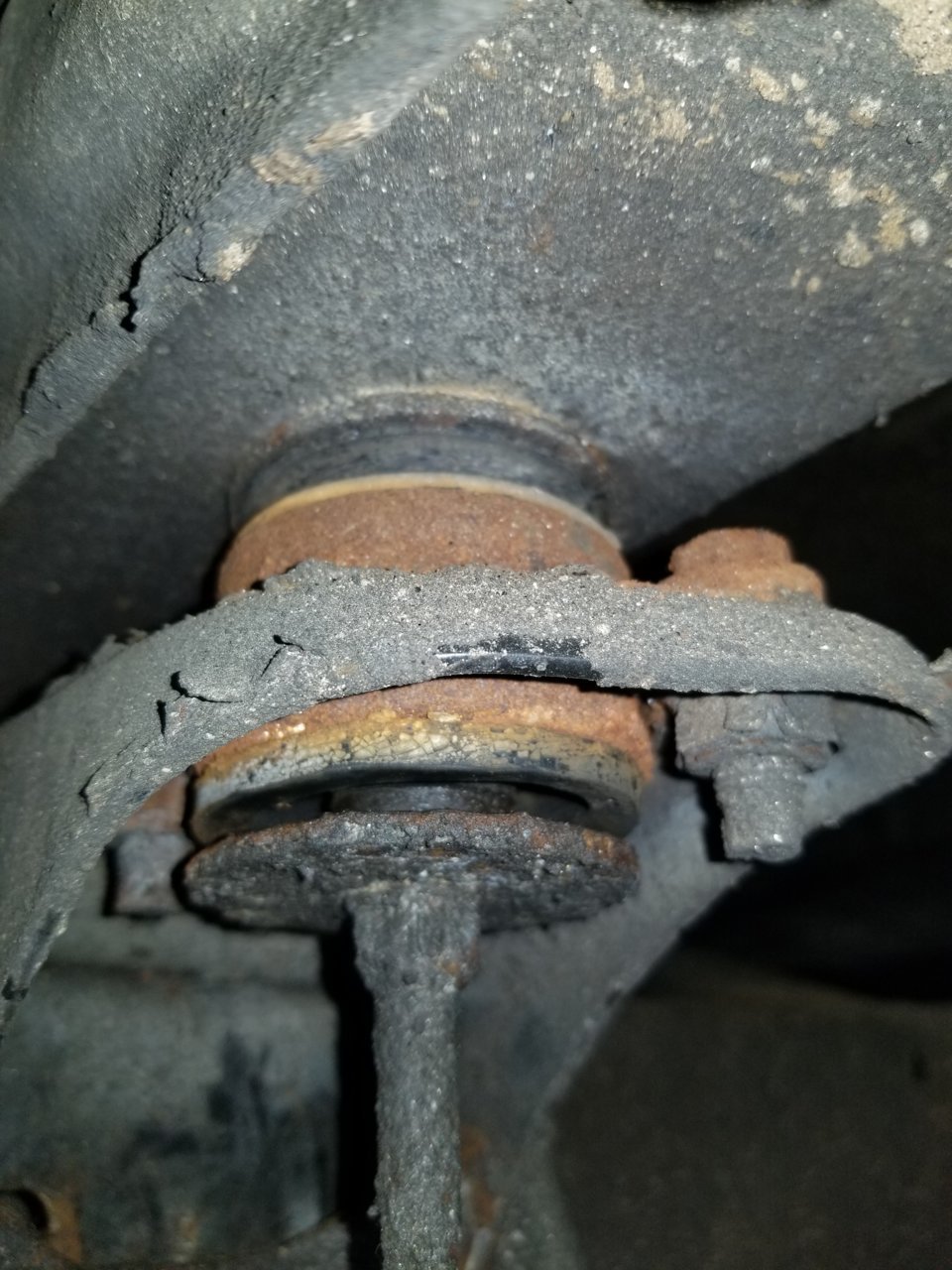

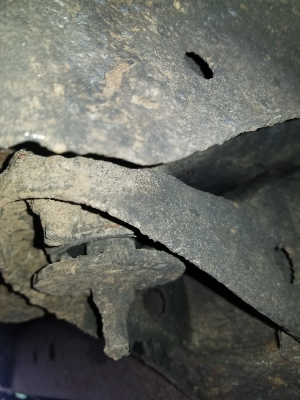

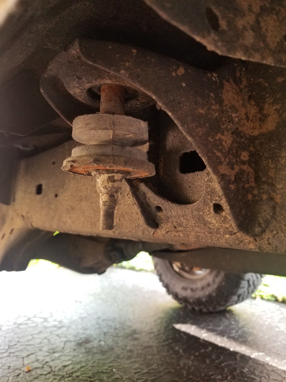

    I was gonna pressure wash my frame from the 20 years of dirt and then Krown it but I might take you up on that.
    On a side note I wanna get all your opinions, looking into my 1" body lift before I purchase my rock sliders. Basically trying to judge if I should be changing my body mount bushings or if yall think I can save them with some beautiful torch work. Any input would be appreciated. Thoughts?

    See if Energy has a kit for your truck. For the $100-200 it may be worth it while you are in there.

    Ya, I've found the kit. I think it'd be better to replace them rather than chance a bolt seized in a bushing.

    Bolts can be had at the store and for how old your bushings are they may be thrashed. My front rad ones were toasted.

    Start soaking in PB blaster or something similar a week in advance... MAY make your life easier...
