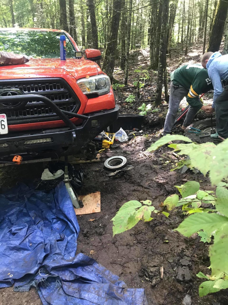

    Eugene

    I see a wheel bearing separated from its housing. Unusual failure. Wonder how that happened. Axle nut backed off? CV stub shaft broke?

    Whats the story hear?

    Believe he broke a cv, removed it and didn’t have anything holding the bearing together (what I almost did in ardbeg....) so the bearing separated while driving.
    I am now carrying 2 hub portions of our cvs for a “unlocked hub” deal to get home. Also have the diff side too, to plug it. More prepared this time around.
