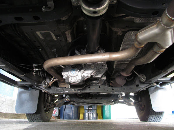

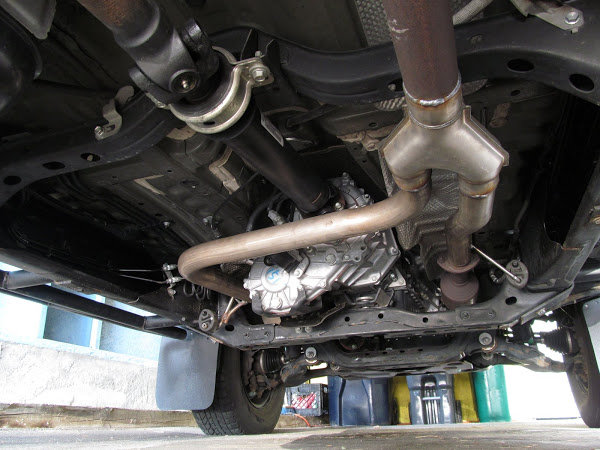

    Budbuilt full-length skids, "lite" version 1/8" thick steel. Workmanship and powdercoat quality are pretty good. However, it's an older design. The front skid uses OEM brackets, which means I lose an inch of clearance in the approach area compared to other brands (All-Pro, Relentless, Pelfrey). The transfer case skid crossbar flange had to be notched because my CBI sliders had a mounting flange in the same location.
    I also got my crossover pipe re-routed at a local speed shop. Custom-bent stainless piping with a prefab Y-pipe:
