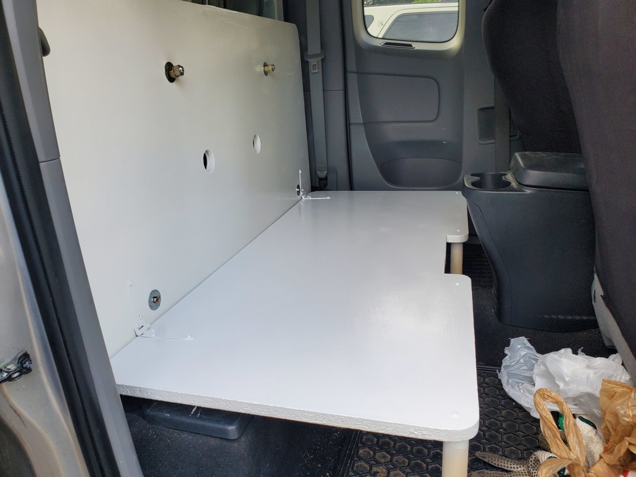

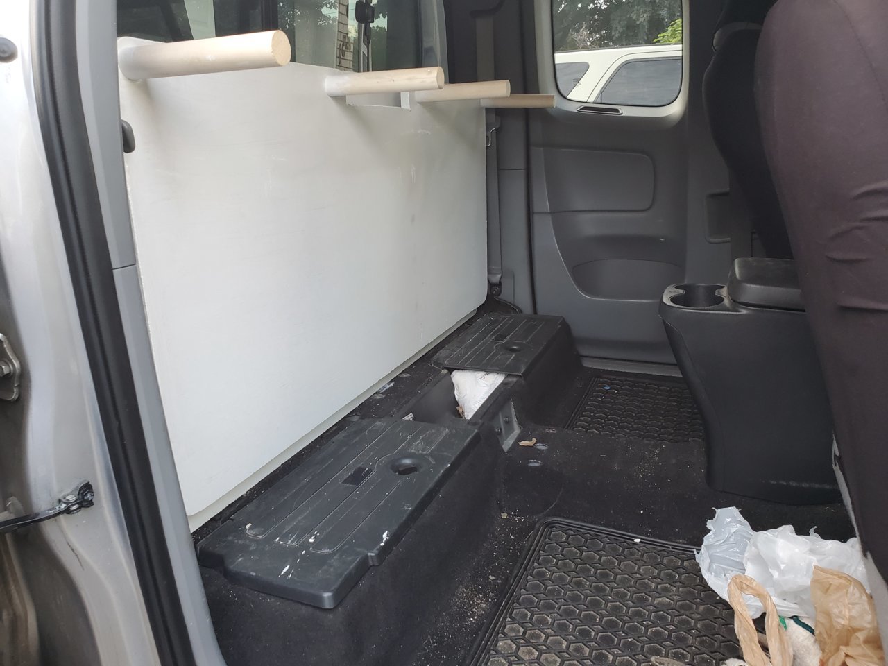

    Did you get any airbag caution lights when you removed the seat belt retractors?

    Nope, the rears dont have any of those I guess. :rolleyes:

    Dude that looks fantastic!
    Dont worry about hardware and what you use as long as its functional!
    My light bar is bolted to gate hinges....
    But yeah utilize the space if you're not using it.

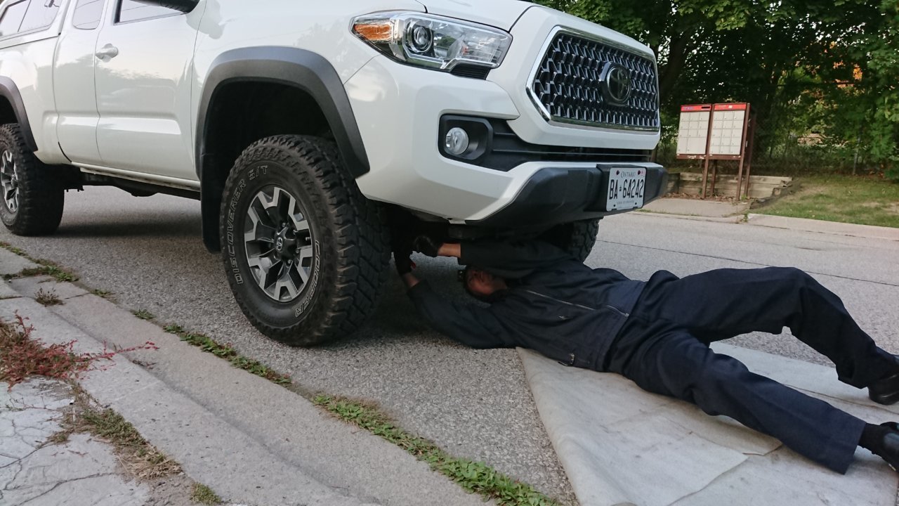

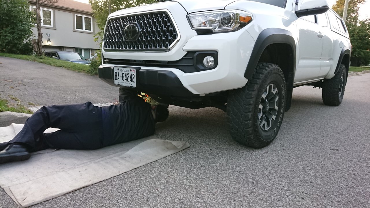

    So here's the story: most of you won't read because it'll be long
    Got a new set of tires and the offer came with an alignment special. Ok, do the alignment .
    Went home over some neighborhood roads so I didn't feel anything.
    The next day I go to work using 400 series highways and.... I can barely keep the truck in one lane!!!!
    Pulls to the right, steering input lag is insane and so on...
    Looked under the truck and cam bolts are turned in all directions, one wheel sticks out, the other falls into the wheel well...
    Decided to take it to a place where they do high end cars.. ( not Eugenes place)
    After their alignment, wheels are still one in, the other out, cam bolts point in all directions but the truck became somewhat drivable.
    Not 4 days after, I feel every single tire lug every time I turn... Something's wrong.
    Looked at the truck from the front and... my front wheels make a perfect V. Yes, the outer edges started wearing out already...
    Now I'm getting frustrated as I don't know what to do. In the meantime, I called one other alignment shop and I heard I need to leave the truck for the weekend to get it done..(?) Like fuck !
    So I contacted one TW member regarding this matter and what happened...
    He shows up at my driveway the same day with all the tools , gets caster and camber done in 30 min with an electronic level (!!!), approximate toe with a fishing line and a 3rd grade ruller. Toe was not perfect, so it took two more attempts to get it right.
    All in all, no waiting, no leaving the truck for the weekend and it's driving as it should!!!
    BIG THANKS TO THE MAN!!! @3JOH22A
    Manfred, cwisema, Sloweburn and 16 others like this.

    Thats a rollercoaster, glad to hear you managed to get it fixed with Dax, is there still vibration with the tail shaft?

    I still get some at starts and at highway speeds but that doesn't always happen. Might try 2 degree shims before ardbeg as it will bring down working angle down.
    time will tell...

    I learned with my truck you can't tell the alignment shop to just align it, as they MAY put it in "Spec" but the Toyota Specs for the Tacoma are too wide, and wrong target values...
    Lol even watching the dealership guys do it, they are following the alignment computer directions on which bolt to turn and then trying to get it in the "Green". And even in spec these trucks will drive like shit...
    I tell the alignment shops/dealer (stock control arms 1.5" lift);
    " Crank the Caster all the way up as far as it will go, Passenger side to have the higher caster by a max of .3deg
    (they should easily get +1.5 to 2.4 deg depending on the truck and how much lift)
    Set Camber to 0.0 both sides.
    Set toe to =+0.2 both sides.
    Do not bend the tabs,
    Make sure the cambolts are properly torqued to spec when you are done.
    I want a print out.
    Make Sure the steering wheel is centred as I go all OCD when it's crooked "
    First place they should start (after clamping the steering wheel straight) adjusting is the Upper control arm cams, for the Caster,
    (brings the Upper ball joint closer to the cabin) if they start at the lower controls arms then give them a smack and tell them to start with the upper and crank it all the way back towards the passenger cabin and start from there.
    If they start adjusting at the tie rod ends before anything else...
    tell them to bring your truck down because they do not know what they are doing...
    Which seems to be a lot of alignment shops....
    Round of applause for @3JOH22A ,
    proving that if you feed an old guy some beer and give him a piece of string,
    he'll out perform a millennial with lasers any day of the week!
