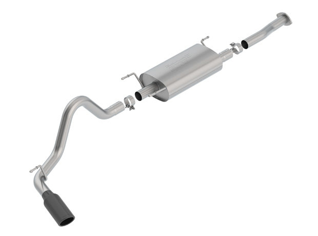

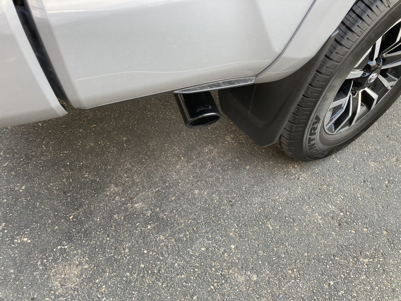

    Also have a Borla S type exhaust, which I want to sell again, kind of disappointed by it to be honest, I did come from a 2018 Sierra that had longtube headers and was straight piped so the Tacoma can’t really compete lol
