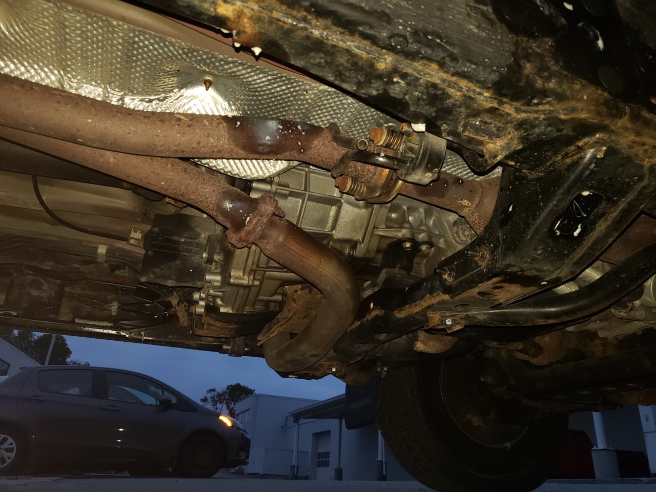

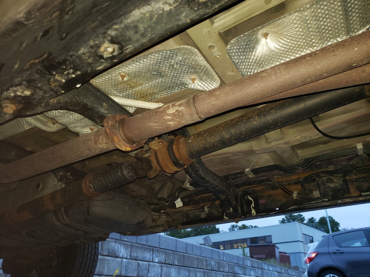

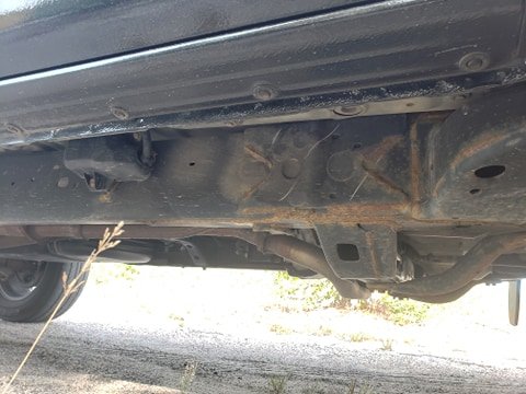

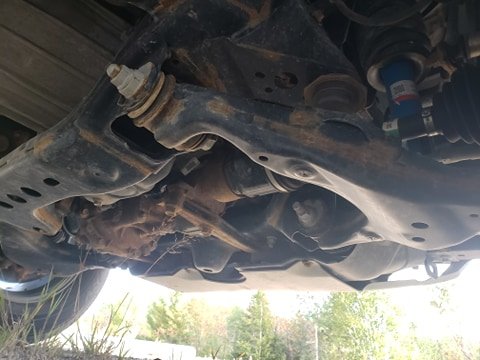

    And that one in the pics has had the "frame corrosion TSB" done to it...
    LOL :homer:
    I'm surprised the exhaust pipes have corroded so much, the Tube is supposed to be stainless (probably a cheap 304 stainless) but I knew the flanges were mild steel so they will corrode regardless.
    Even though that one looks real "rusty" if all those areas were sprayed down with penetrating oil or rust converter or ACF-50 or ATF, the rust would be neutralized and convert to an almost black colour.
    Alignment cams will probably be seized solid though...
    The goop they put in the seams is Beeswax based... so unless is has seeped in to all the problem areas where water can get trapped (which it won't) it won't even be much help in the areas they applied, and may actually help trap water inside... it'll harden in a couple years too...
    And unless the frame is still hot when they apply it, it won't creep/seep into all the nooks and crannies to seal them from moisture....
    (that's why the put an air dryer into the frame cavities before they apply it)...
    Rest of the frame is not treated at all in that TSB... Frame plugs do squat to help....
    In late 2017 they started spraying a very thin wax coating around ALL the seems and bracket mounting points in the frame (you can see the "oily" sheen on the new ones... bit even then, it is not good enough to do squat.
    It seems Toyota is not doing full vehicle Salt Spray testing (or a reduced hours test) otherwise they would have caught a lot of these corrosion issues on the frame and all the different sensors etc. (front TSS "radar", ADD actuator, transfer case actuator etc.)
    Like they did the design and reliability testing in the desert...

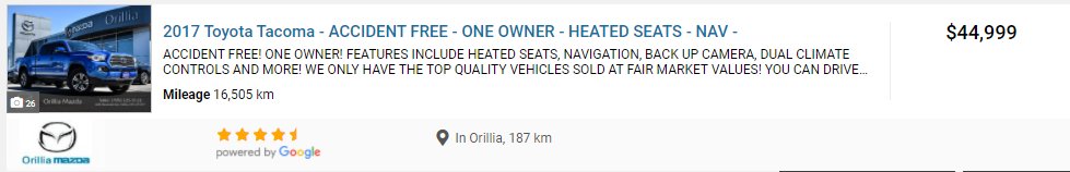

    I paid less than that for a new 2018 including winter rims and tires and PDI before taxes.

    Lol holy crap... that is more than what I paid for mine NEW! Like 5K more...
    I've never looked at buying a new regular production vehicle as an "investment" before...
    Lol roughly 3% return on a daily driver o_O

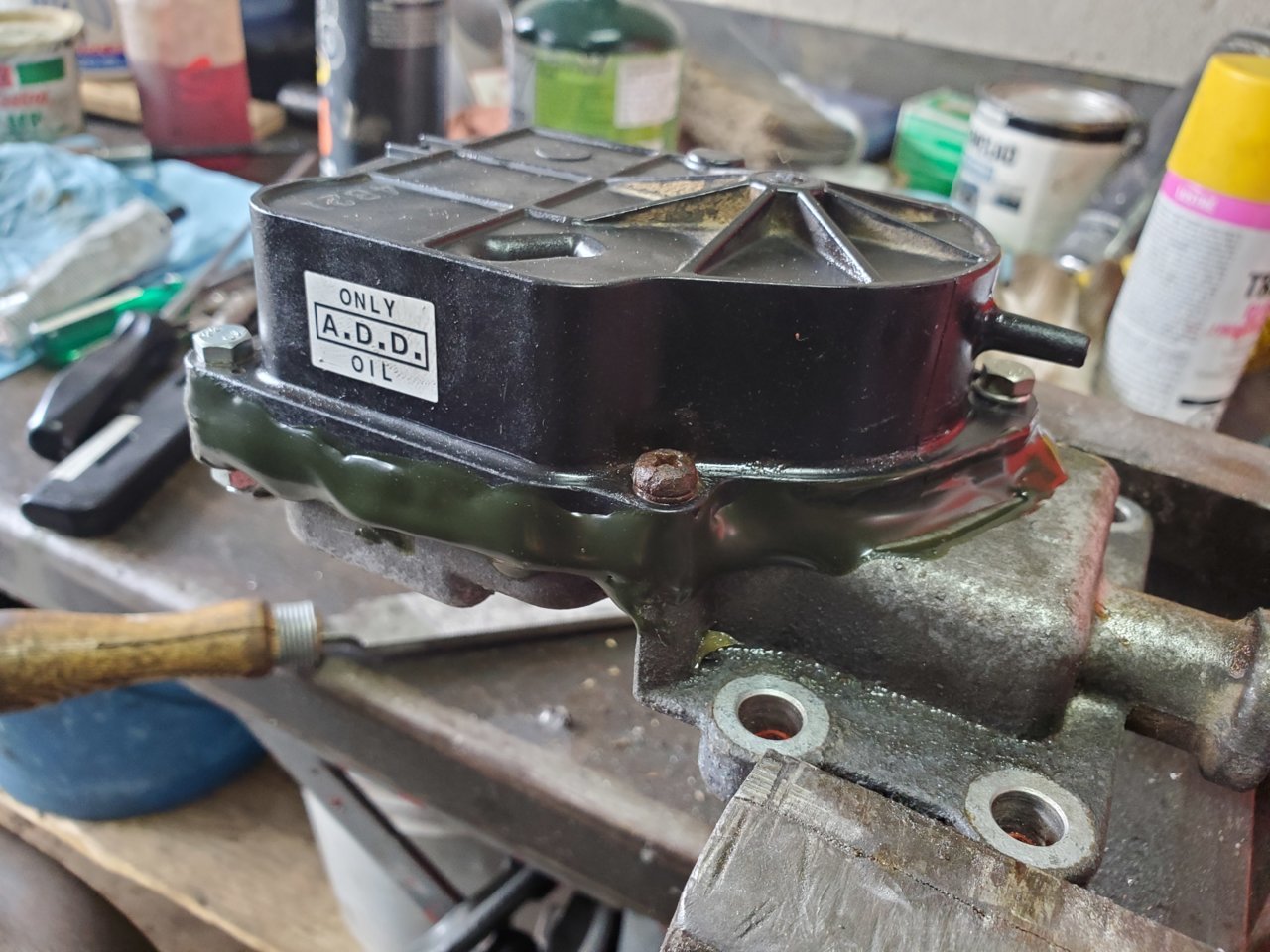

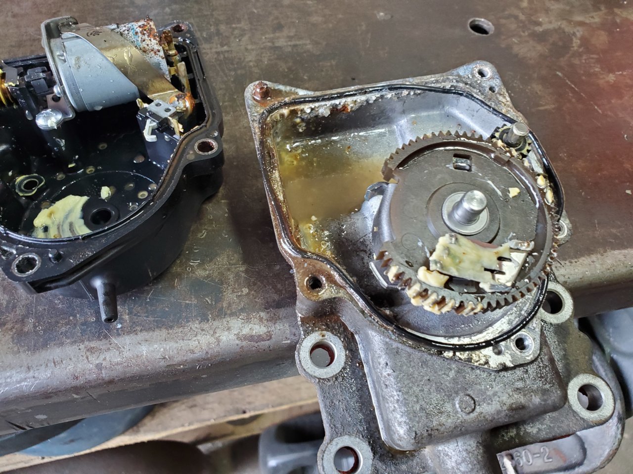

    So just.to finish this topic yes there was water in the actuator among other things.
    Thank you

    I assume this is from deep water crossings? Is just a shitty OEM seal or is water getting in somewhere else?

    Hmm
    I think I will remove mine and take a peek inside this weekend.
    o_O

    From what I can tell its corrosion around the o ring seal. The solder connections were all good. Water was going in and out from that seal. Ised some weather strip adhesive to seal it up l. Let's see what happens.
