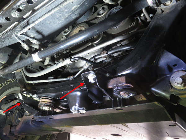

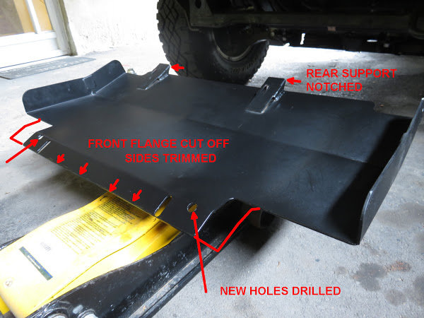

    I'm actually offering the new set from my truck, removed at 4 months and never off-roaded. I cut up the braces on my old rig as part of the BudBuilt skid modification to improve clearance; they have been moved to my current truck.

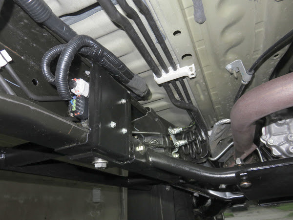

    On the passenger side, there's an extra electrical connector covered behind a black plastic stone guard sitting outside the frame rail. My CBI slider flange cleared it. Another brand with bigger flanges may require trimming the flange or relocating the connector.

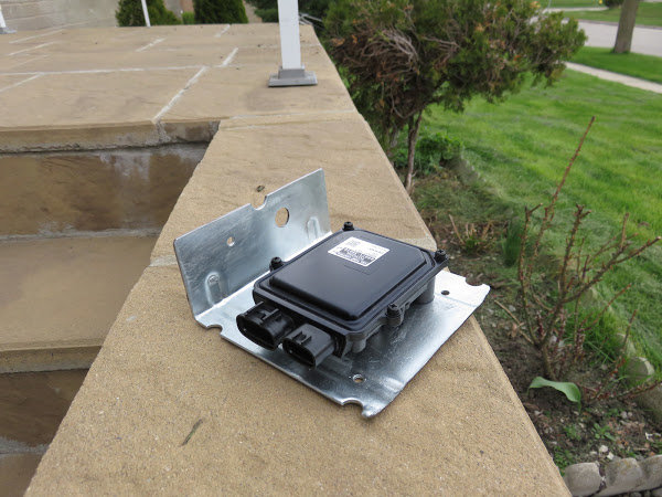

    On the driver's side, there's a fuel pump ECU bolted to the inside of the frame rail. It interfered with a slider mounting bolt. I made a custom bracket out of Home Depot stock and relocated it (effectively flipping the ECU 180 deg):
