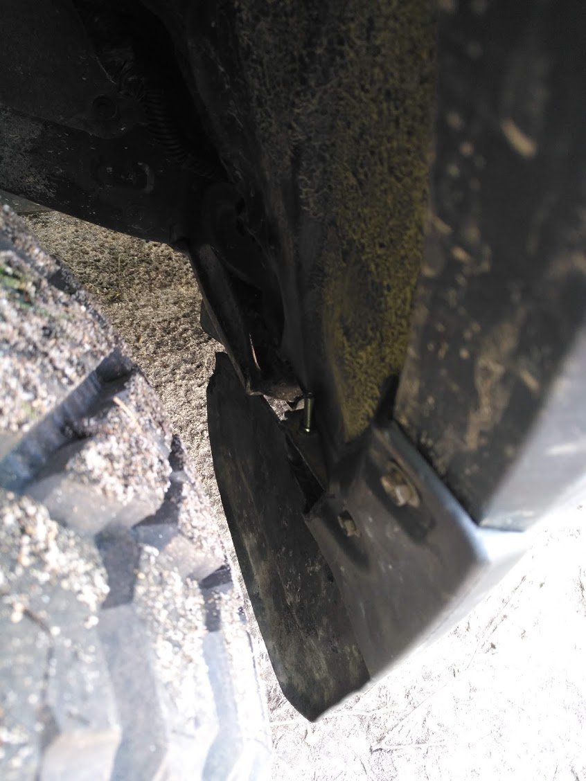

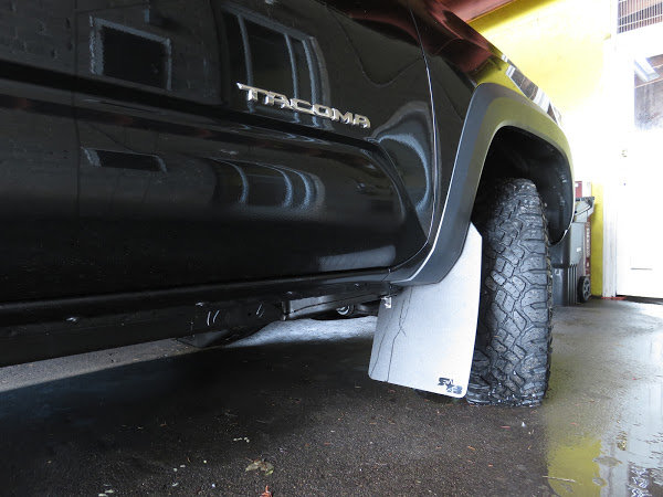

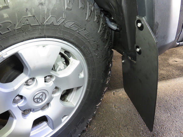

    Here are pictures of my RokBlokz XL flaps. I don't have 285s but it looks like they tolerate inner fender plastic trimming (especially the protruding part) as long as you can keep the fender flare holes. The bottom mounting point attaches to the cab mount with an L-bracket and well nut. Even after a cab mount chop, you can flip the L-bracket around and use the aft hole.

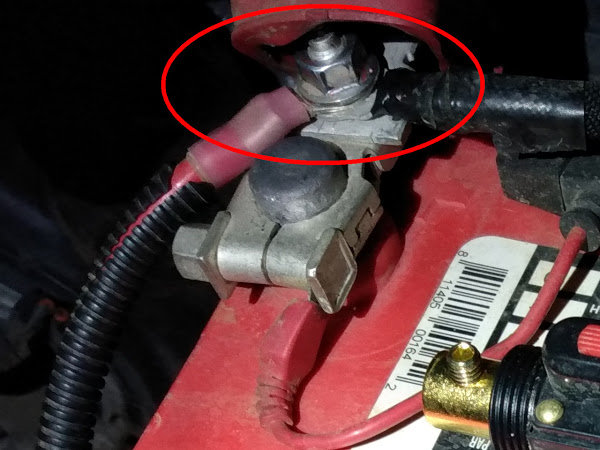

    If i want to run an auxiliary wire to the battery, do I just undo the positive terminal and connect a wire underneath? Do I need to disco both terminals? This is with a fuse/relay included already.

    1. If you disconnect just the positive terminal, reconnecting it will often cause a spark. Most of the time this doesn't cause harm. If you disconnect both positive and negative terminals, then reconnect the negative last, there won't be a spark.
    2. If you lift up the red rubber cover on the positive terminal, there's a 1/4" stud for easy attachment of aux wires. Just crimp an eyelet to the aux wire and bolt it on. Don't actually need to loosen the battery terminal.

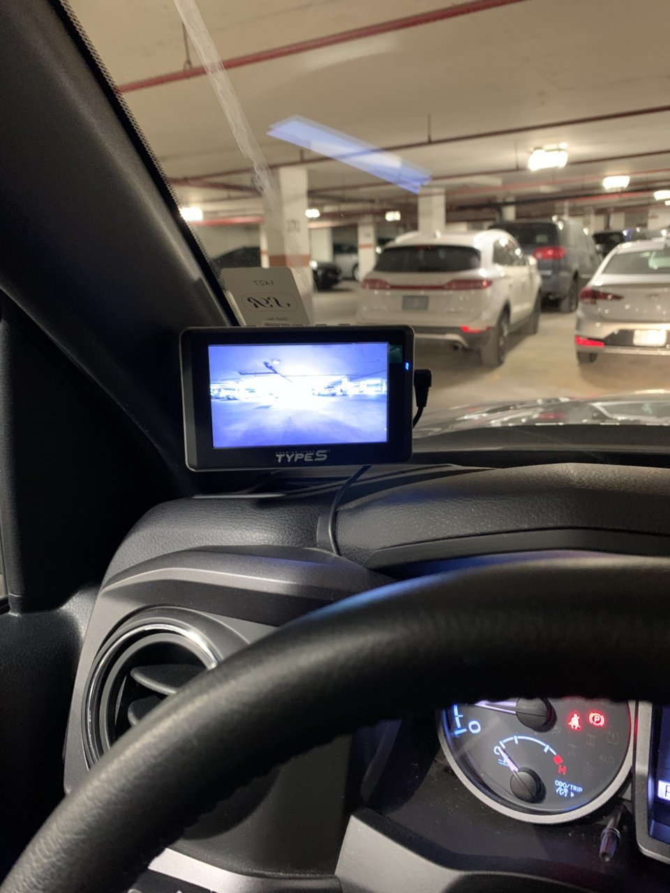

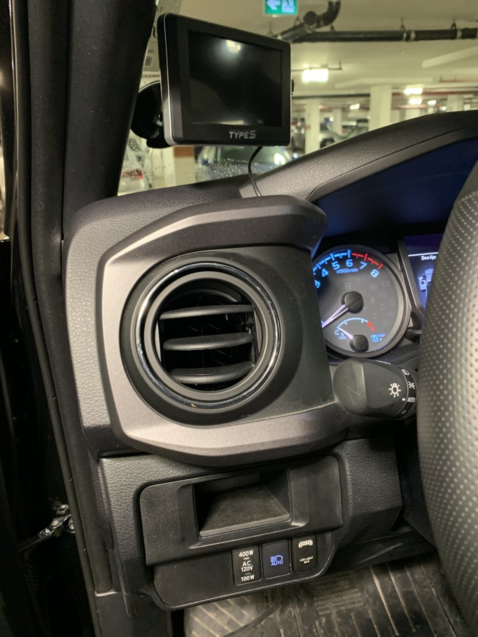

    EBF99072-B2EA-4714-B223-6670DC02B680.jpg 38BA33C6-3474-49EE-9763-BD6F5CBFB443.jpg Finished the reverse cam/forward cam mod.
    Had to get LED light bar button since they don’t make forward camera button.
    Also ran a fuse to the battery wire, hope 20 amp is enough.

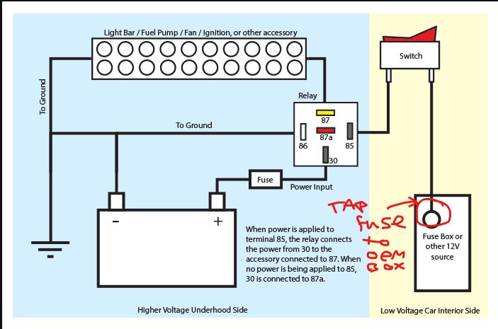

    So I've attached the wire, the switch turns the lights on and off, no Illumination on the switch when off. Do I have to worry about any power drain? Nothing is lit when the truck is off but the lights will turn on without ignition/accessory. Is it the relay that stops it from being hot all the time?
  20. Dec 21, 2020 at 5:52 PM
    Shveet
    Shveet joe-shmo
    May 28, 2018
    #254719
    6,462
    Own-tario
    2018 shitbox
    where is the relay? your switch should be powering the relay which would let the power continue through to your lights.
    not sure about a direct switch, but i can't imagine any power drain.
    i have 6 switches going to fuses and relays which then go throughout the system and the only drain i have is 1 switch in the bed which is just the red LED constantly on to locate the button in the dark
    the lights turning on with the engine off is normal. since you are bypassing the computer of the truck and powering things directly off of the battery.
    if you want the switch to be dead when the truck is off - then you will need to fuse the switch to the OEM fusebox (tap fuse would be easiest as you would piggyback off of something else) and then continue on to the switch. (you are providing the switch power from the tap fuse which would then power the relay
    This way, if the truck is off - the tap fuse will not power the switch that will then not power the lights because the relay is not powered/ turned on.
