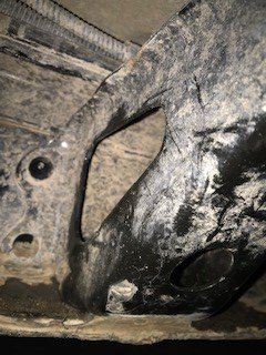

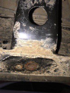

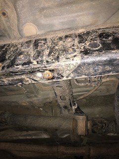

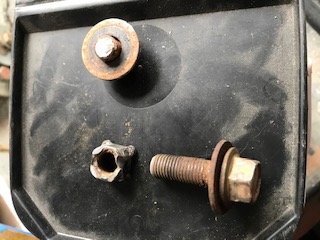

    Hi guys, I took my sliders off yesterday and I guess I put the bolt on the bottom of the frame in too tight last year, because both of them broke. I sprayed them with WD40 rust release but they wouldn't give. One broke at the head so I have to get it out of the hole now. The other broke the welds inside the frame. I had to grind a wrench to fit in the hole in the cross member to hold the nut and continue to turn the bolt out.
    The cross member that is right above the bolt seems to be held in with 4 rivets on each side. What is the reason for the bolt? Am I safe driving the truck with out these bolts?

    might help if you have any photos - i can't seem to imagine where you're broke the welds

    Pics as requested.
    The bolt on the bottom is the one where the weld of the nut (to the left) broke.
    This is the hole in the bottom of the frame and the crossmember above it.
    You can see the rivets in the vertical part of the frame.
    This is the crossmember in question.

    Why don't you just put a regular nut & bolt through the hole? Use stainless if you want to be fancy.
    That same bolt on my frame has been mangled by rocks already, either at Minden or VMUTS.

    That's the plan, but I don't have any right now and I still have to get the broken bolt out, so there will be a little while before I can get that done. That's why I asked if it was safe to drive without the bolts in. If the rivets aren't strong enough on their own why not rivet the bottom too? Why would Toyota put a bolt on the bottom?
    Getting the bolt out with the nut loose inside the crossmember was a real pain. The wrench keeps slipping off the nut due to the angle. So I'll be trying to find a tall nut to replace it.

    Could be lack of jaw access for the automatic riveting machine at the frame plant :notsure:
    It's probably OK to putt around town, but not hard use (towing, bombing down a trail).
    Did you try a socket in lieu of a wrench? Impact driver on the bolt head helps, too. The resi mount for my rear shocks ended up at a crossmember, too, but I was able to reach the nut with a socket to tighten it. An offset wrench might work as well if you got one.
