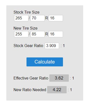

    Actually both responses were quite helpful, the calculator helps give me a ball park calculation to where it would feel like "normal" from the looks of things.
    the chart after helps visualize where i am/ where i would be.
    red square would be where i am now i guess.
    I'll need to look into what the actual gears are in my OR are, but implying i follow the chart i posted (as i'm an AutoTrans) i would have 3.909 cut gears. but if i swap out the rear gears to the 4.3 from a Manual transmission Tacoma, i would find an improvement then by putting myself into the middle of the field. i would be a little less fuel efficient than i am now, but looking into the Nitro gear guy's review

    The chart is SLIGHTLY deceiving in terms of fuel economy..
    To elaborate: being on the lower end(lower number or blue side) of the scale, you theoretically see better fuel economy ON HIGHWAY.
    If you do a lot of city driving or towing/off-road driving though, the opposite will be true due to the starting and stopping. As mentioned, the lower gear (higher numerically) will get the truck moving much easier.
    Gearing is ALWAYS a balance and it's a matter of compromising one thing for the other.
    Manufacturers tend to find a decent balance overall.
    Changing the gears essentially changes the speed of the truck at a given RPM.
    Random example with no math being looked at - if you currently drive 60kph @ 2000rpm, changing to a lower gear (higher number) will require more rpm for the same speed (60kph @ 2300rpm for example) **again, I didn't do the math.
    So with the ratios you have referenced - at one set RPM, 4.88 gears will turn the tires SLOWER than 3.91 gears.
    So if you only regear the rear axle, when you use 4WD, the front of your truck will be trying to drag the back of the truck along.
    BEST case scenario, handling will be awful and you lose traction.
    WORST case scenario, you have a HIGH(almost guaranteed) chance of breaking components.
    Hope that makes sense... If not, I'll try again :p
