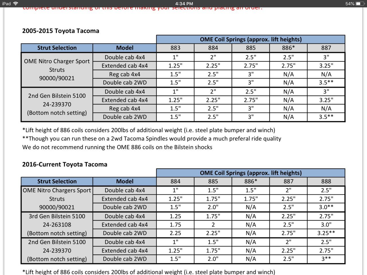

    for the last year my truck has been on 5100's and 886 coils but according to the chart it's a N/A. Dose anyone know why?

    5100s are lifting shocks, 886s are lifting coils. Since internal shock rebound valving being overworked, the spring rate causes premature failure of the shock. There are few threads around TW about it.

    Specifically the 886 coils are 660 lb/in., while the 885, 887, 888 coils are 590 lb/in.: https://www.headstrongoffroad.com/store/p250/Old_Man_Emu_Lift_Coils_-__Various_Lift_Heights_Available_(PAIR).html
    They are all lifting coils, but 886 achieves it with a stiffer rate, while the other ones do it by being longer. OME probably figured the Bilstein 5100 won't provide enough damping with the stiffer rate.

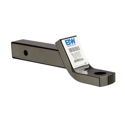

    Though i do have a question that just popped into mind. Say i have a hitch that rust-welded itself into the receiver, if i remove the tow ball from the hitch itself and run a bow shackle through where the ball mounts to, would this still be relatively ok?
    I know these exists (i have one from Smitty built);
    but talking more about this;
    i feel like it's a bad idea as the pin from the bow shackle is far too small to fit into the hole. as the loading of it will tweak the entire thing on an angle and the edges of the hitch itself will dig/ cut into the bow shackle weakening it

    886’s are technically not good for the bullies. It’s too much spring for them.
