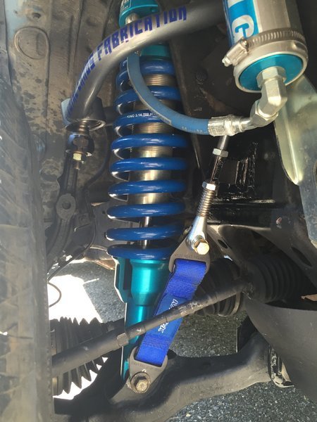

    Limit straps?

    Yup.
    Something like this:
    part of my diff blowing up was my cv popping out because of too much droop. So going to limit the down travel so it doesn’t happen again.

    Yeah. Going to be using stuff from tmr customs which is pretty local. Just have to wait to install my shocks so I can measure for limit straps.

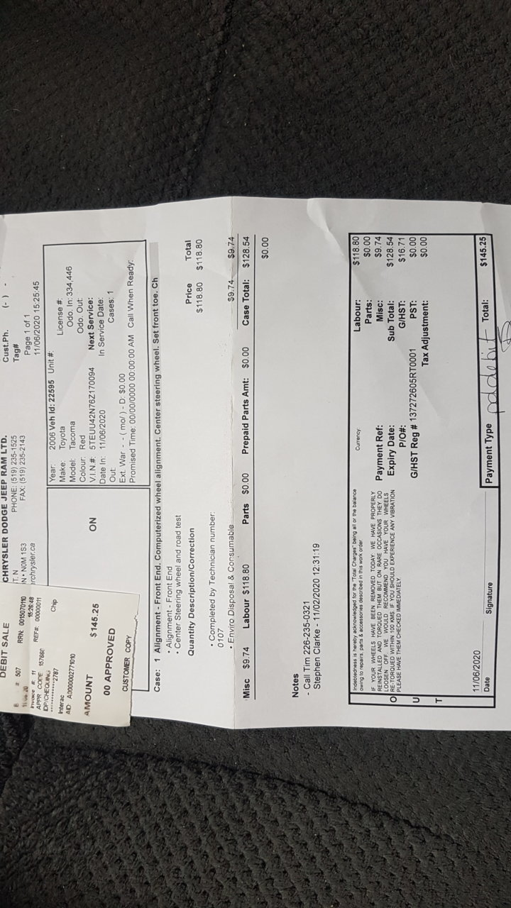

    Do you have a printout from your last alignment shop visit? Maybe there's some thrust angle from the rear axle.
    Also make sure you check pulling on a road with no road crown.

    No unfortunately. They claim that they deleted it. I have the bill. $145.25 and it just lists a front end alignment. 20210207_121941.jpg

    I went back twice and asked them to check it again and was told that it was well within spec. They just lost my buisness over a simple $145. My wife bought her intrepid, Durango and both challengers from them. Idk how much they make on the sale of a new car but they lost the chance to sell us another one

    It's possible for the alignment to be in spec (i.e. OK for tire wear) but still pull slightly at higher speeds. That's why the printout is helpful.
    As you know there isn't any adjustment on the rear suspension to correct for thrust angle. However, the tech can bias the front toe to compensate for it.
    With 330,000 kms on the truck, make sure the ball joints and control arm bushings don't have play.
