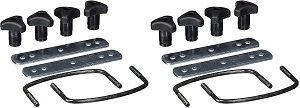

    Do you guys know if any other clamps under 50$ per set that i can use for the recovery boards?

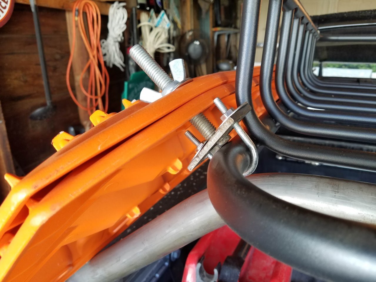

    I don't have a roof rack but I mounted mine in the bed with 15mm threaded rod and wing nuts

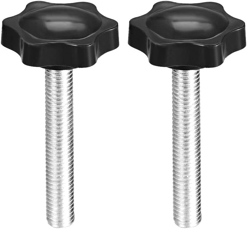

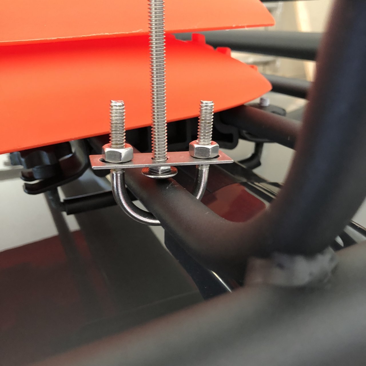

    you can get your hands on some cheaper u-bolts for like $3 and drill a hole into the middle of it and add in a 6" threaded rod and a wing nut like this; https://www.canadiantire.ca/en/pdp/hillman-zinc-plated-u-bolt-with-nuts-0611952p.html#srp
    you can find a 1" fender washer here; https://www.canadiantire.ca/en/pdp/hillman-fender-washers-stainless-steel-1611760p.html#srp
    the above is basically how my rear pod lights are mounted to the backrack but i used 2" sqaure ubolts and doubled up on the nuts (the pandemic hit and heading nylon lock washers wasn't easy so i never did it. I might just grab a set now since the stores are open)
    Wing nut can be replaced with nobs like this from Amazoom.
    IMO i'd use a rivnut tool (i have one) and set one into the cross plate of the U-bolt and use of one the threaded handle screws liek this;
    https://www.amazon.ca/uxcell®-Clamping-Screw-Shaped-Thread/dp/B07NVLMG8X?ref_=Oct_s9_apbd_otopr_hd_bw_bDir5jH&pf_rd_r=0NE1R7CAXKT3V17382DD&pf_rd_p=cf0a7d23-8772-5c34-92a3-802ac2ae7d85&pf_rd_s=merchandised-search-10&pf_rd_t=BROWSE&pf_rd_i=12572539011&th=1
    that way, when you remove the max tracks for storage, you can leave the U-bolts behind and it'll be flush with the truck. but might be a pain in the arse putting the tracks back on the truck since you need to line up the bolt
