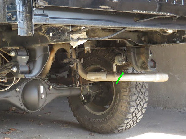

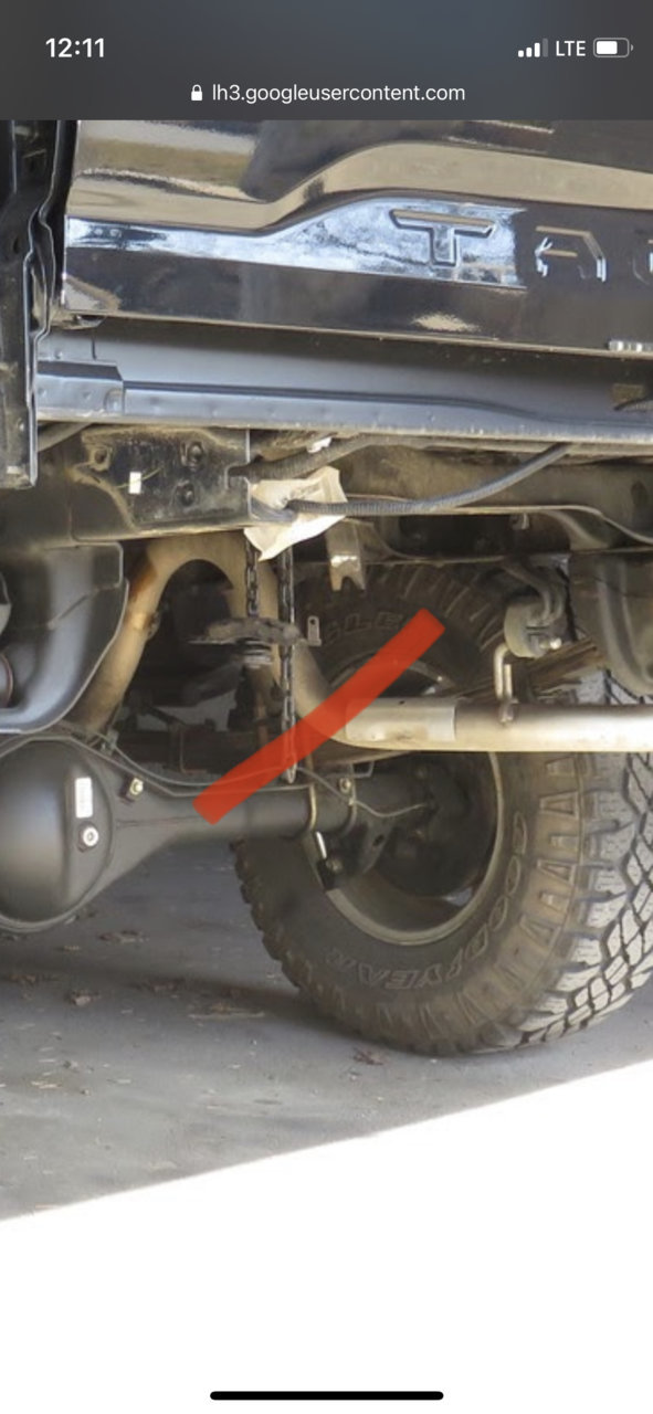

    Just cut it so it dumps over the axle. Don’t want the exhaust on the axle ideally.

    Probably at work.
    2014 Tacoma Crawler & 2008 Tacoma Daily
    Red line is the best spot
    Clears everything
    Sloweburn, tacoma16[OP] and Shveet like this.

    Just looked under mine. Dont see a red line. Must be a 3rd gen thing lmfao. Seriously...thanks

    No problem.
    I should mention i don't keep my spare under the bed at all so if you are planning to keep it under there it might be best to cut it off half way through the next bend so it directs the exhaust away from the tire.
    i also don't recommend leaving your spare under the bed when (or if) you plan on wheeling
    Just something to consider if you plan on keeping your spare stowed under the bed

    I plan to cut mine here, to keep the support of the last exhaust hanger:
    XQbOikxnG9e0fqhNTQkc_yjh4d2n3Q2f6gDjA7iI_456fba79efc74af9c9fdee0984b50ffc64c649f6.jpg
    All the hits off-road over the past few years had been on the tip - you can even see a dent where the pipe was pushed into the leaf shackle hanger. I can always cut the pipe back at the axle later, but there will be a lot of unsupported length.
