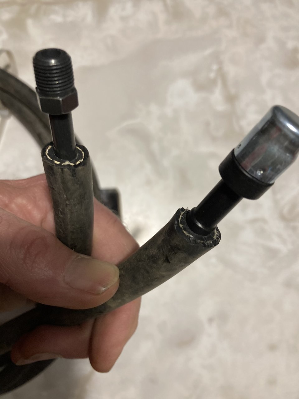

    That is a great point and i did not pay attention to diameter. Just found some heavy duty 1/2 inch Hose in my garage, not sure what it’s from but it says 350 psi working load. It will fit the union perfectly but I may have to trim down the flange on the vent nipple or ream out the hose a bit to make it work.

    As long as it fits and seals you’re fine.

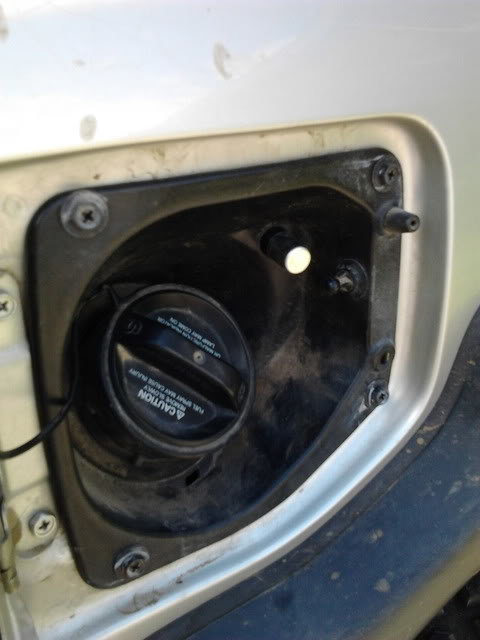

    Putting mine in the fuel door like the 1st Gen pic below.
    I think you have more options such as cubby hole in your bed or tailight area?

    I bought the same union and vent like a month ago, went into the store when things we're still open and my dumb ass got 1/4" hose...way too big now I keep forgetting to get a new hose

    Take a heat gun to the hose. Once its been warmed up it might expand enough for you to be able to insert the vent without reaming out the hose.

    That’s a great tip, thank you. I think I will file down the flange on the nipple combined with heat to slip the vent in the hose.
