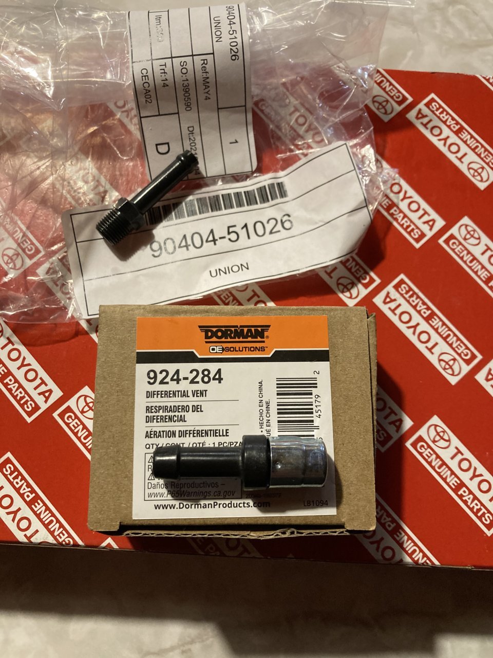

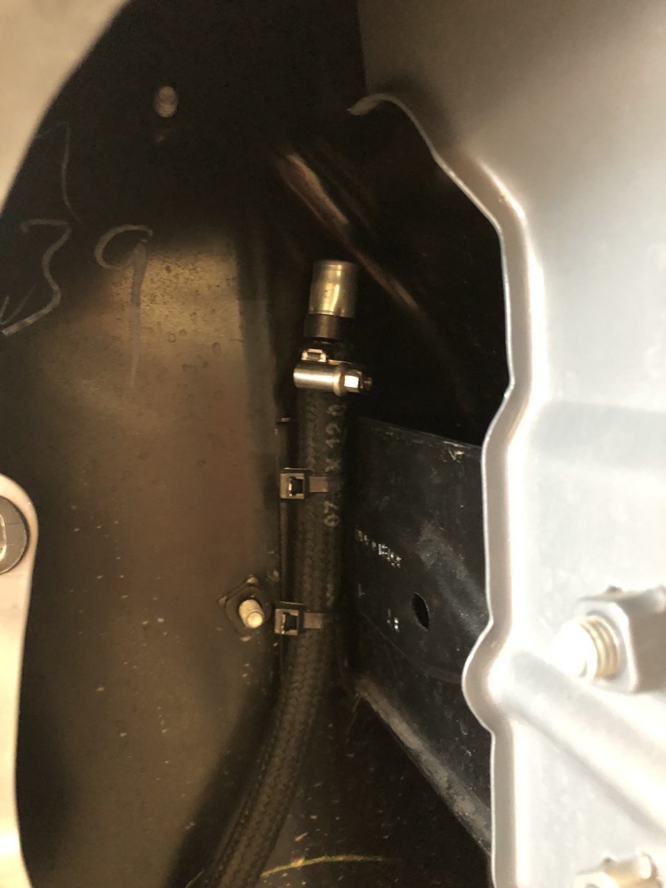

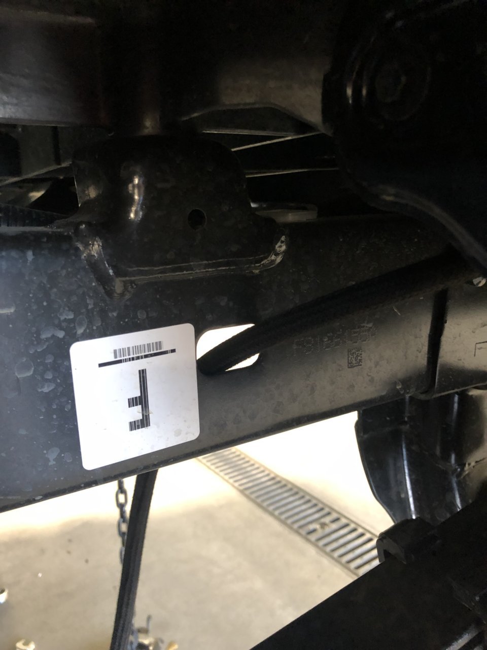

    These are the stock factory breathers for my front differential and ADD I believe…

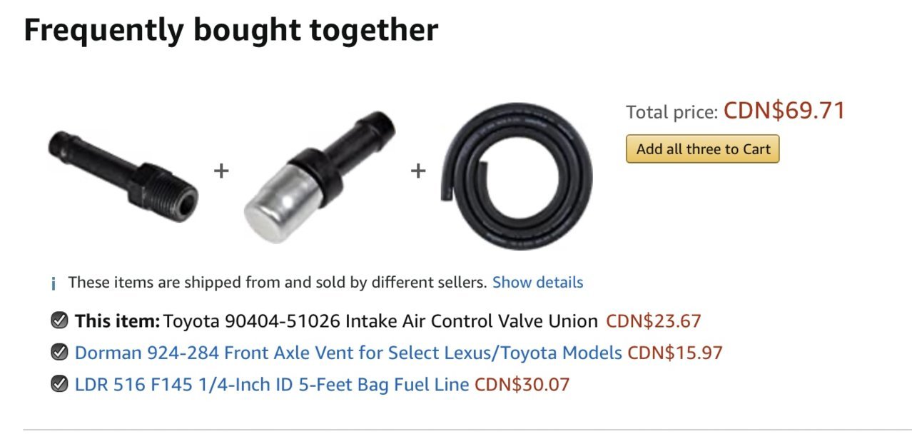

    I got mine ordered...had to get the larger diameter union from T.O. ...what size hose do I need again?

    Looks like 5/16 inch ID

    That’s where I ended up running mine, followed the frame then up behind the left tail lamp. Was the very first mod I did on the truck

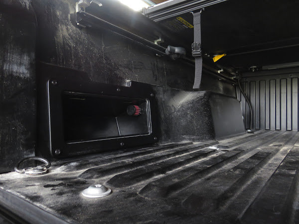

    I ran mine to the driver's side cubby in the bed. Figure I can access easily if I ever need to.

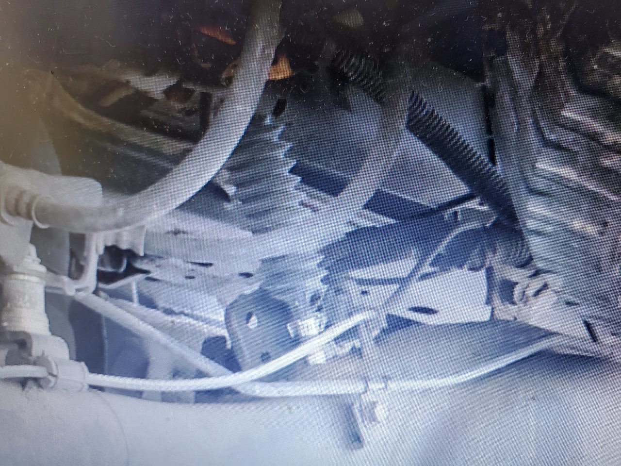

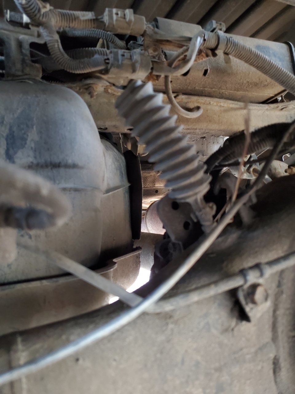

    I just use this. But then again I'm different

    The bellows-style breather doesn't work well according to these reports:
    https://www.tacomaworld.com/threads...-for-dummies-pics.15686/page-43#post-15998844
    https://board.marlincrawler.com/index.php?topic=74409.0
    https://forum.ih8mud.com/threads/axle-breather-creeper-breather.341422/
    Ran some rough calculations earlier: The diff oil (and therefore the air in the diff housing) can reach over 100C. Assuming the air starts at -10C (easily reached in Canadian winters), then the volume expansion is 373/263-1 = 42%. Rear diff oil capacity is 2.95L. Since the fill plug is about half-way up the housing, we can estimate about the same amount of air is in there. That means the bellows would have to expand by 2.95x42% = 1.24L to avoid pressurizing the diff housing. Clearly the part is too small to do that.
    Atlas86, llamasmurf and somebody like this.
