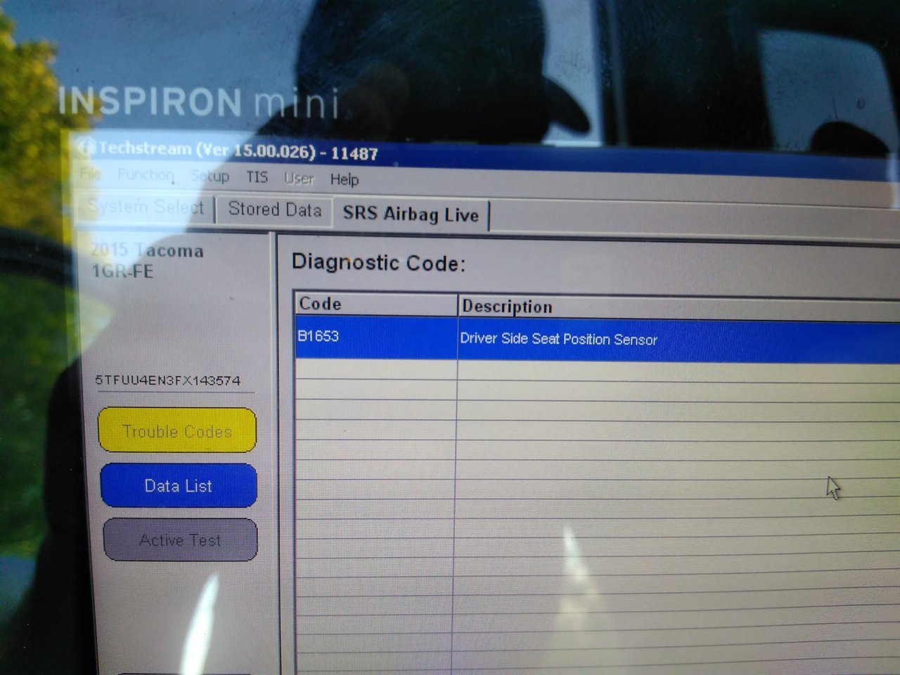

    My buddy wasn't around today for him to hook up his scanner to my truck. Getting my vaccine Wednesday so hopefully get it looked at then

    What would cause the sensor to malfunction?

    I was thinking the same thing. What causes that one to fail, its inside the cab and such.... We will pull it out and see whats up, order a new one if needed.

    I believe I have the same issue, my horn works fine but my airbag light is on. Haven't scanned it yet though. I think I might have messed something up by storing something under the seat.

    Could also be damaged wiring (only 2 wires) between that sensor and the airbag ECU. Does your copy of TechStream have live data? You may be able to have the parameter displayed in real-time while you move the seat fore and aft to see if the sensor output changes.
    Did you remove the driver's seat during the twin-stick conversion?

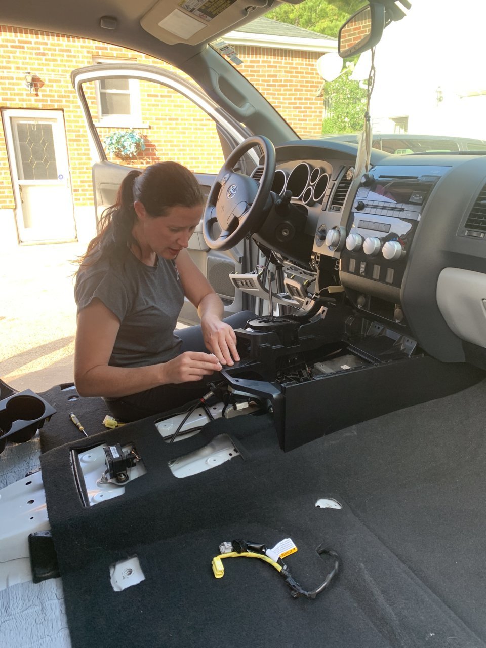

    You better buy her some weathertechs or husky liners for that hot rod Tundra!
    That is totally awesome that she took that project on by herself.

    No, we did not remove the seat for twin stick's. Just the entire center console area around the shifter.
    I do believe my Techstream does live data, so I will test it out and see what it says. :evil:
    I should have checked before we replaced the clockspring, and actually documented the error codes. Which of course I did not. :goingcrazy:
    Jeremiah thinks I had 2 codes before, 1 clock spring, 1 position sensor. Now just 1 code.
