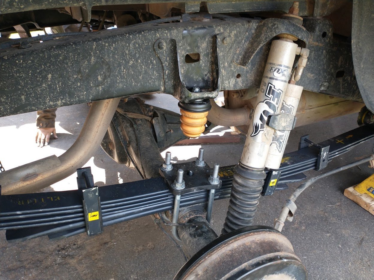

    i run GM bumpstops off of a '99 to '07 Silverado.
    https://www.tacomaworld.com/threads/fox-2-0-deavers-1-5-aal-and-gm-bump-stops.289215/
    @tacoma16 and i run them. stupid simple to replace and every store from Crappy Tire to Part source to the GM dealership - can get you a set of these if they ever do blow out on you.
    there are 4 or 5 washers that are being used as a shim, could simple not add those in if you need it closer.
