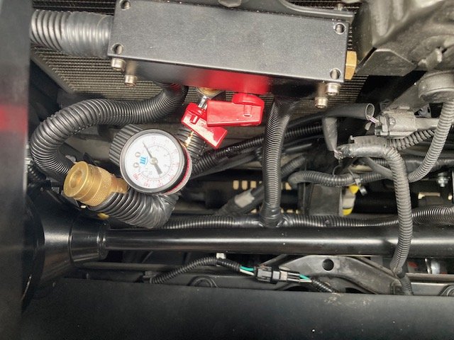

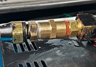

    Check valve installed, 'cause some azzhole had a good idea.
    Installed the pressure regulator and air chuck, covered all the air lines in front with split loom, to make it look more "factory".
    I think I'm going to have to paint the shut off valves handles black, to stealth them in a little more...
    Now to male / find a cover for the air chuck so it does not collect crap. And make a fancy hose so I can air up multiple tires at the same time.
    You know laziness.
    Took about 3 minutes to inflate one tire from 15 to 35 Psi, so that's pretty good.
    The regulator slows the last bit of filling down quite a bit, as it it set to 35 psi, but will be handy for just connect and forget.
    Water test showed no bubbles,
    and tank pressure gauge has not budged in the past few hows so I think everything is fine.
    Just need to paint the fittings on the top of the compressor and the main cooling line and it should be all "stealthed" in.
    Will add another solenoid for the drain soon. And the multiple pressure sensors for the brown pants selector.

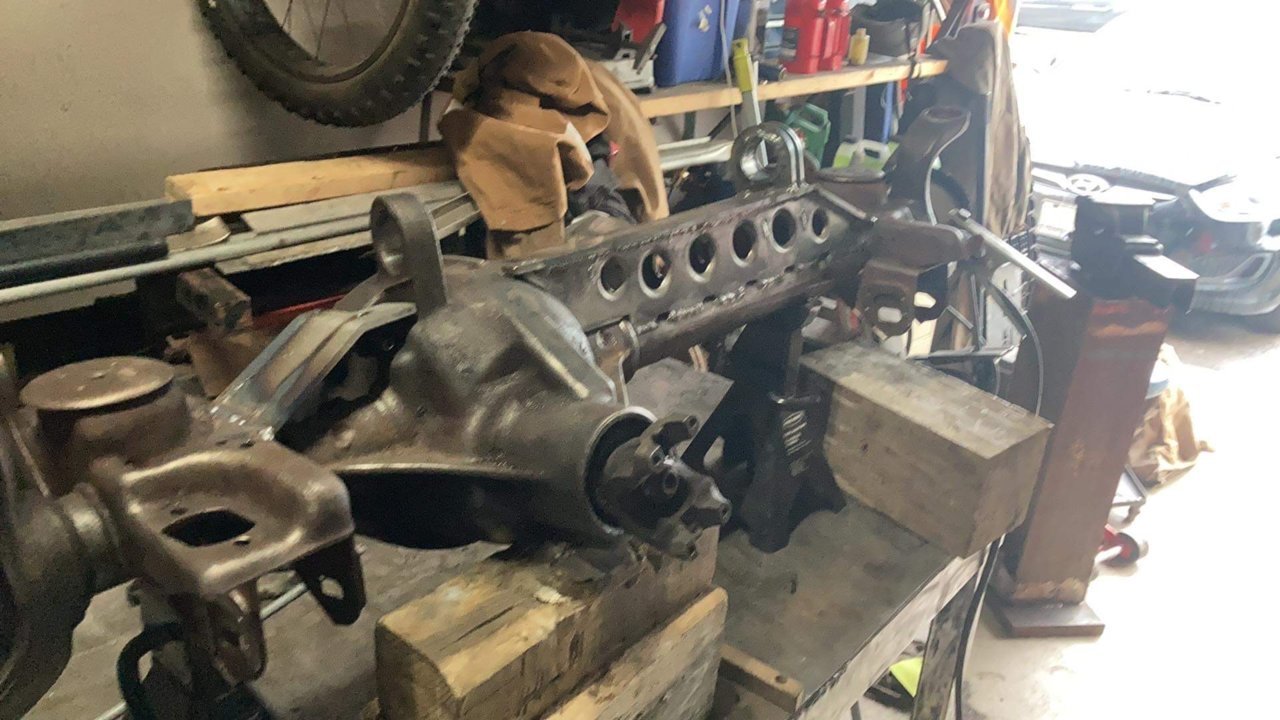

    Looks awesome @daks
    since I’m waiting on replacement bushings for my upper control arms with less then 3k kms on them I just worked on some other stuff….

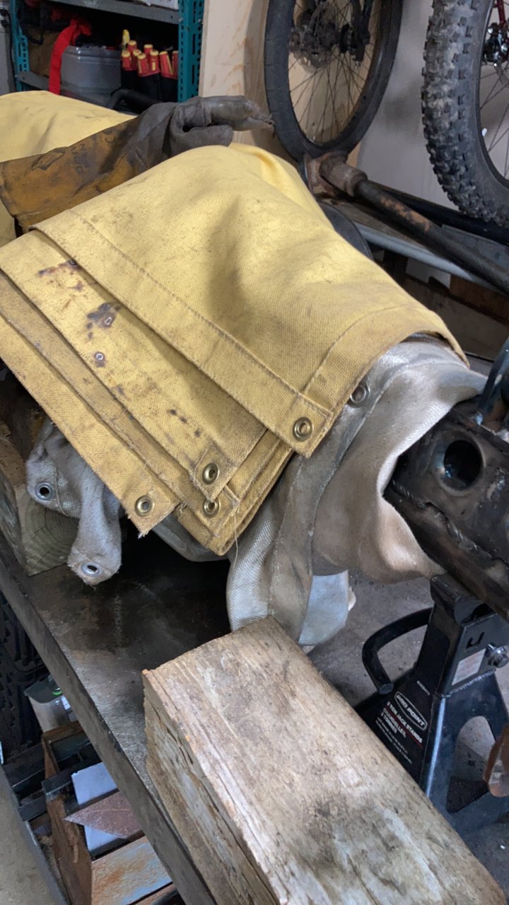

    After pre heating to 400f I did my welding and wrapped the axle up in a welding blanket. Did this extremely slow. Heat and weld the axle tube on one side, wrap and let cool. Then re-heat and weld the truss to the pumpkin on one side, wrap and let cool.
    Tomorrow I do it again but on the other side.

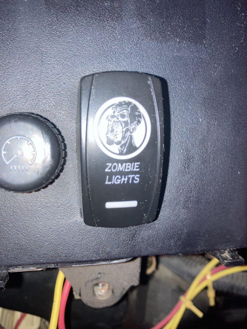

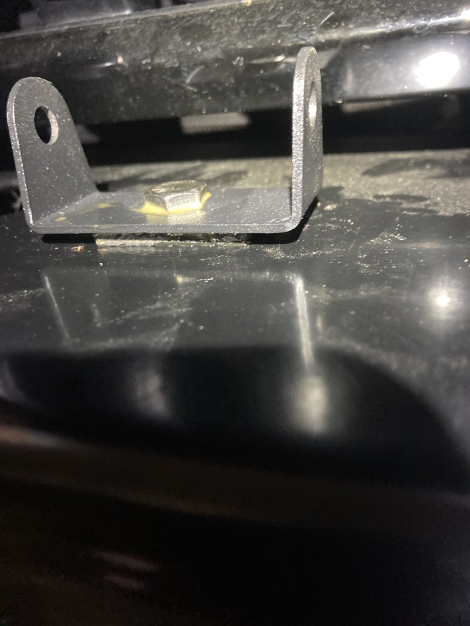

    I finally got started on mounting my el-cheapo Amazon ditch/deer lights.I ran my first ever relay and got a switch flush mounted in the rear locker blank (cuz I don’t have one). A little bit of trimming was involved.
    Light brackets are all covered in fluid film with a nice chunk of rubber between the bumper and bracket to protect the powder coat. The pre-drilled winch holes on the Arb were handy in the right spots.
