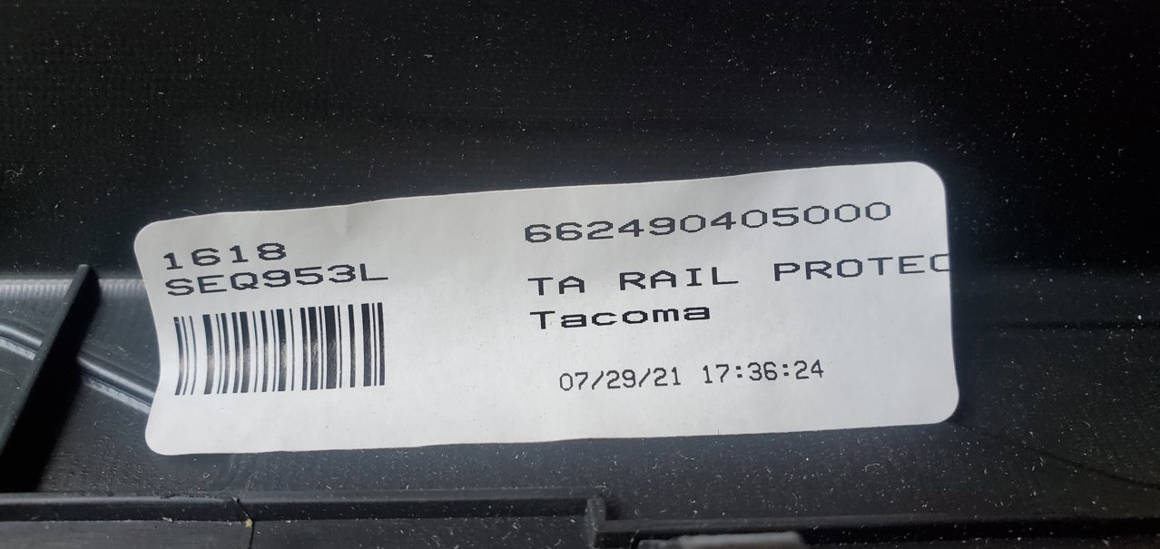

    long bed or short? I could use short bed rail covers
  10. Sep 29, 2021 at 8:34 AM
    Tacocomamama
    Tacocomamama Success sometimes may be defined as a disaster
    Aug 25, 2021
    #375222
    128
    Mississauga, Ontario
    2021 Tacoma TRD Off-Road
    They are for the short bed!
