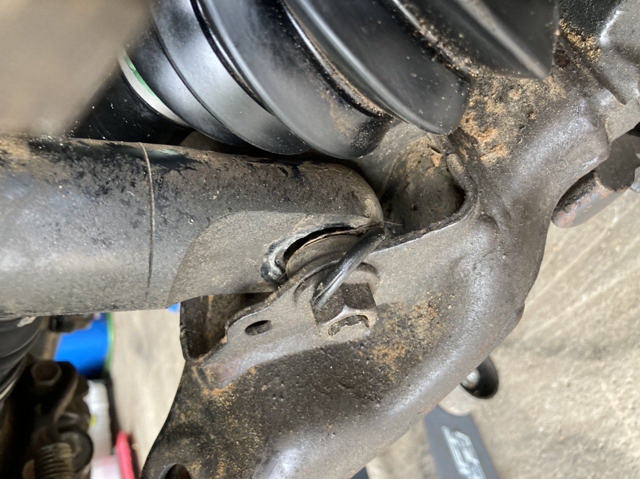

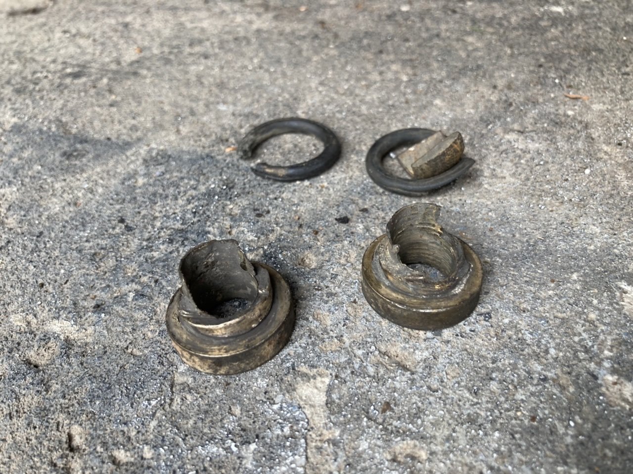

    Well, season closed for me. Elkas shocks lasted under 2 years only… Parts availability? 2023…

    Cracked Windshield
    :eek: under warranty??

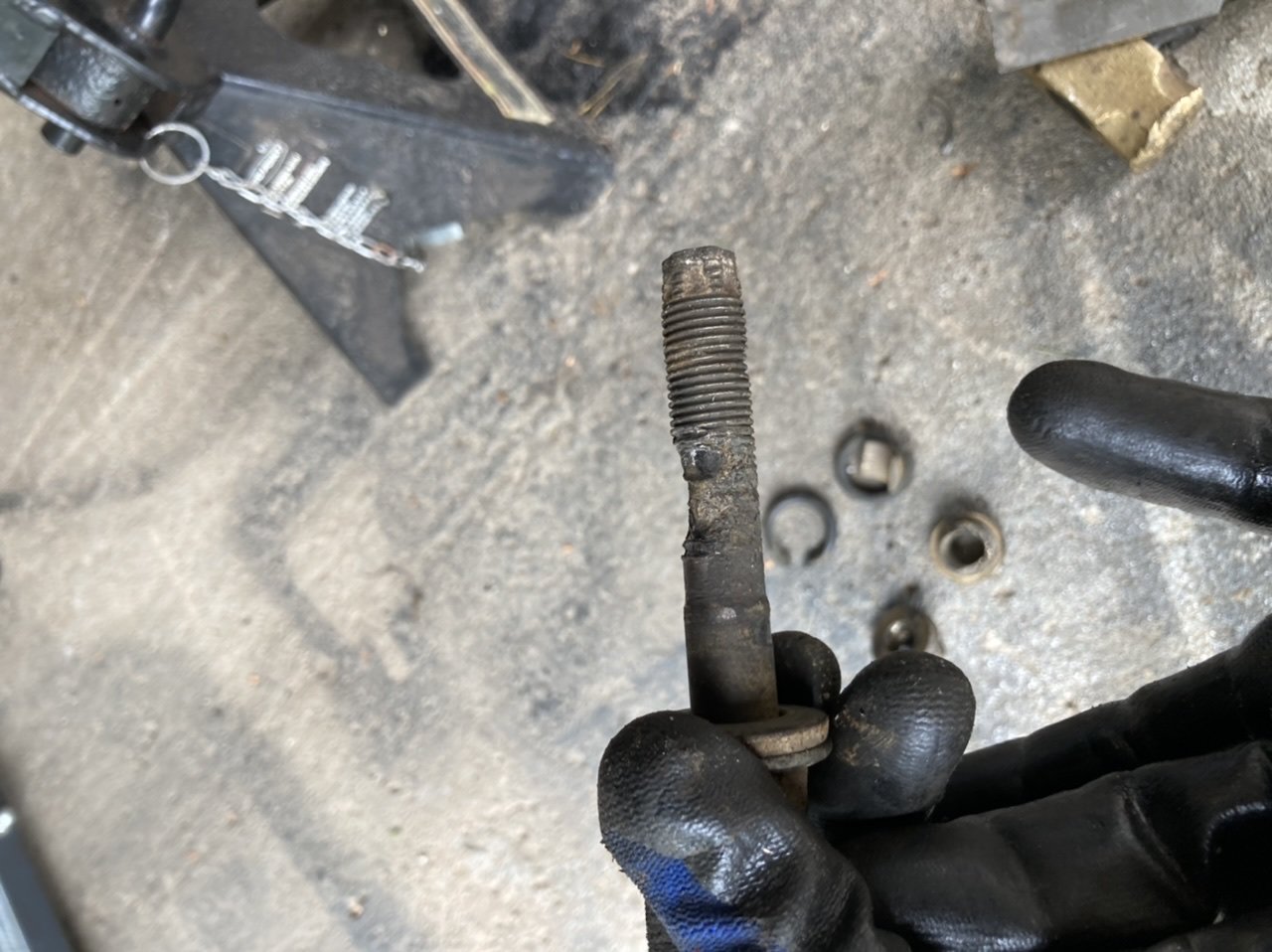

    What's the bore size of the heim bearing? Try to measure it, even though the sphere portion got split in half :laugh: If it's 5/8" (0.625 in.) (COM-10T bearing) like Icon, then there's a service kit widely available: . 4WP carries it, too, but with 3-wk lead time: https://www.4wheelparts.ca/p/icon-v...ver-bearing-spacer-kit-611067/_/R-FRDK-611067
    I had to order this kit because my reducer bushing sheared off inside the heim bearing. My fault for installing the bolt backwards (so the weight was resting on the reduced-diameter porton of the bolt shank).
