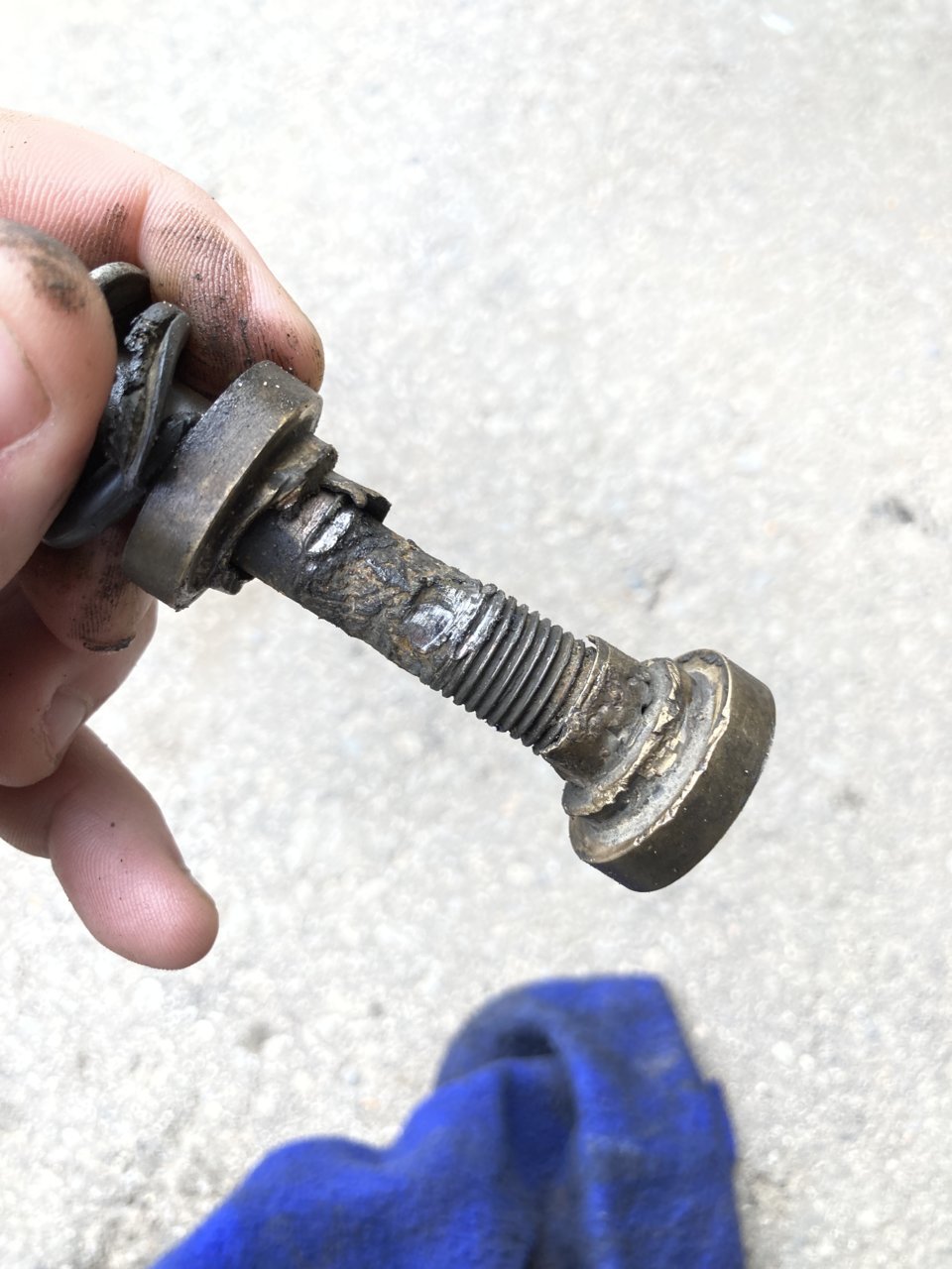

    I believe it’s different hard to measure what’s left… The lower shaft got grinded off as well, may be a dud, only way to find ou is to install new repair kit…

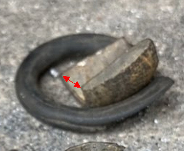

    You should be able to measure this. Even better if you still have both halves of the sphere:
    It's difficult to find metric heim bearings in North America, so most mfrs go next American size up from 14mm to 5/8" (which is 15.9mm), then use shoulder bushings to bridge the gap.

    The other half is MIA that’s why the bolt is missing most of the threads:anonymous:
    but I’ll try to measure what’s left

    Looks like the bolt backed out, which is the cause of it all.

    Most likely the bushing cracked and caused bolt to back out over time, Krave mentioned they replace those a lot on Elkas. They are! :cool:

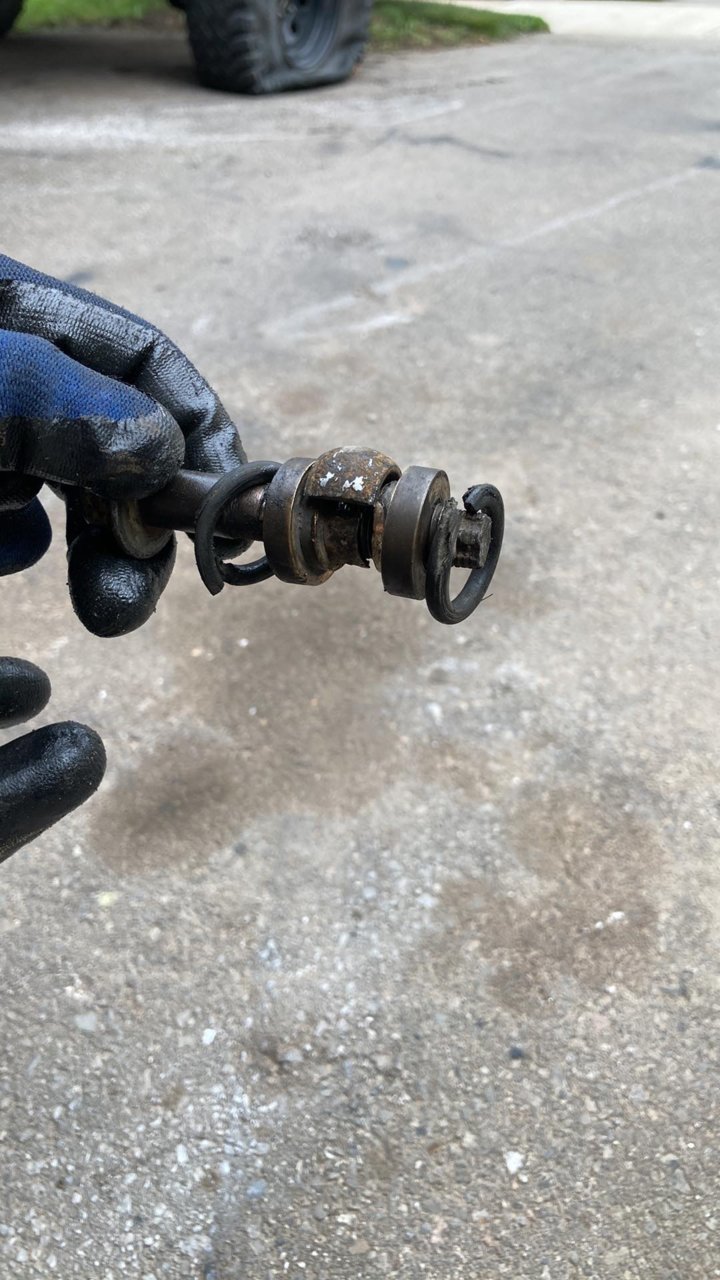

    Those things are high maintenance. For example, the front axle U-joints don't have needle bearings. Instead they are solid pins lubricated with just anti-seize to take maximum shock load. This means they need to be disassembled and repacked for each race weekend.

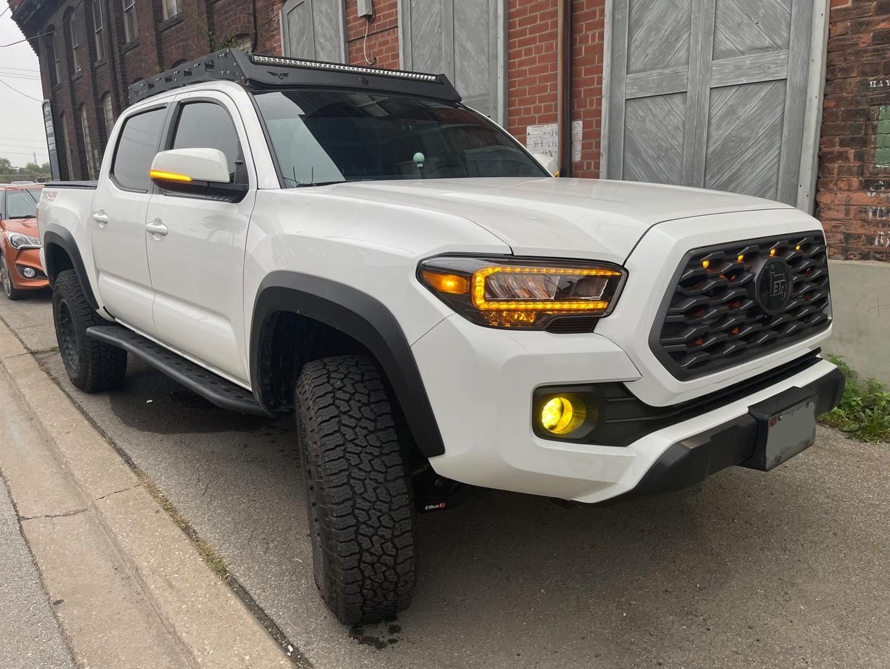

    New Alpharex TacomaBeast TRD Pro headlights installed :bikewheelie2:

    What fog lights are those?
    TacoPandaTRD[QUOTED] likes this.

    Diode Dynamic SS3

    Are they the Sports or Pros? How do you like them? I'd like to the DD ss3 amber fog pros when the Black Friday sales come up.

    They are Sport. They are incredibly bright. Very happy with them. I can only image how much better the Pro are but can’t justify the price. I actually just ordered another set of Sport for my ditch lights
