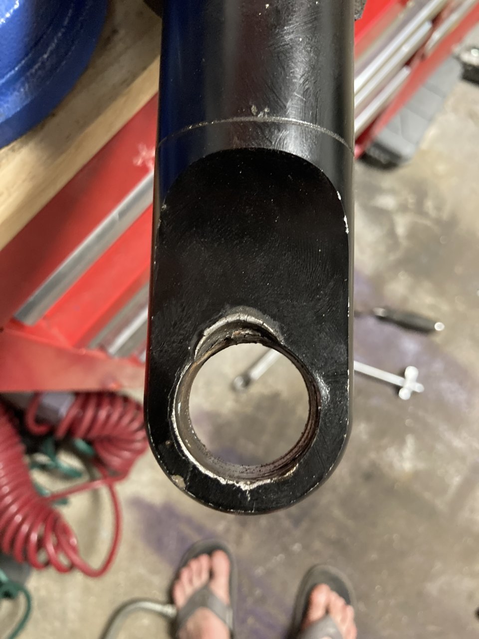

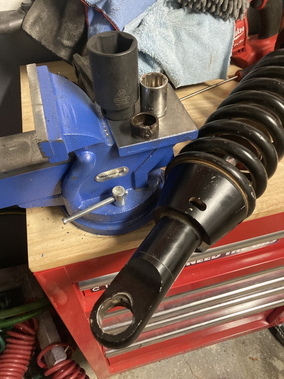

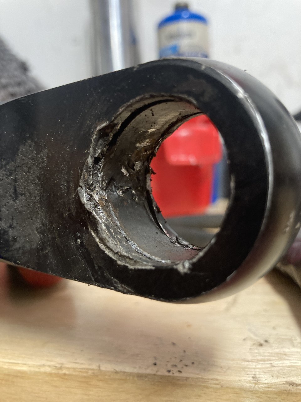

    Tools you’ll need
    35mm socket
    22mm socket
    Vice, princess auto one works okay
    :thumbsup:
    next who sells bearings locally? :anonymous:

    Problem there for the c clips :confused:
    pl glue the bearing? :anonymous:

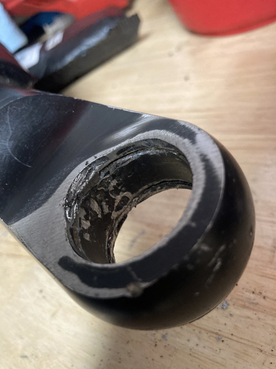

    Fuck man that hole looks gacked. Is it still round enough to just press a bearing in there?

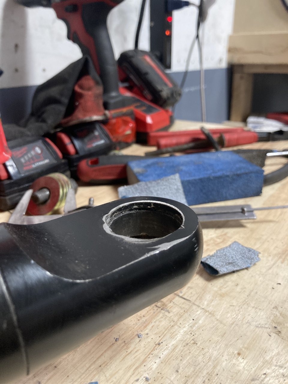

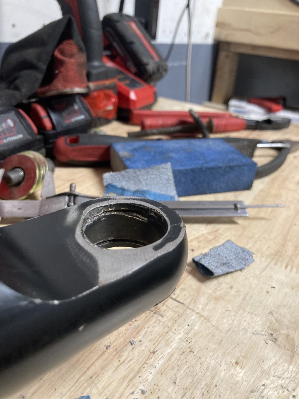

    A die grinder with a small cut off wheel will clean up the groove. File off the rough edges and a little JB Weld to fill in any missing aluminum then wait for a new bearing. The piece you took out will give you the OD and width. And there might be enough of the other parts to figure out an ID. Or take the other side apart. Then go to Canada Bearings or any other bearing supplier.

    Might be able to save it if you get a round file and a couple needle files and very carefully try to clean it up only taking the high spots off.

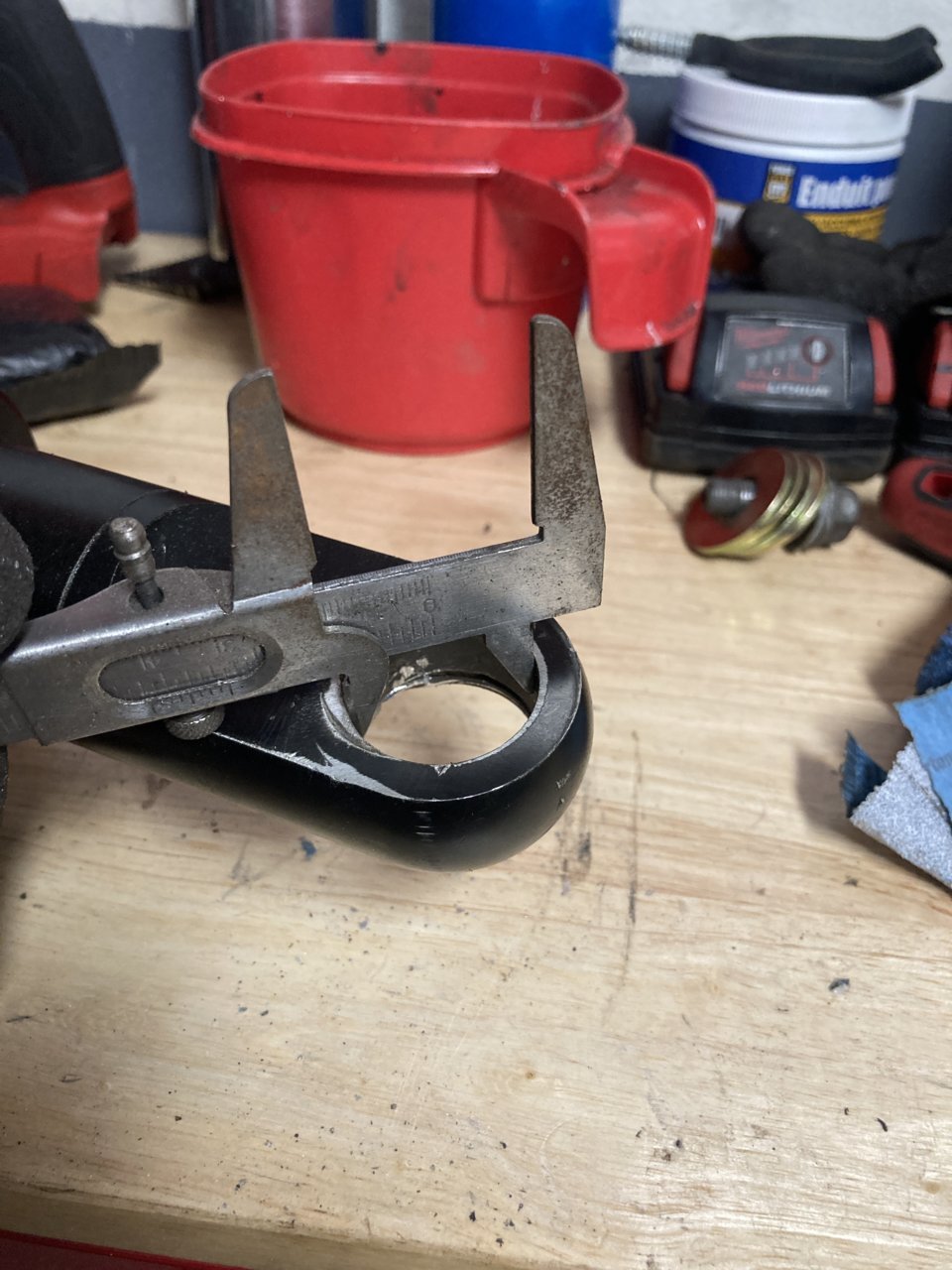

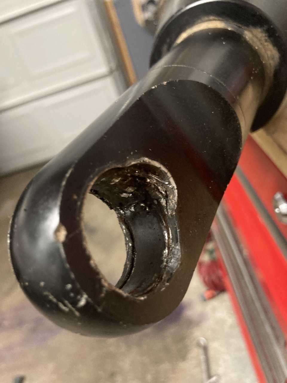

    Measuring with caliper all around s seems to be still round on both sides.
    :hattip:
    the only concern is this on the inside, sanded flush as much as possible, still working on it

    So on the inside, those marks are from the bearing exploding and dropping the pin right onto the lower shock body?

    Also what Russian pawn shop did you find that vernier at? :rofl:

    Your guess is wild as mine, something went boom.
    it was free, no questions asked:anonymous:
    For the Slav-Red-Neck-Chop-Shop-Fab-Penis-Peter-Fab this is high end :cool:

    Alright don't hack them up too bad. If you get the same size bearing just a bit of care with a round file will work. But if you need them bored out to fit a bit bigger of a bearing let me know.
    but for the love of god at least use @tacoma16 ‘s vernier. Or even just a measuing tape :p
