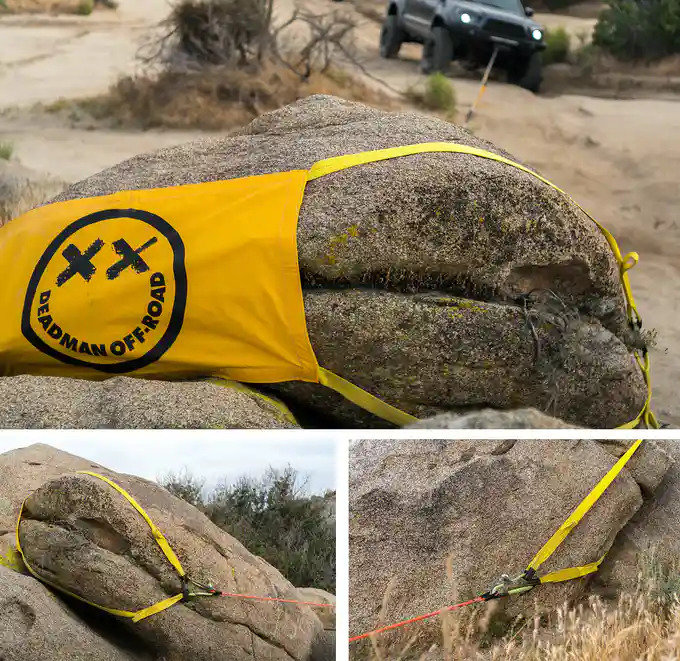

    alternatively a recovery blanket already exists, if you're able to wrap around the rock.
    but for a rock face itself...
    maybe add a recovery point at the center of the blanet, that way each arm can have an anchor bolt to itself and it distributes the loading.
    effectively creating this scenario;

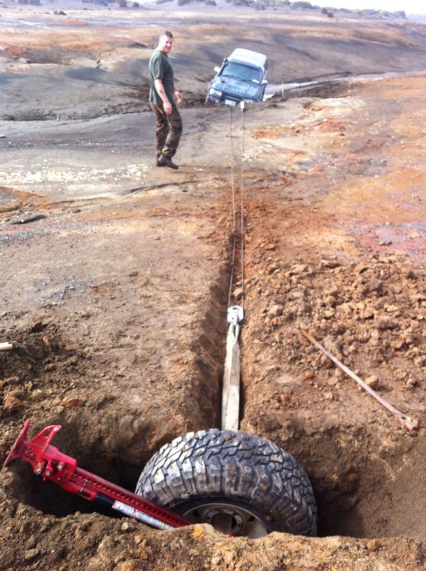

    edit; while searching for deadman anchros. i also found this;
    simple as jack hammering out a slot for the tire and a channel for the winch line!

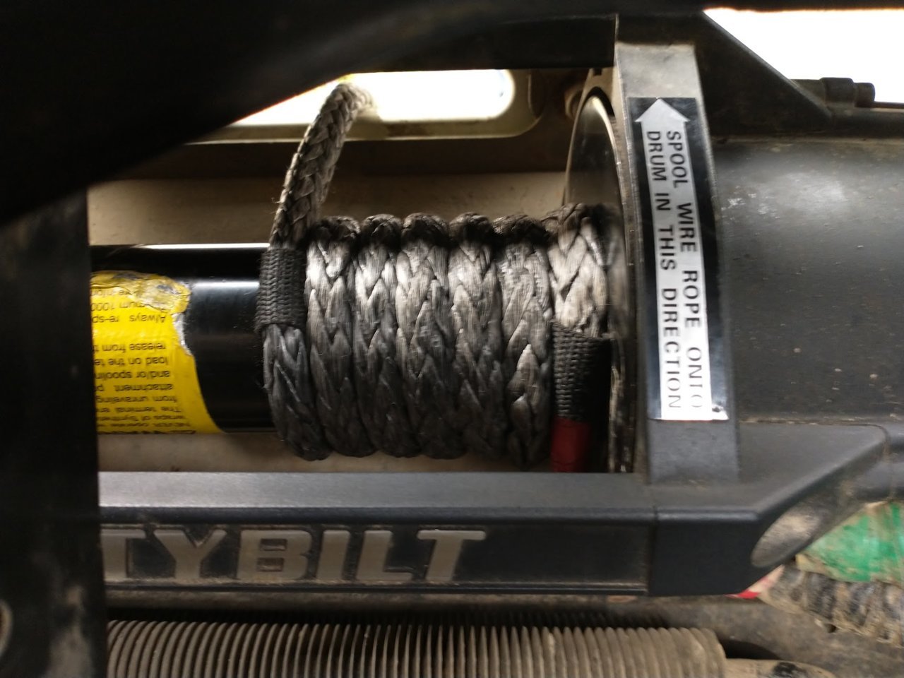

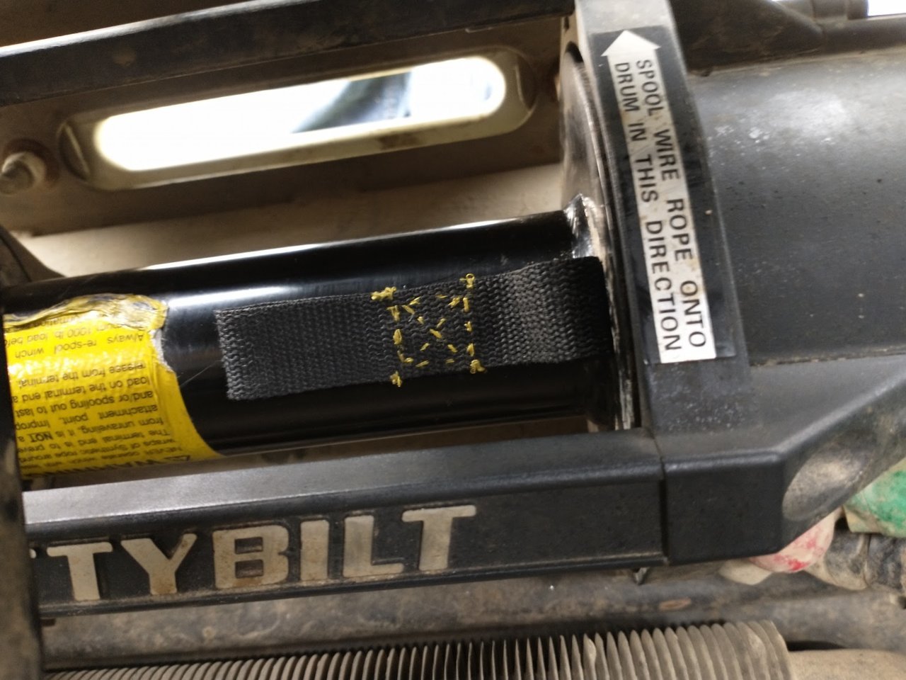

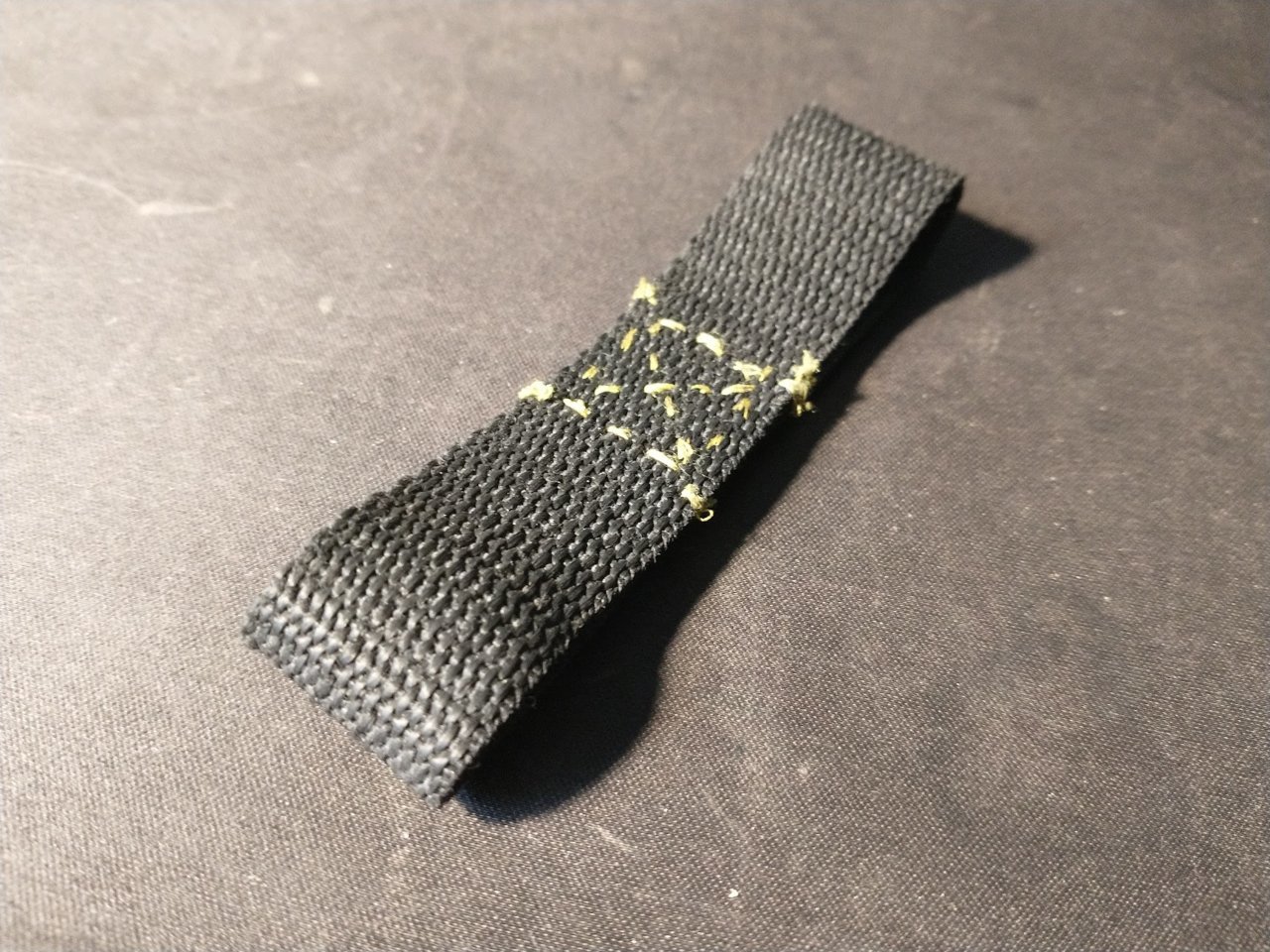

    man... with all this winch talk i've gone an build myself one of these.

    Is it bad that the tape fix we did on the trail is still what is holding my junk…..
    I need a sewing machine. What mode is that? Can sew heavy material apparently.
    Edit: upon closer inspection…..are those hand stitched?

    as the saying goes; nothing is more permanent than a temporary solution!
    yes, hand stitched :bananadead:. my Mum has one of the industrial sewing machines but fuck if i know how to figure that thing out. it's witchcraft to me.
    I figured there isn't much loading on the last 4 or 5 wraps since the end of the wrap is held on by a single bolt (which yanked out of the metal sleeve when i went to wash the winch line) and even then iirc the shittybilt manual says to do 10 unloaded wraps before putting a 1ton load to correctly tighten the winch line.
    should be fiiiiiiiiiiiine.
    what's the worst that can happen?

    yeah exactly you’ll be fine. I think I did actually go back and figure out a knot instead of tape. Non the less no more load then the bolt/lug will take anyways.
