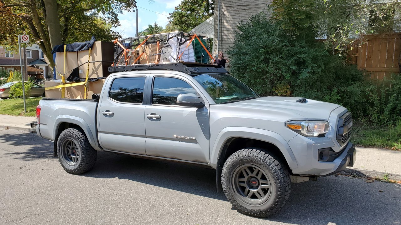

    I might be going this route as well, if you come across any good deals around, please share. I'm going to get new leaf springs as well so part of me is thinking it might be worth shipping to Buffalo even if it means getting a PCR test.
    Wasn't planning on a lift just yet but my front tire picked up a piece of something sitting in the Gardiner off ramp/Lakeshore, it bounced off my rocker seam, nicked a tire and flattened a rear shock. Shock was "ok" for about a week and then I came out after work and there was a puddle of oil under it. Tire still holds air but it's in the sidewall and through the cord, I think its time for 33". Oh well, could be worse, at least it's Black Friday soon

    Yeah that's no bueno. The shock piston can't move past the pinch point.
    TRDCal[QUOTED] likes this.

    Yah, it happened about a month ago *just* before my move...luckily it was a short move cause it was a rough ride! Unloaded it rides ok
