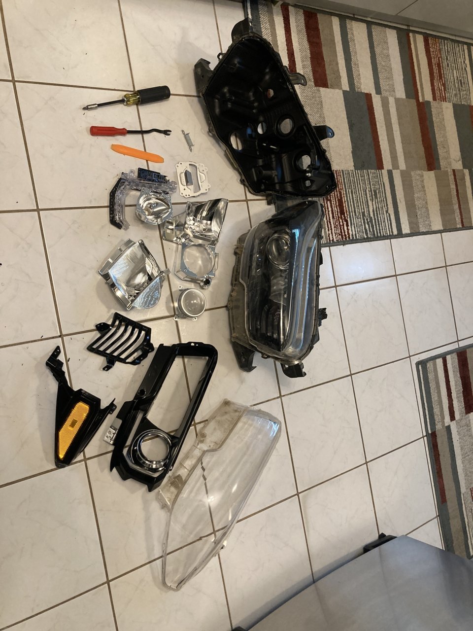

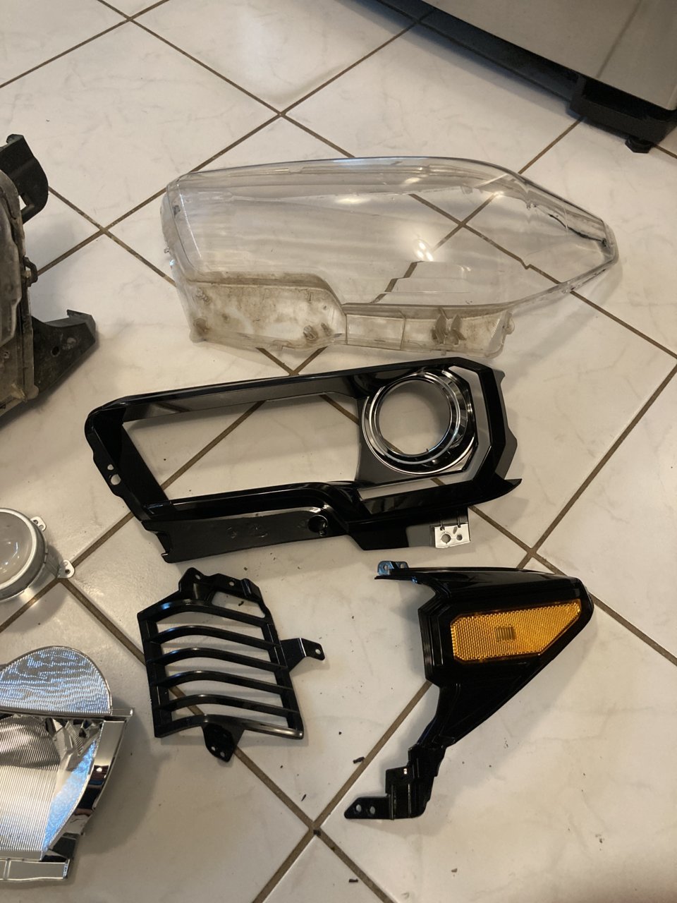

    Some interesting findings on oem pro lights QC, both sides have similar marks.
    Unless those were sold to me as “pro” lol

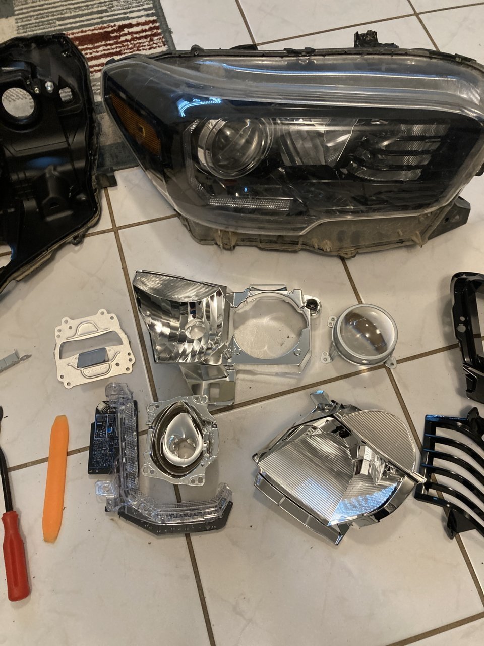

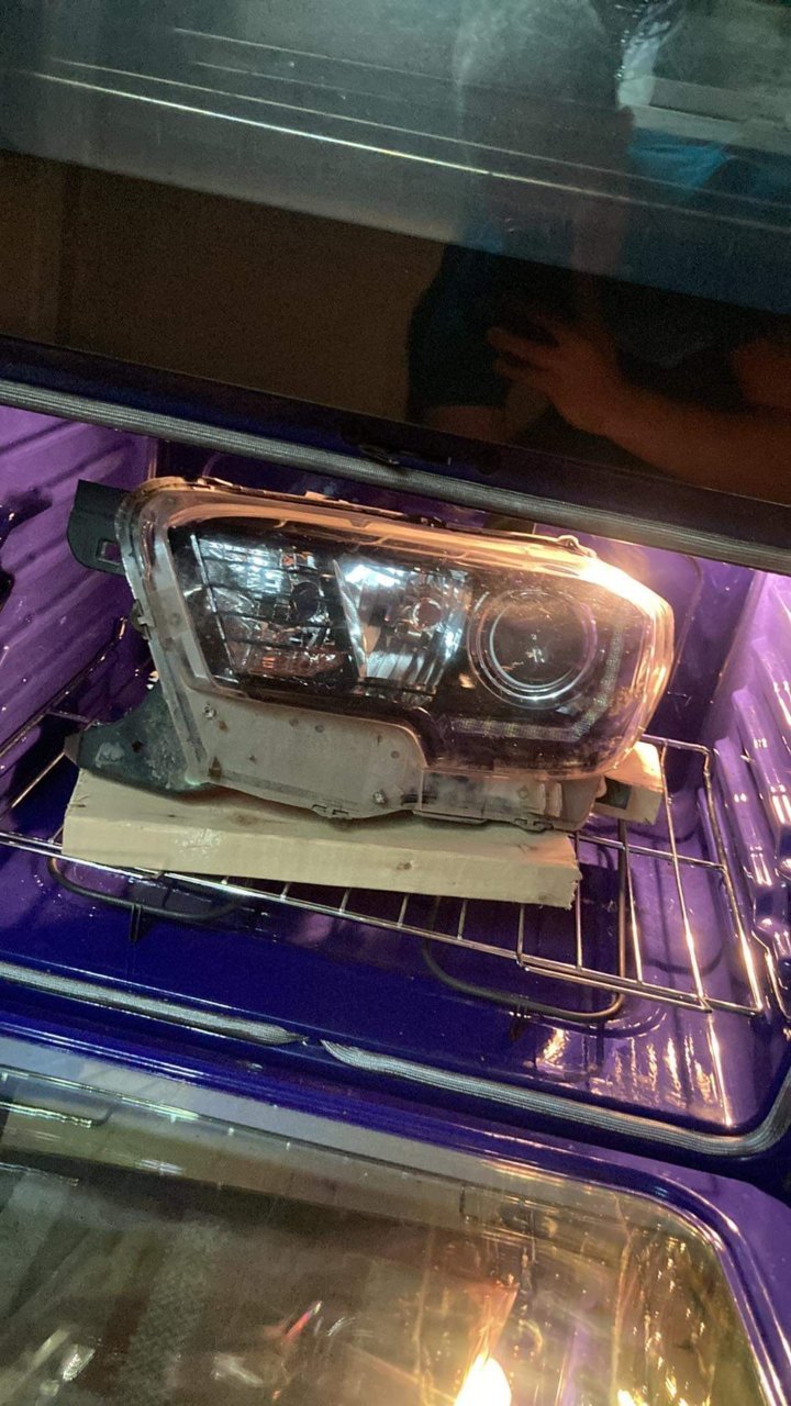

    And done, very easy do it at 150C for 25 minutes and few screws after on the inside.

    Don’t go past 150C :anonymous: I wanted to speed up and went full send to 240 for 5 minutes all internal parts survived tho

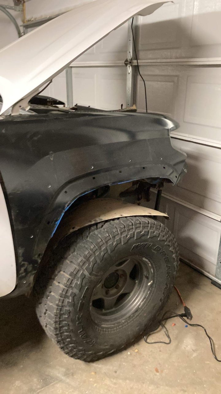

    Well… I tripped over the jig saw cord that got stuck inside of the fender after I accidentally activated grinder while reaching for the dremel just so I can use it to trim some minor things.
