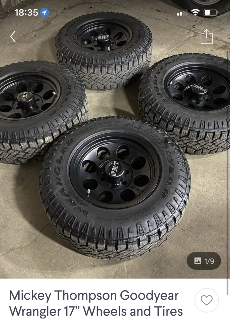

    Does anyone know if these classic iiis fit a third gen OR?
    I’ve searched through what seems like every page of TW and google and can’t seem to come up with an answer. I saw someone say they might not fit over the calliper?
    the rims are 17x9 and tires are 265/70/17

    Should be these:
    SIZE — 17X9
    BOLT CIR. — 6X5.5
    BACK SPACE IN. — 4.5
    OFFSET MM — -12
    HUB BORE MM. — 106.10
    MAX. LOAD LB. — 2,500
    APP. WT. LB. — 24
    REPL. CAP* — 90000001589
    MATL #. — 90000001796
    PART # — 2479412

    Should fit, bolt pattern and bore size look good to the truck specs. And @philth 16s also another confirmation they fit too.

    The only thing I would recommend to check is the lug bolts, some wheel require cone or ball seat style. This may result in vibration when driving.

    -12mm offset? They will cause the 32" tires to rub on the fender plastic.

    heat gun will solve this
