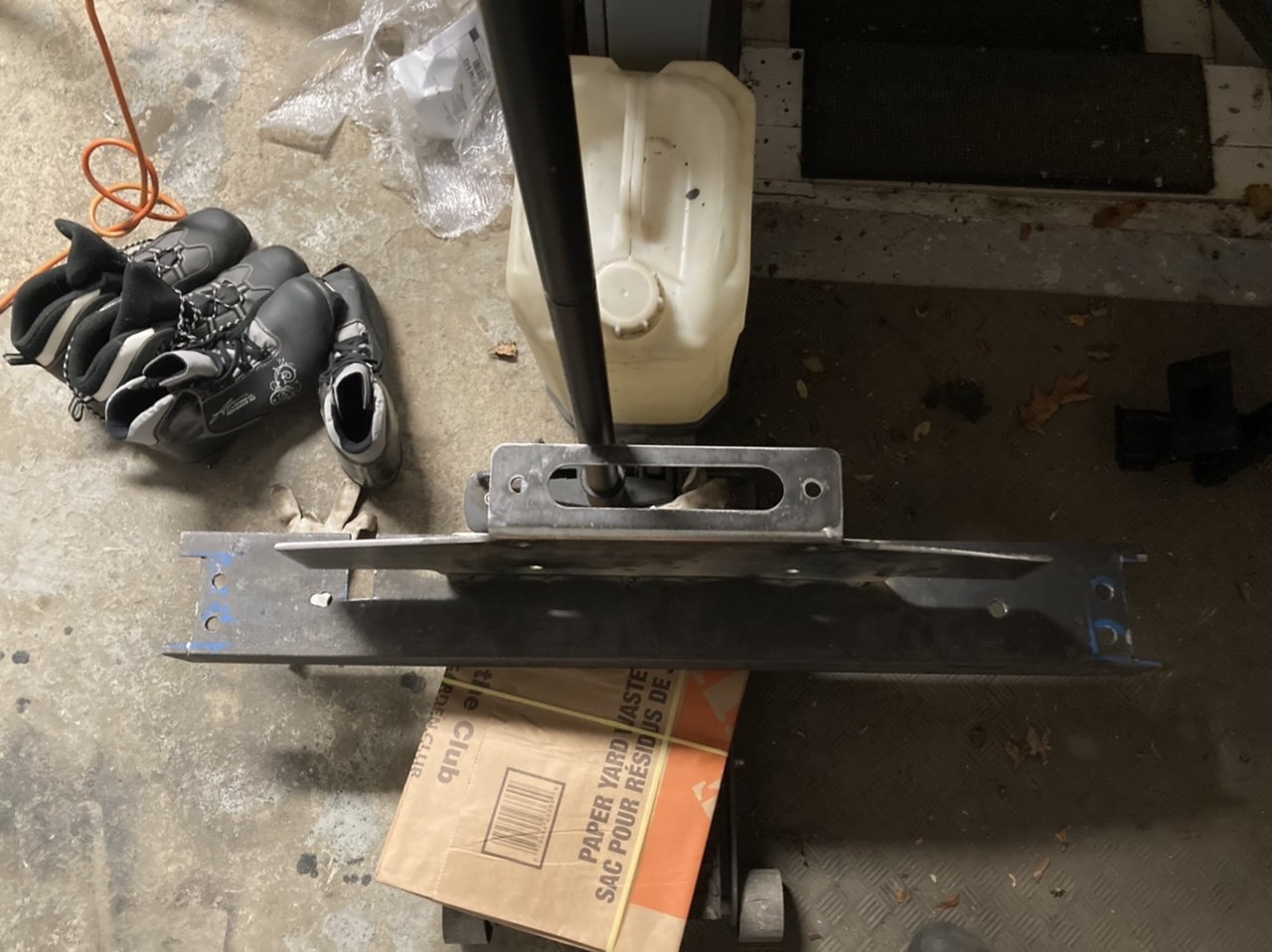

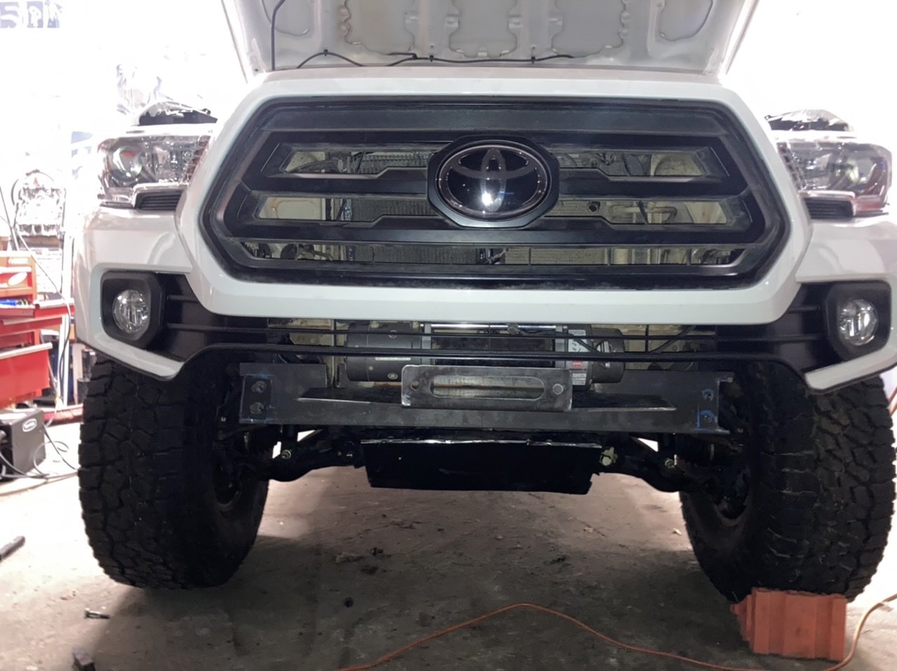

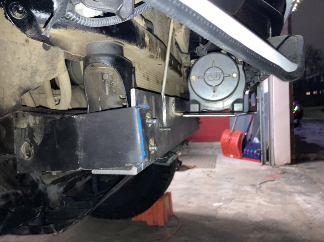

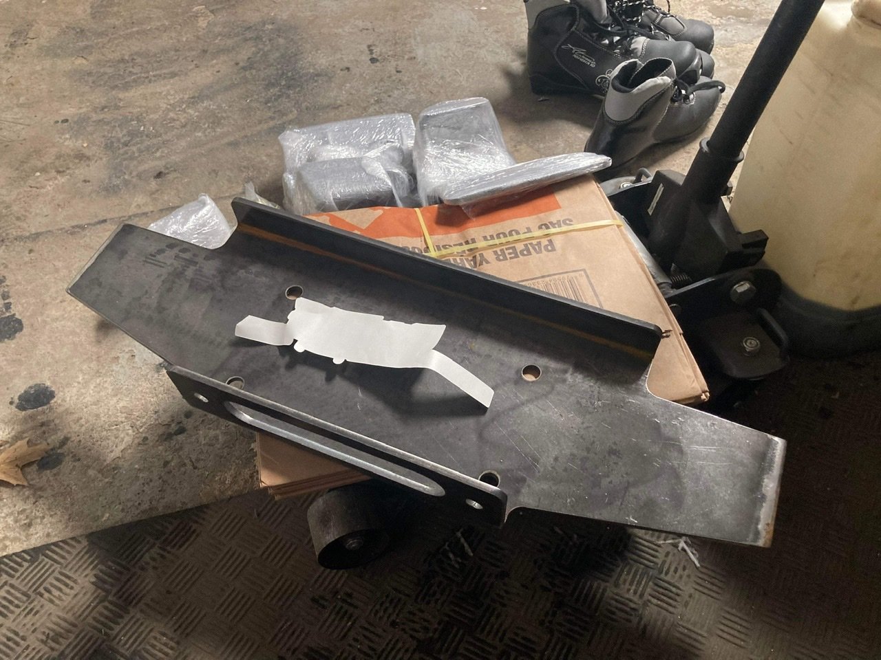

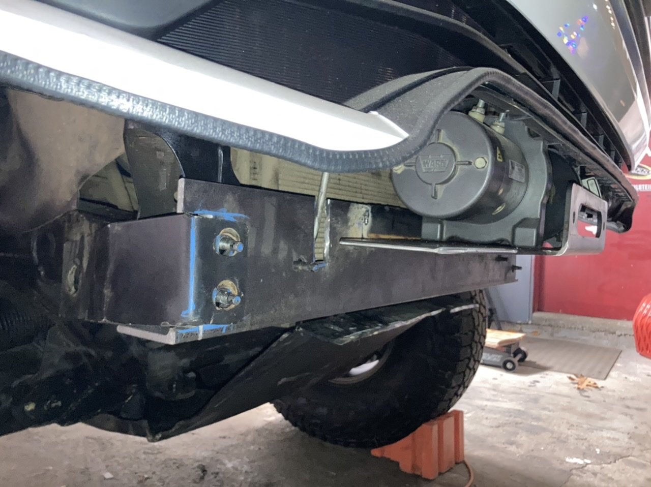

    So turns out Canadian English is different from the UAssOfA :oldglory:(or maybe I can’t type, I did attach image of what I wanted tho…:evil:), anyways still good price for the winch plate, let’s go with blaming Americans since it’s easier.:canada:
    Got the winch plate as shown below
    One piece of 3x5x40 inches of 1/4 angle iron, drill some holes that poorly align because front frame is twisted and nothing is even anymore, a bit of hammering, a bit of tack welding and measuring and bam:welder::sawzall:
    Mounts via the stock 3 crash bolts on each side, then on the bottom 17mm welded nut to the frame and bolt. After that, two side brackets bolt down the frame and are holding on each side.
    Next step is to add gussets, tow point and burn it in. @tacoma16 :boink:
    Thoughts and critique?

    With some gussets and tie ins as close to the frame bolts as possible it should be sturdy. Get those Tmr gussets. Thinking 4 on the bottom and maybe some on the top?
