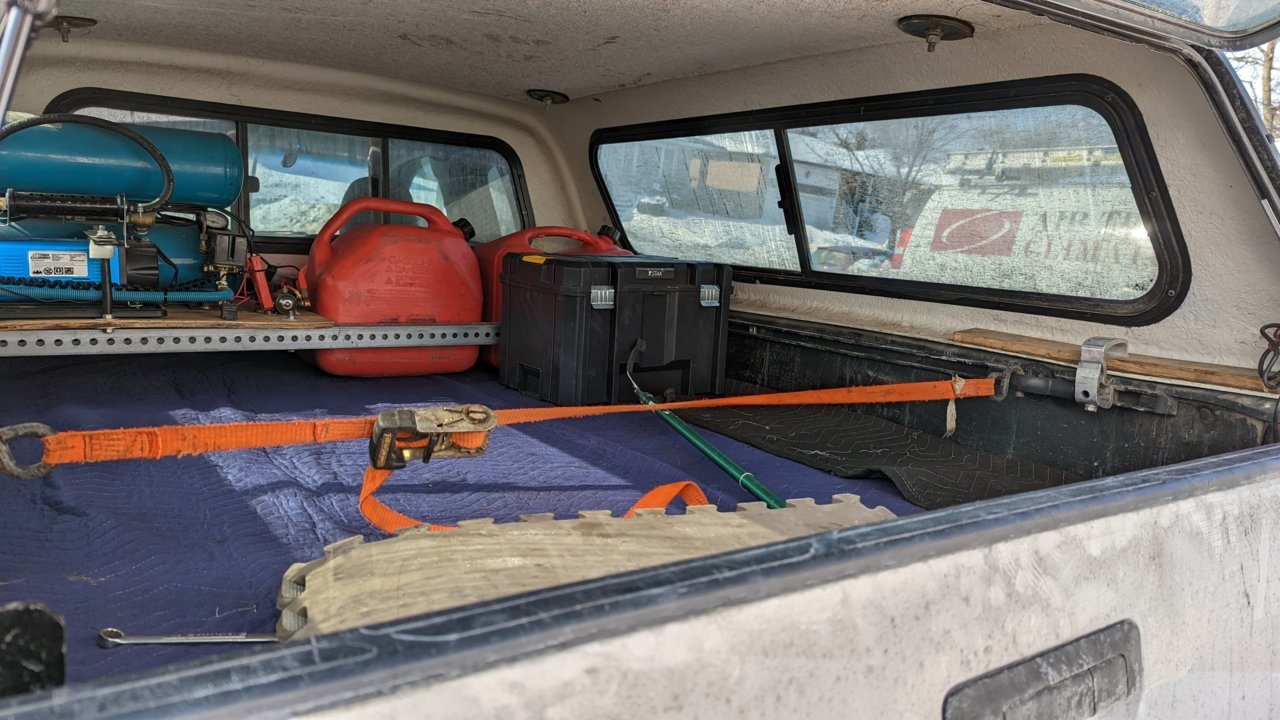

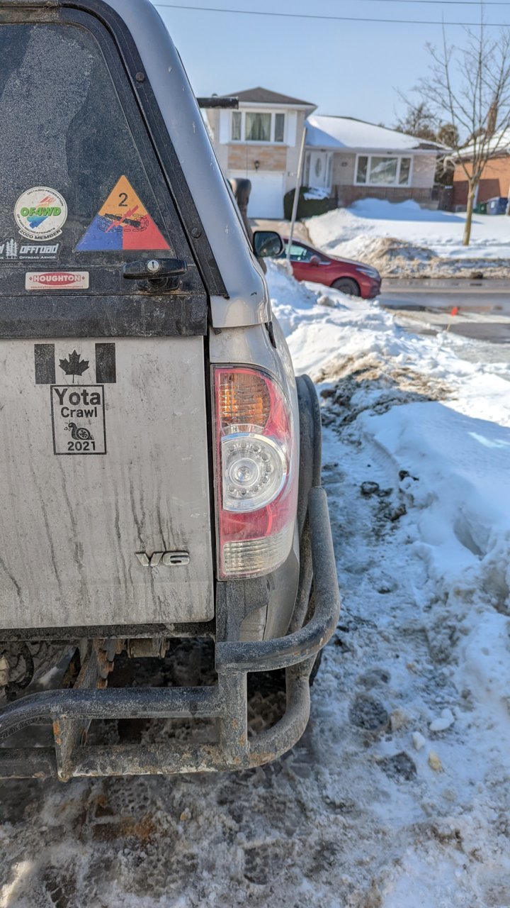

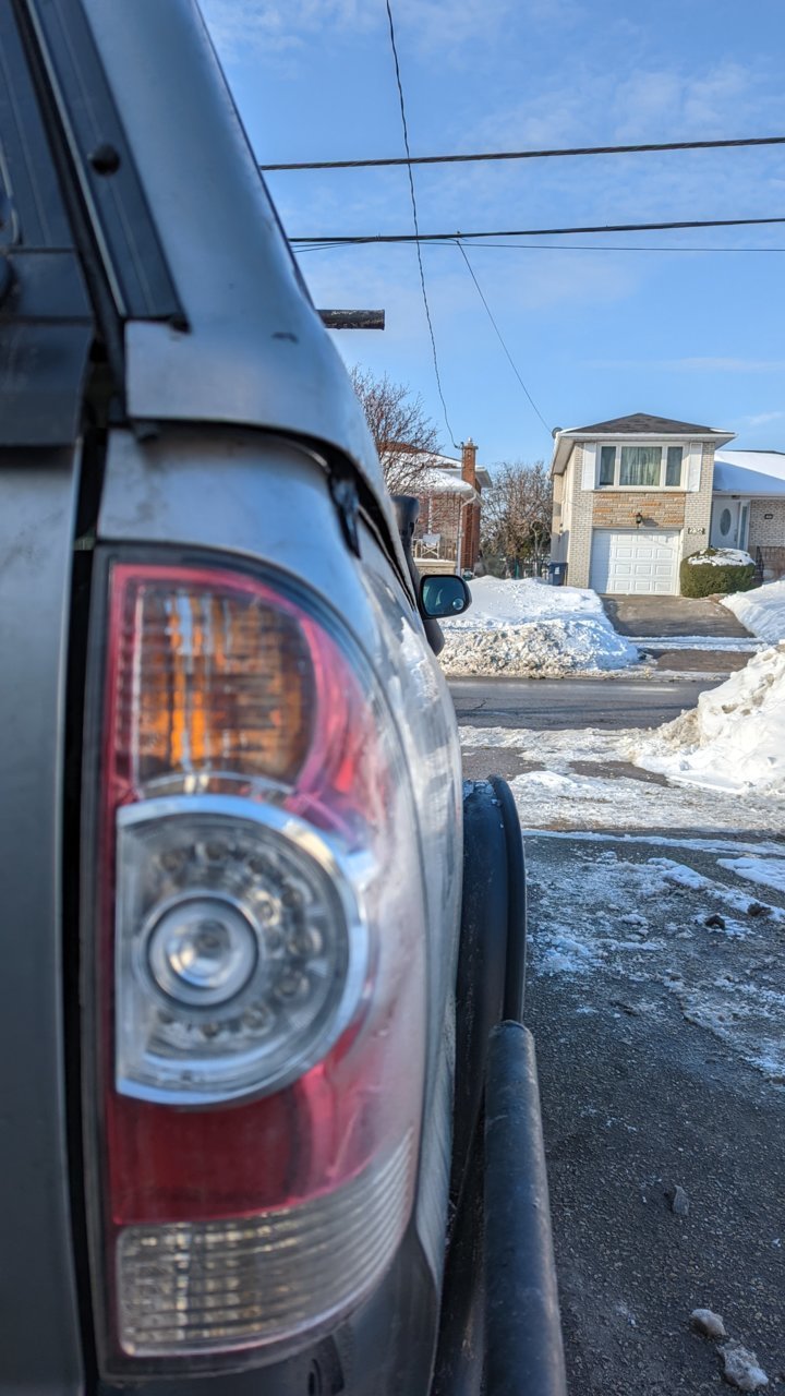

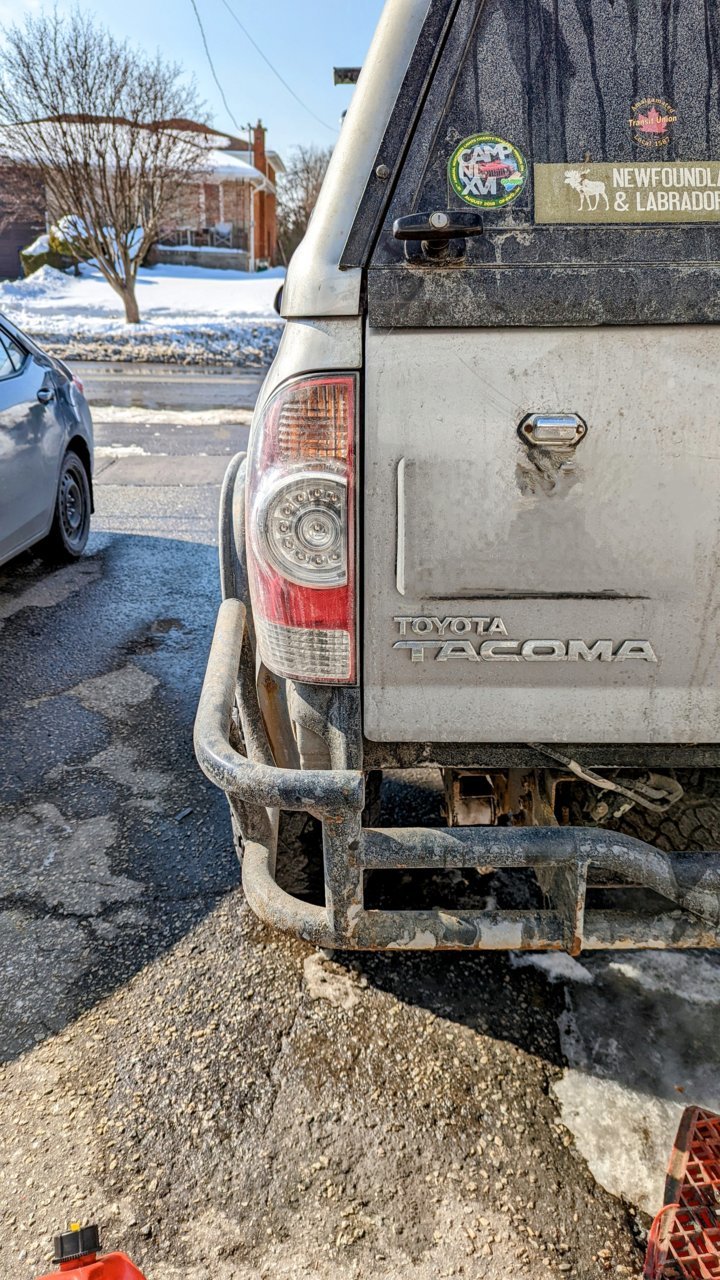

    Just until the bed stiffeners come in.

    Could the mounting clamp for the cap and the bed seen some movement?
    Ratchet strap will be perfect till the stiffeners come in.

    cross brace it with 2 rat-shit straps to the rear d-rings and *call it a day!
    *good enough for Hamilton!

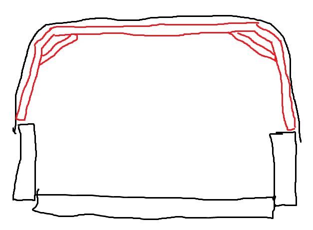

    The more I think about your gapped rear end I feel like the stiffeners are more of a half solution with the weight and flexibility of the cap. The cap has quite a mechanical advantage as it squats and shimmys side to side that it itself needs some stiffness (the bed stiffeners are still only working with insufficient metal to attach to). internal brace like this comes to mind. Could even be done with some Al channel and pop rivets.

    appreciate that and just let me say the rtt is on when I go wheeling and camping, though I only do dirt roads and no rocks or bumps or heavy wheeling... :) ok some light wheeling..... I kinda get it that most of that is my fault.
    as I already have 4 holes drilled into the cap for the roof bars the bracing maybe a good Idea:thumbsup:

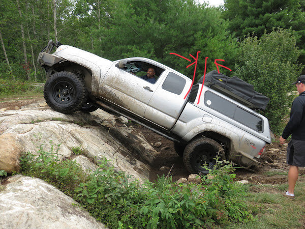

    Yep only light wheeling with the RTT on:
    ghNU8QYLvj2hpG4BFOYEykzp3_0gnh23hCUnOQ_5_2a895f2f843bfecc345b7af3eec8ad65c7fe1337.jpg

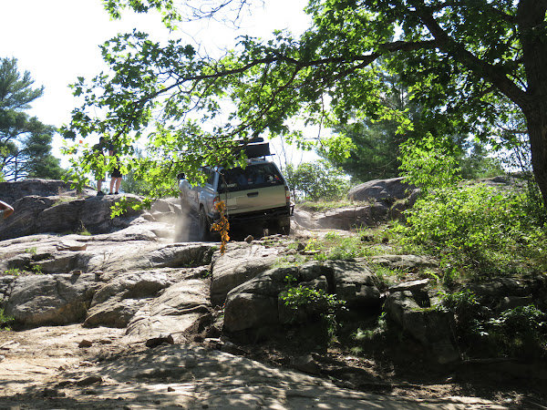

    More light wheeling:
    sB4iOQP_f1mRjUxQnFpxjiMLTXD5C04H3eaCAj4g_8e8f5229cec67d14768df28a2a11f838713834de.jpg

    :eek: :notsure:
    80's - wasn't t me
    90's - I was sleep driving
    2000's - my neighbour took my truck
    2021 - vaccine side effect lol.
    Seriously Yea I should of planned for it but better late than never...
    2022 is going to be a good year.

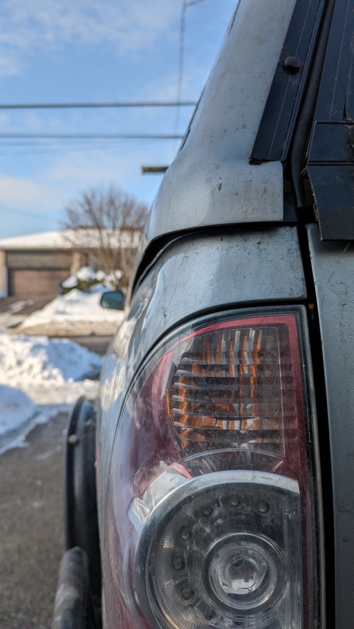

    4BC08C5E-26FE-4E07-9EFD-F18BD59D41DB.jpg Just an optical illusion. Call it the curb effect.

    it looks bigger that it rally is ( Thats.......said) lol.
    ok i get it guys will be working on this, this year.
    Thanks for all the reminders of "light wheeling" lol
