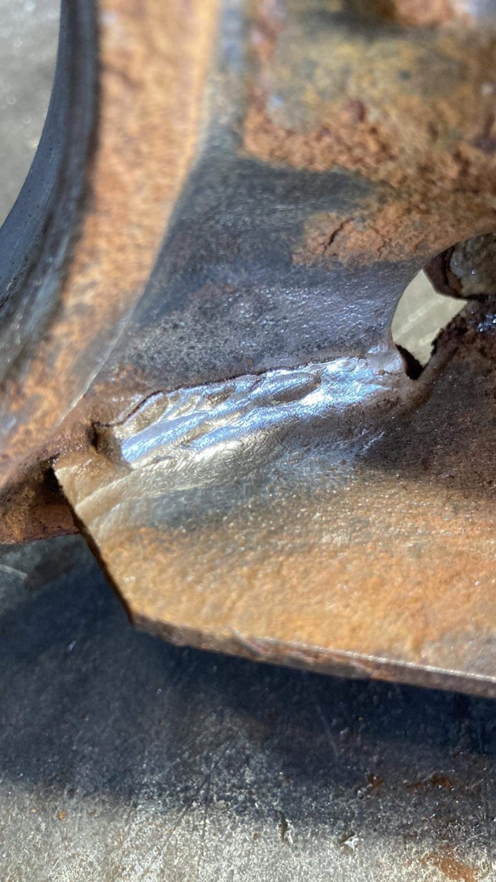

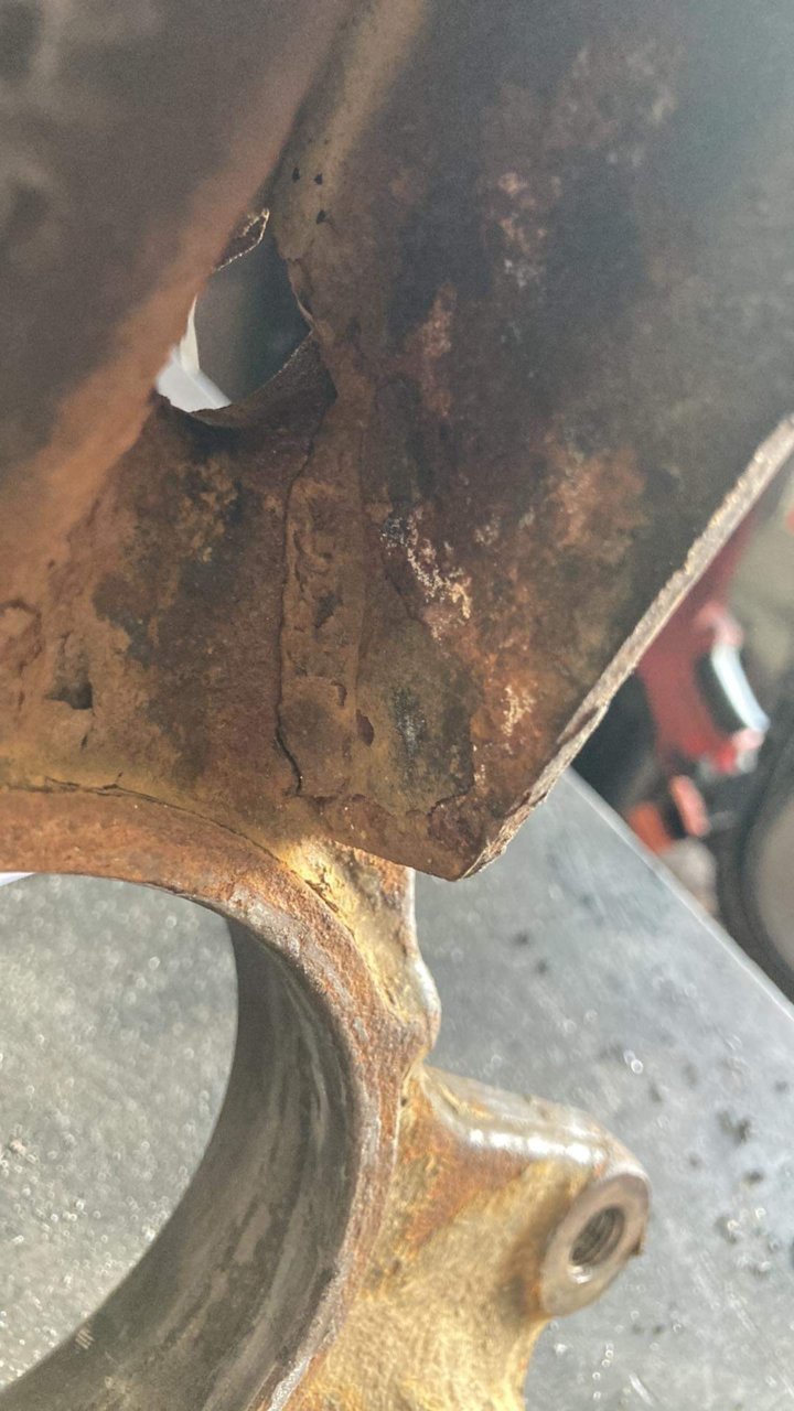

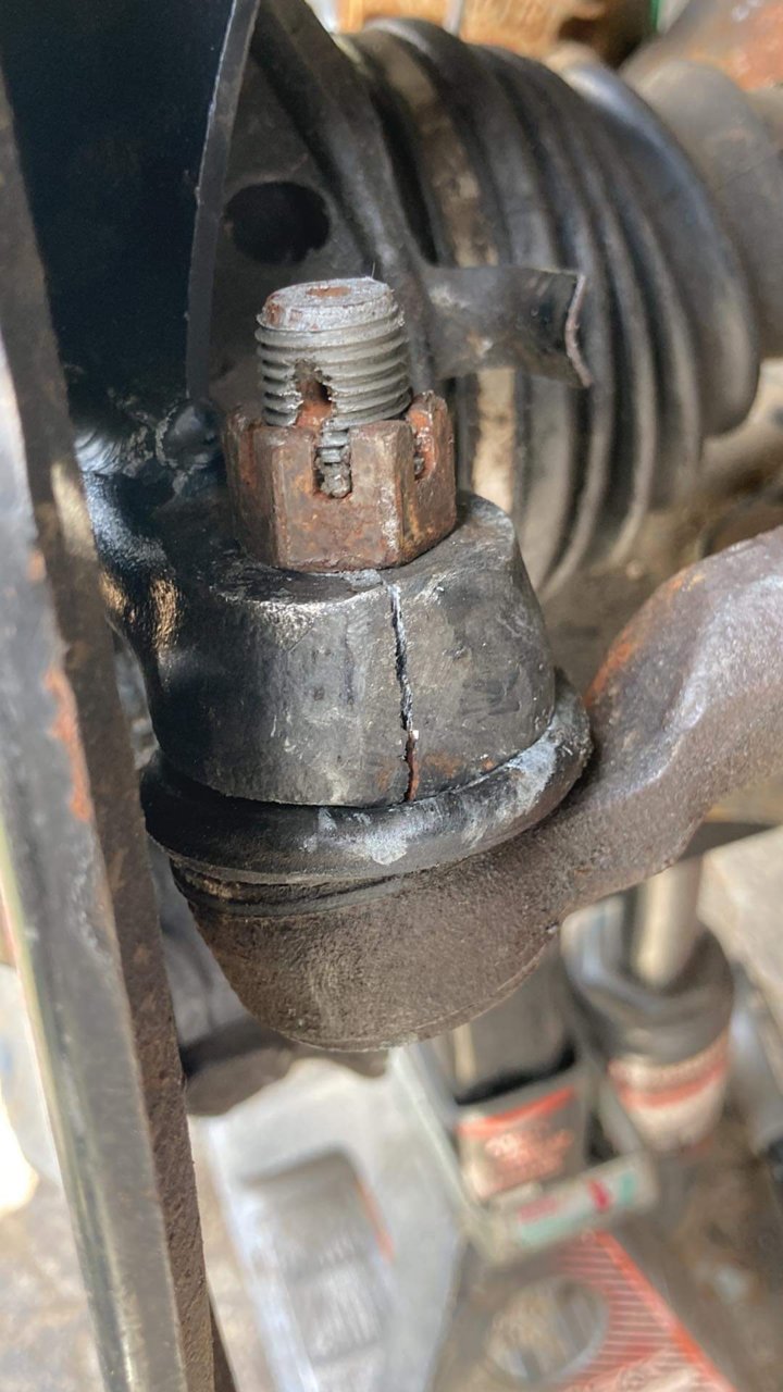

    Had a great time doing a wheel bearing today.
    727D497E-7A42-4B86-A4FA-B878DD8170B6.jpg 8FCB4EA7-1AF2-4A28-B893-27C2B4C31808.jpg
    Cracked while torquing with the torque wrench. Ball joint separator is on order. No more hammering to get the tie-rod to release. Live and learn.

    One of those times torque wrench can lead you astray. The nut was way overtightened, basically acted like a cone expander and broke the spindle. Look how far past the notches the cotter pin hole is:
    AM-JKLWs-v5W8nltmzy0fAqEyRCxR6Z-LNjWzkco_7210aedd24282c16230310958b0a695a5c2e28d5.jpg
    I cross-threaded the transmission pan check plug on my last truck torquing to spec. If you have any lubricants on the threads (antiseize, drained oil, grease), the FSM torque spec needs to be reduced by about a third.

    Good to know. The torque is only 67 ft/lbs so I figured even with a “wet” torque it wouldn’t matter all too much. Also “always done it that way” so didn’t even think too much about it. Happy it happened in the driveway.

    So far I haven’t broke the spindle wheeling or because of wheeling (other then the cracks). Should be okay. Worst case I’ll gusset underneath.
