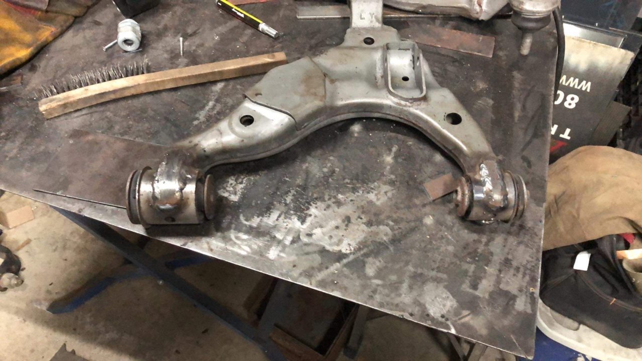

    Getting the old bushings out is fun eh? I went and ended up sealing the control arms up to. Sleeved the holes with some tubes in case I wanted to mount skids. Mind you I did weld some thin plate for some protection.
    Can also gusset around the lower mounts to prevent failure
    this was before sleeving the holes. You get the idea.

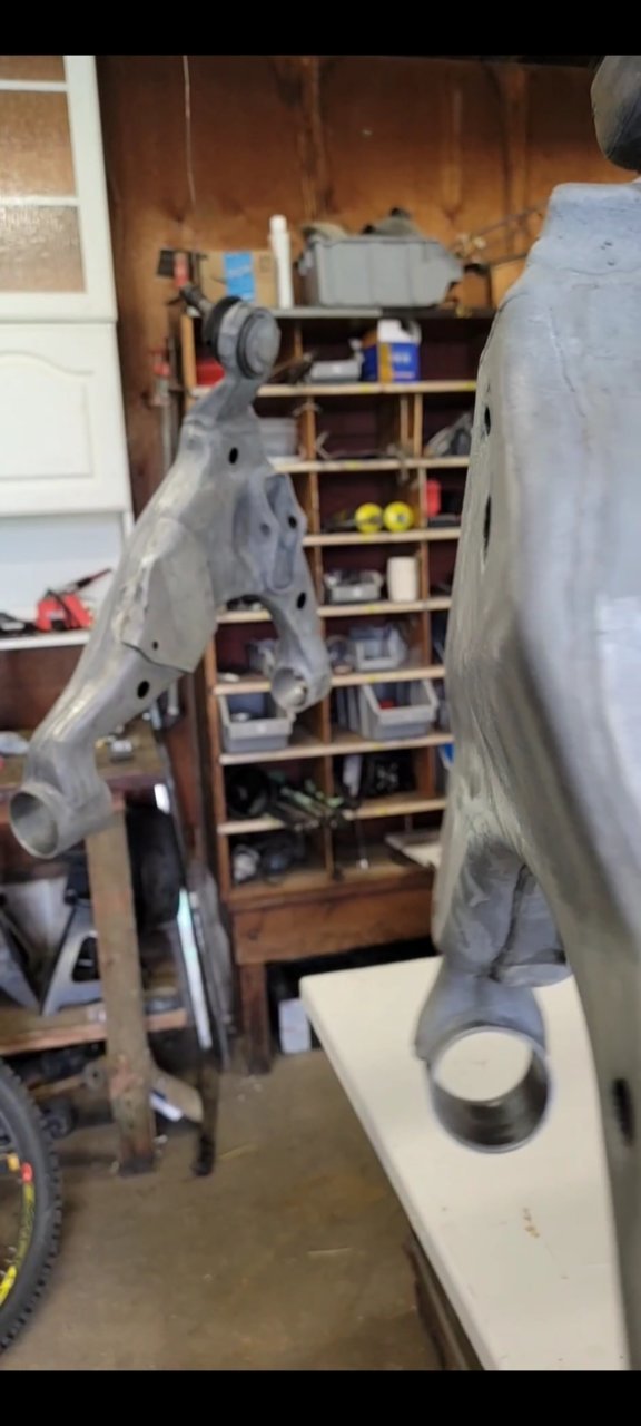

    Bushings aren't bad to be honest. Have done it enough times to develop a system. Map torch to center ring, slides out, then sawzall the outer ring, then cold chisel with a mallet pops the whole bitch out. POR metal prep, self etching primer and your choice of clearance spray from homedepot

    Also while I had the whole set up out I started the prep work on the Chevy 63's

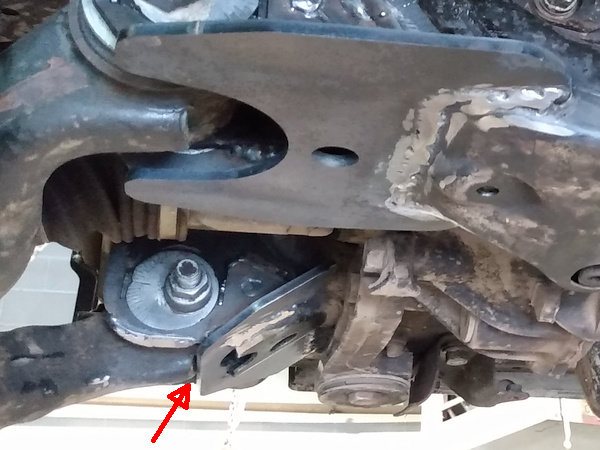

    You talking about the LCA frame braces? They may interfere with the LCA bushing hoop gussets depending on alignment cam bolt setting:
    AM-JKLW9vcn-aDrmI_kVB7MHZQbqAFhmAZftmjlm_ceb44a120bac2df04ea499737d390d26e2f29125.jpg
    Nothing a grinder can't fix, but be prepared.
