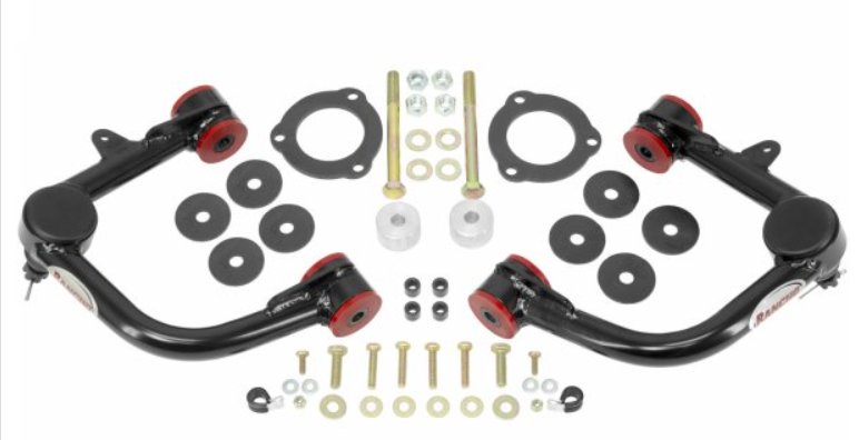

    The install instructions show the UCAs use Moog ball joints and rubber bushings, same P/Ns as Moog's stock replacement parts. Should provide acceptable service life.
    Since the bushings are rubber and not urethane like the photo mistakenly shows, be sure to tighten the UCA bolt with weight on the suspension.

    Lol, so probably rubber bushings then. I noticed the discrepancy too but willing to accept what I get (preference for rubber)
