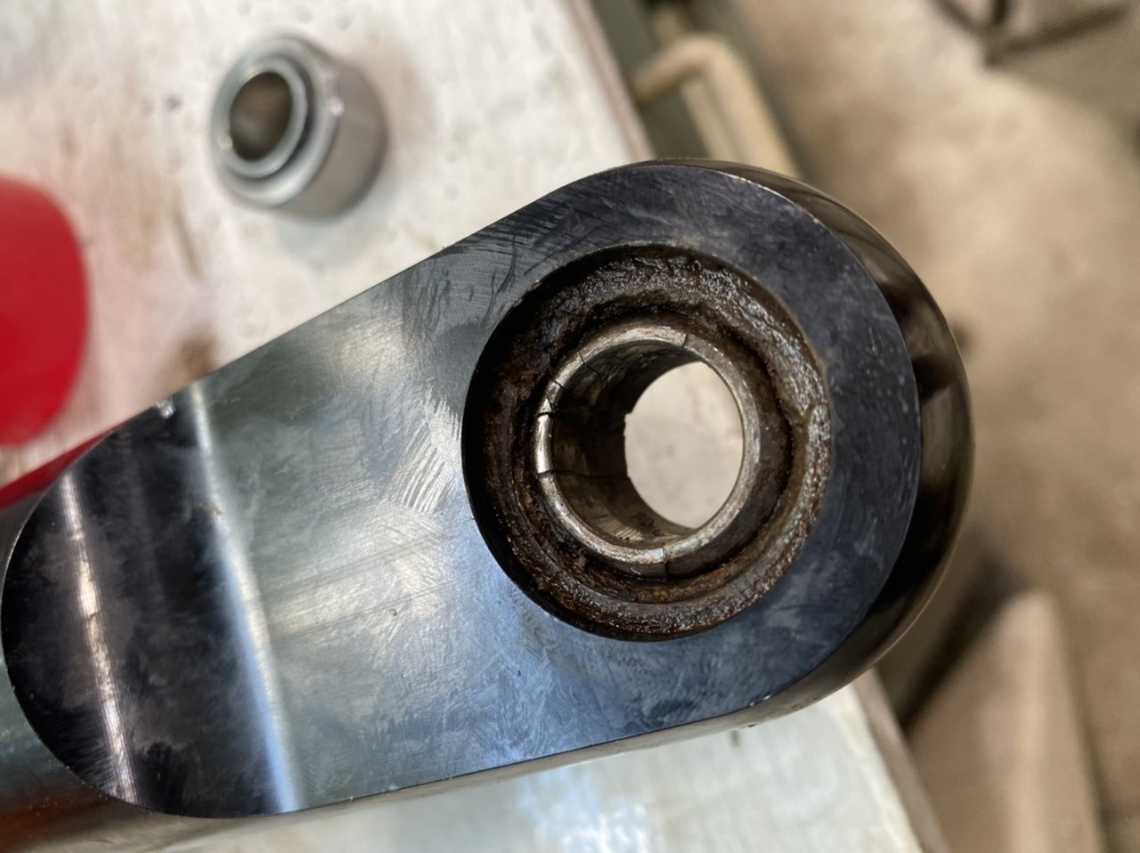

    And another one! Elka suspension after less than a year…

    ^What brand are these bearings? FK? Aurora? No-name?
    How do the reducer bushings look?

    Those are @tacoma16
    I moved to Dobinson since then…
    Says elka on the actual bearings

    My Fox shocks have no such issues and they are 100K km old now, and 50K of that was on @Norilsk truck.

    stock Fox bearings are FK. my research and parts search suggested Aurora spherical bearings are considered best quality.
    best mix of availability, price and fast shipping i could find a couple weeks ago was ebay. bearing houses in town were talking availability in November/December.

    From the FB story, the reducer bushings sheared like mine. That probably damaged the other parts. One possible solution is to ream out the reducer bushings and the LCA hole to 5/8" and run a 5/8" bolt. That'll eliminate the thin wall portion of the reducer and let the bearing ride directly on the bolt. Make sure the bolt has a smooth shank where it contacts the bearing.
