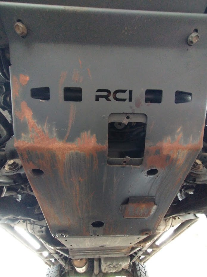

    RCI Steel skid plate. most of that was on 30s and no lift at Ardbeg. I'll let it speak for itself.
    :notsure:
    Aluminum will do the job as well and will be lighter. there are a few guys that run the OKX plates, solid for the odd time to head to the trail.

    That it?
    Rattle can will fix that...
    Those aren't even scratches,
    I've got an Al OKX plate.
    I agree , for people that want their trucks to still be a daily driver they are fine.
    When you get past the point that Al skids are not good enough,
    You will have broken many other things on your truck first.
    (notice that no names were mentioned in the above sentence, but we ALL KNEW )
    Nice thing about Aluminum skids is they are easier to beat back into shape with a BFH if you do hit rocks going way too fast.
    And they don't rust.

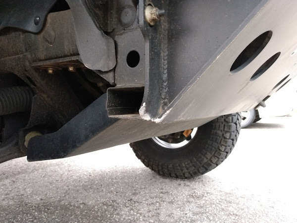

    Jokes aside, 1/4" aluminum bends easily. My bumper kissed the rock ledge at the end of the water crossing in Anson North and this happened:
    IMO a good balance between weight and durability is 1/8" steel skids - it doesn't smear against rocks like aluminum does, and you can bend it back without losing a lot of strength. Unfortunately the only company making those is BudBuilt, and their design isn't ideal for clearance.
