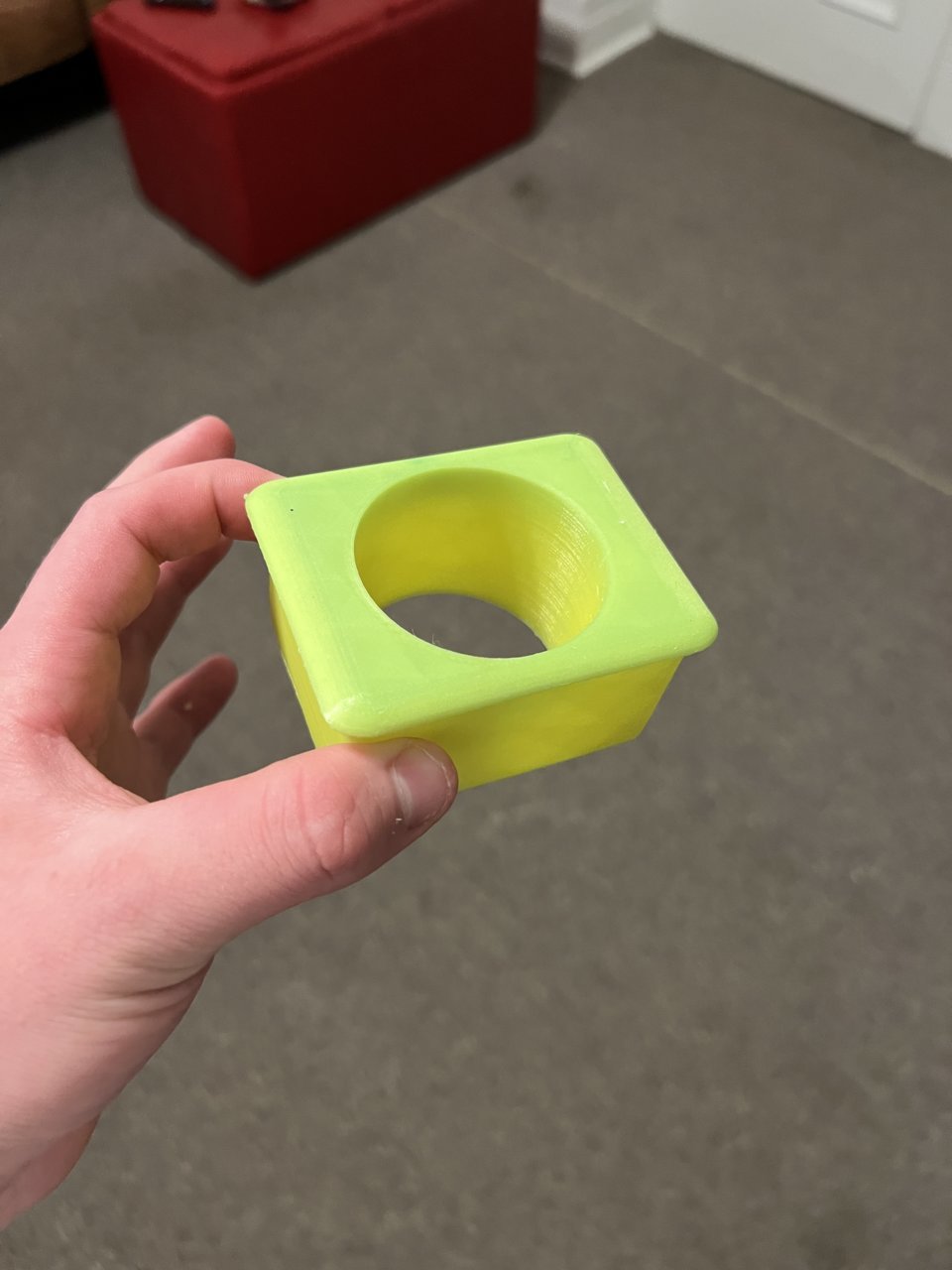

    Anyone know what I just made?

    12,946
    District 6ix
    3G Tacoma on 35"s, 5G 4Runner
    Fleshlight / Red Bull holder for the square slot in the center console?

    Redbull holder, ding ding ding. Also heat sensitive, darker color = colder drink. Dark green is cold as can be, yellow is piss warm. Just came off the printer at 60, so neon yellow = what the fuck did you do to this redbull

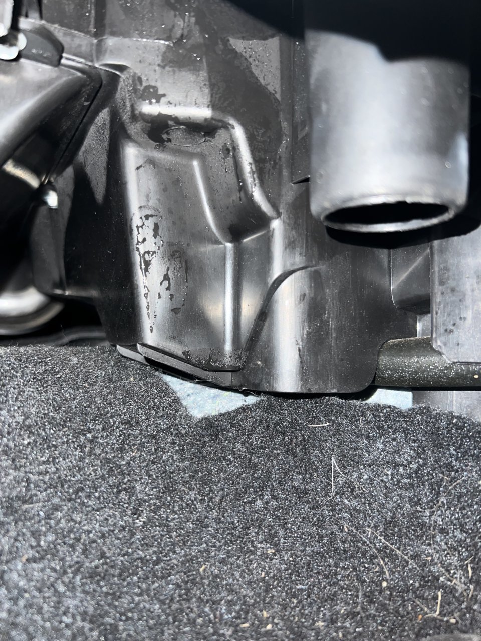

    So I may have found partially the cause of my weird condensation- wtf is this box under the stereo? Directly at foot level. It’s freezing cold and covered in condensation on the passenger side.

    That looks like the bottom of the evaporator housing. Follow that hose to the firewall exit. Make sure there isn't a cut somewhere in the hose. Did you blow some compressed air through the hose as mentioned earlier?

    No, I don't have access to a compressor at the moment. I did check for cloggage tho, rudimentarily by sticking a big fucking screwdriver down the engine bay side tho :anonymous:

    Did you pull the hose through the firewall and do this from inside?
