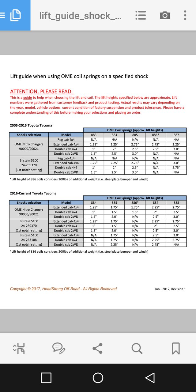

    So after much discussion, we have decided to set the front bilsteins on the 2" lift setting, 2nd from the top. Trying not to go over 3" of lift on the front.
    As the 885 coils are going to be giving much more action than the stock coils, since I do not have a plate bumper yet. With a plate bumper I imagine the 2.5" setting would be correct.

    With 885's you need the bilsteins set at 0 for 2-2.5" lift

    Sir, I have an AC not DC.
    So at the setting we are planning, you are saying im looking at 3" - 3.5" lift?
    https://youtu.be/ZOCtx6mM-u8?t=1m
    So we had planned on the 2 inch ring. You are saying I should be at the 1 inch ring for what I want to achieve?
    I dont see how the 0 setting will give over 2 inch of lift, just the coils doing it all really?

    I'm on the lowest setting with 885's sitting at 21 3/4 from center of hub to bottom of fender. Full skids, group 31 battery and sliders. I can't really comment on an AC vs DC size

    Bang, Google machine saves the day...

    Yes I saw this table before but could not find it again!
    Thanks :hattip:

    And the confusion. They call it 1st notch. Bilstein says 0 lift ring, or 1 inch lift ring? WTF is 1st notch?

    I would imagine the 1st notch is the 0 lift ring.

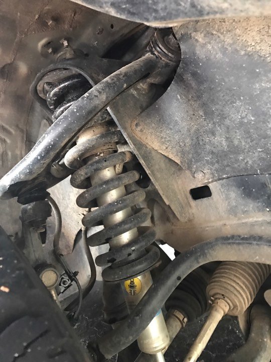

    @llamasmurf this is stock setting on 5100's with 886 springs

    Steel bumper? Can you please measure center of hub to bottom of fender?

    ya bumper is steel, im at alicias dads house so i don't have a tape measure, but as soon as i do i will measure

    its not a bad ride, some people get a little worried about having springs that heavy on the 5100's but with the bumper and the winch, the 885's wouldn't have worked. and with the amount of wieght, i have in the front its actually pretty smooth.
