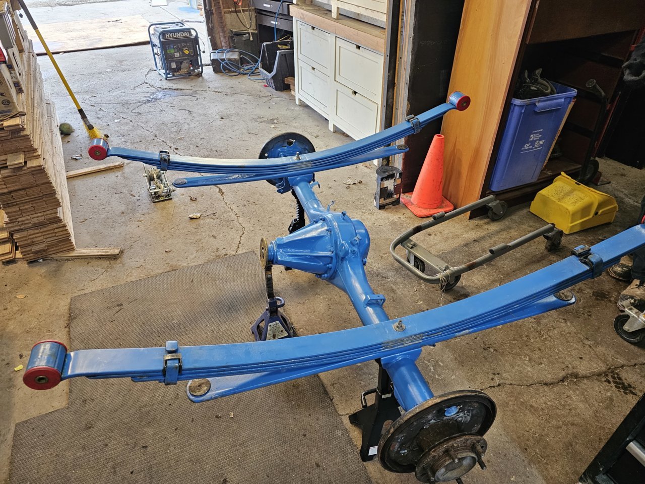

    Axle, drum components, springs, shocks and rear hangers out. I'm fucking tired

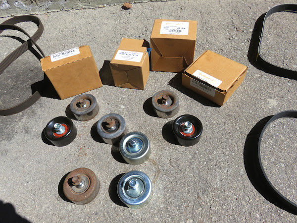

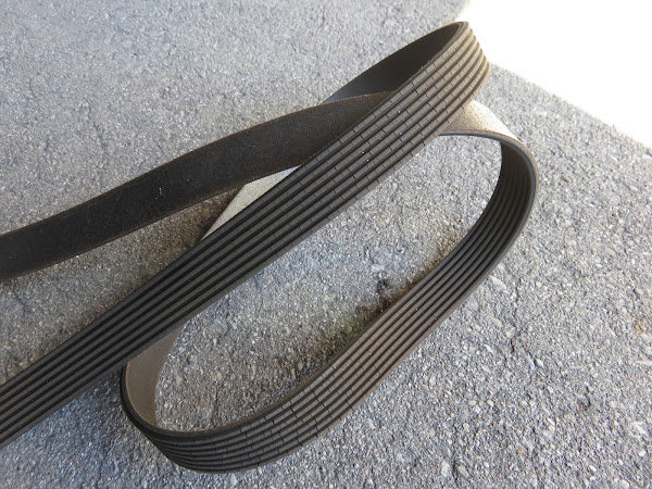

    Replaced the 4Runner's fan belt and idler pulleys (including the one on the tensioner). With almost 227k, the old belt had many cracks on it. All the original idler pulleys were rusted, but the bearings were in good condition and rotated smoothly.

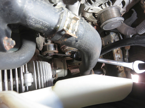

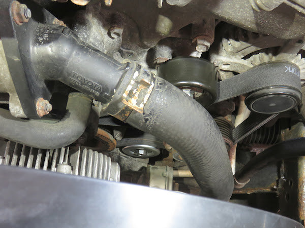

    Unlike the 2nd gen Taco, the 4Runner's oil cooler on the dual-VVTi 1GR blocks access from below. Everything is accessed from the top, had to go armpit deep. The oil cooler also crowds the lower pulley, so there was no room for a socket on the pulley bolt. I had to use the double-wrench method, held together with some duct tape to prevent slippage.
    AMWts8B1mE01pnwdIHWgdY-cdSvl9Gik92IzibiP_6b84028b6ad14922eed7e1fdbb3e216aa86e3d2f.jpg

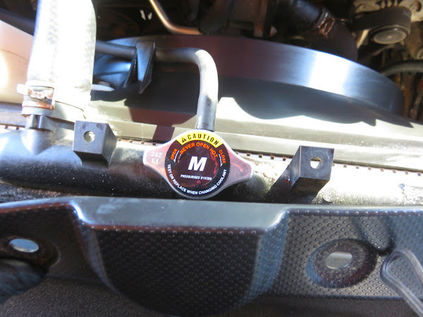

    New belt and pulleys put in. Also replaced the radiator cap as cheap preventative maintenance:

    Parts list:
    Belt: Toyota 90916A2015 or Bando 7PK2150
    Upper idler x2: Continental 49127 (made in Canada by Litens in Vaughan)
    Upper idler bolt x2: Toyota 90105A0126
    Lower idler: Continental 49129 (made in Canada by Litens in Vaughan)
    Tensioner pulley: same Continental 49129, but re-use the LH-threaded factory bolt
    Radiator cap: Motorad T37
