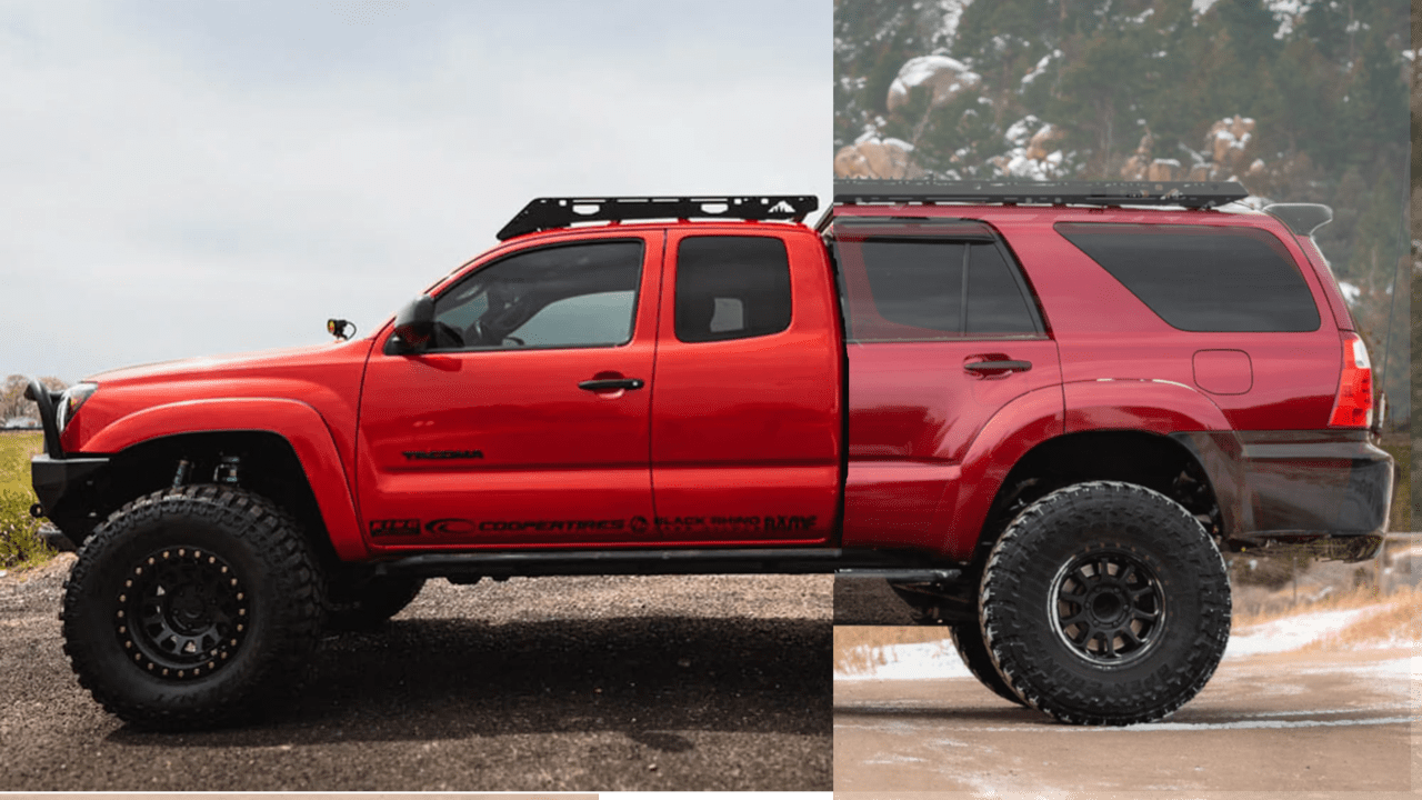

    Whats cheaper than an Alu Cab or building something nice? Frame rotted and broken 4Runners. I present the TacoRunner in standard and LWB. THe

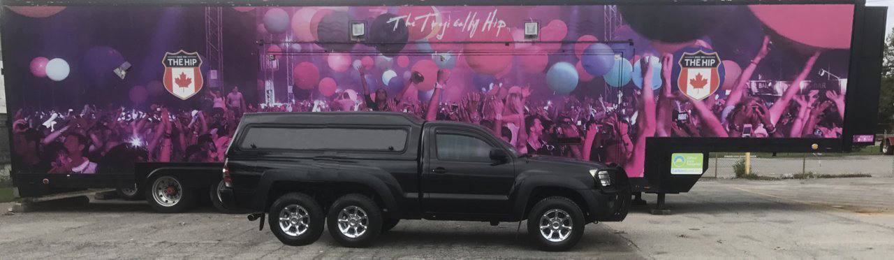

    Dually you say

    Dual pumpkins too...just can't see it in the pic

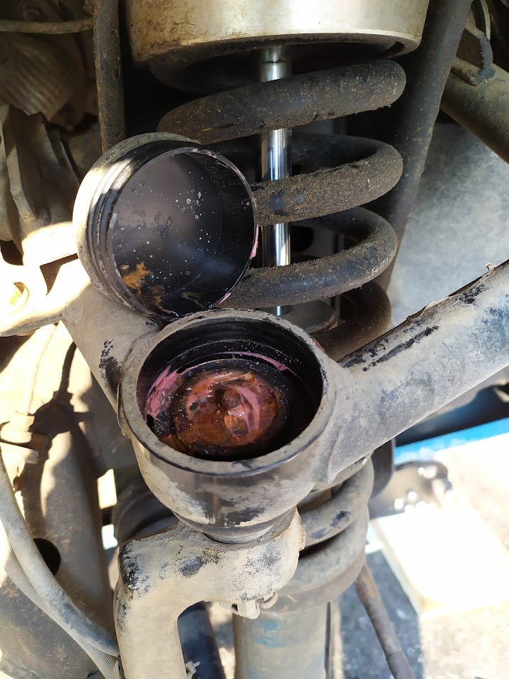

    Now on a more serious note. BJ's.
    <pause for comedic effect>
    The $400 Rancho UCA's from rock auto has a bad BJ at under 20kkm and probably half dozen times out camping and wheeling. To my fault they have only been greased once, if that matters that much (pumped more in and the boot was still full of fresh. The top side under the cover however looks to trap lots of moisture. Not sure is this is responsible for the premature failure but the grease formerly red has turned a nice pink just from adsorption.
    They are OE fitment MOOG PN K80811. What are the opinions on moog parts these bays? better to go mevotech? Would a sealed/non greaseable BJ be better in this case?

    If you going offroad greaseable is better, just make sure to grease it before and after wheeling. Moog is a hit or miss, mevotech i think is a better choice now.
