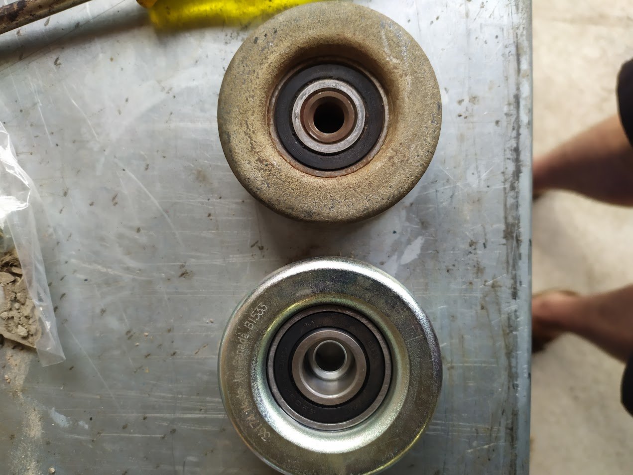

    Operation alternator rebuild was a success! Details documented here https://www.tacomaworld.com/threads/alternator-rebuild-bearing-p-ns.806507/#post-28922491
    One thing for sure. Whatever engineer thought the alternator needed a dinky stamped steel (basically a harness mount) in addition to the giant cast mounts it already has is out there with Mudasser now. The rear bearing was also pretty good still, but the front bearing kinda gets force fed by the fan in the alt. Hmmm, maybe a smaller retainer plate hole could shield it. I have some pretty infant Popeye arms, no clue how people with forearms can get that rear bolt.
    I think the engine is quieter than before its mud bath now :)
    @3JOH22A Your Tensioner pully being the same as the lower is also confirmed. The reducer bushings leave an unsupported section compared to stock. With proper torqued clamping forces, dont feel its a real issue tho.
