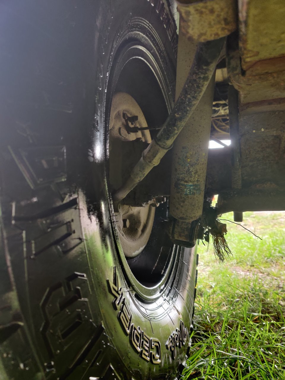

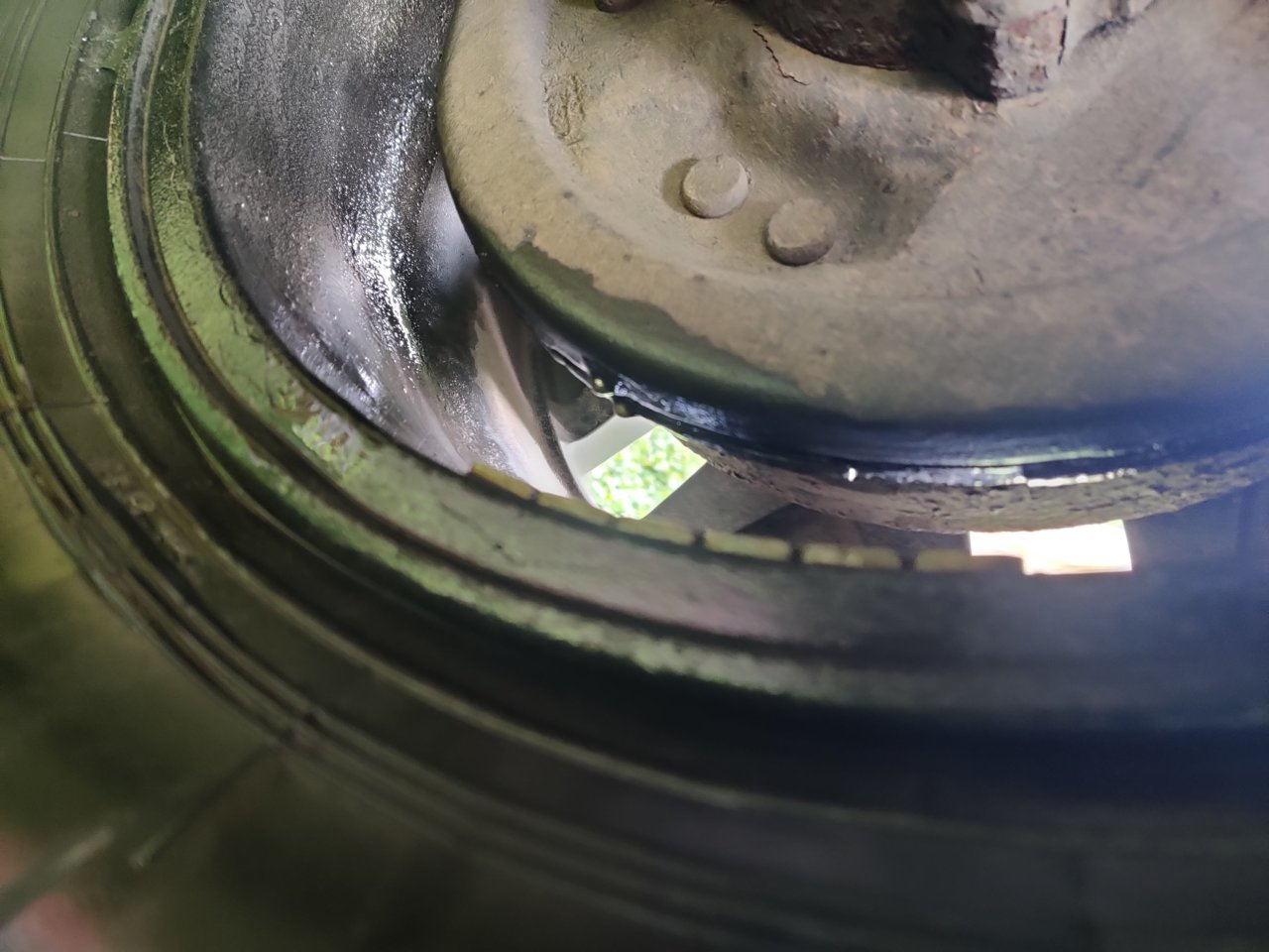

    They worked on the opposite side.
    Anyone know if that's a job I can do myself and what is required? New everything for breaks or just clean ?
  2. Aug 14, 2023 at 11:04 AM
    Norilsk
    Norilsk Well-Known Member
    Nov 12, 2015
    #169435
    8,410
    Eugene
    J100 (Bougie) & UZN215 (Spartan)
    Very easy job, I would say 2 out of 10 on the scale of work. You will need to purchase new rear drum shoes (in case current ones are worn). Wheel cylinder, brake lines wrench 10mm and brake fluid. You may also want to have drum brake hardware (all the springs) available too in case one of them is damaged or broken.

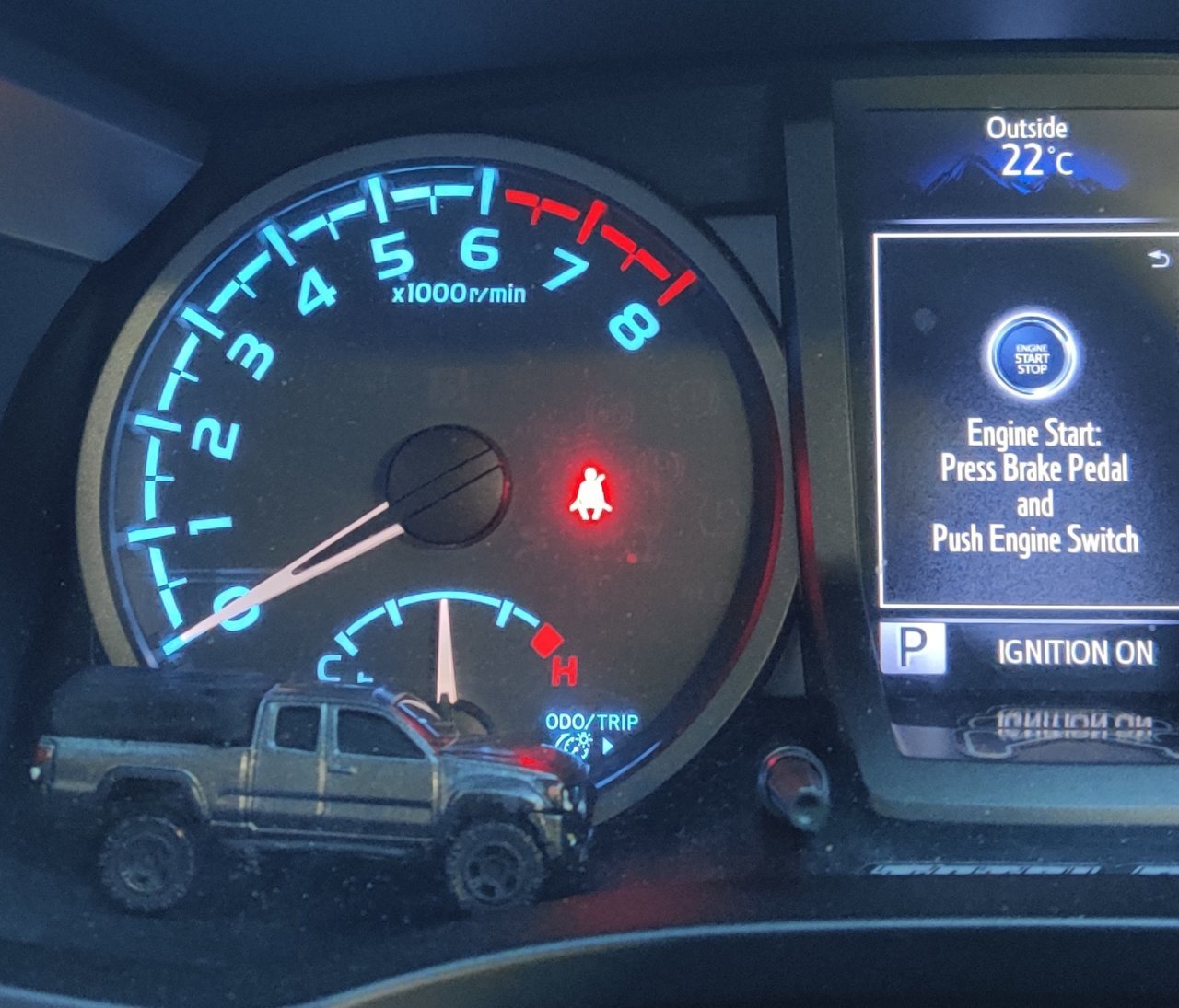

    I haz push to start option as well...but the "press brake pedal" seems counter intuitive
  19. Aug 14, 2023 at 7:59 PM
    Saturnine
    Saturnine YVAN EHT NIOJ
    Jun 25, 2020
    #332540
    4,341
    Dar C
    North of the wall
    TRD go brrrr
    All the mods
    Fun fact, you can turn it on without pressing the brake if you hold the fob to the button and hold it for 10 seconds or so
  20. Aug 14, 2023 at 8:18 PM
    TeecoTaco
    TeecoTaco Liberty Biberty
    Feb 26, 2017
    #211739
    11,047
    SW Ontario
    16 Taco DCSB TRD Sport 6MT
    Modified the level of gas in the tank
    Whats a fob?...10 seconds?
