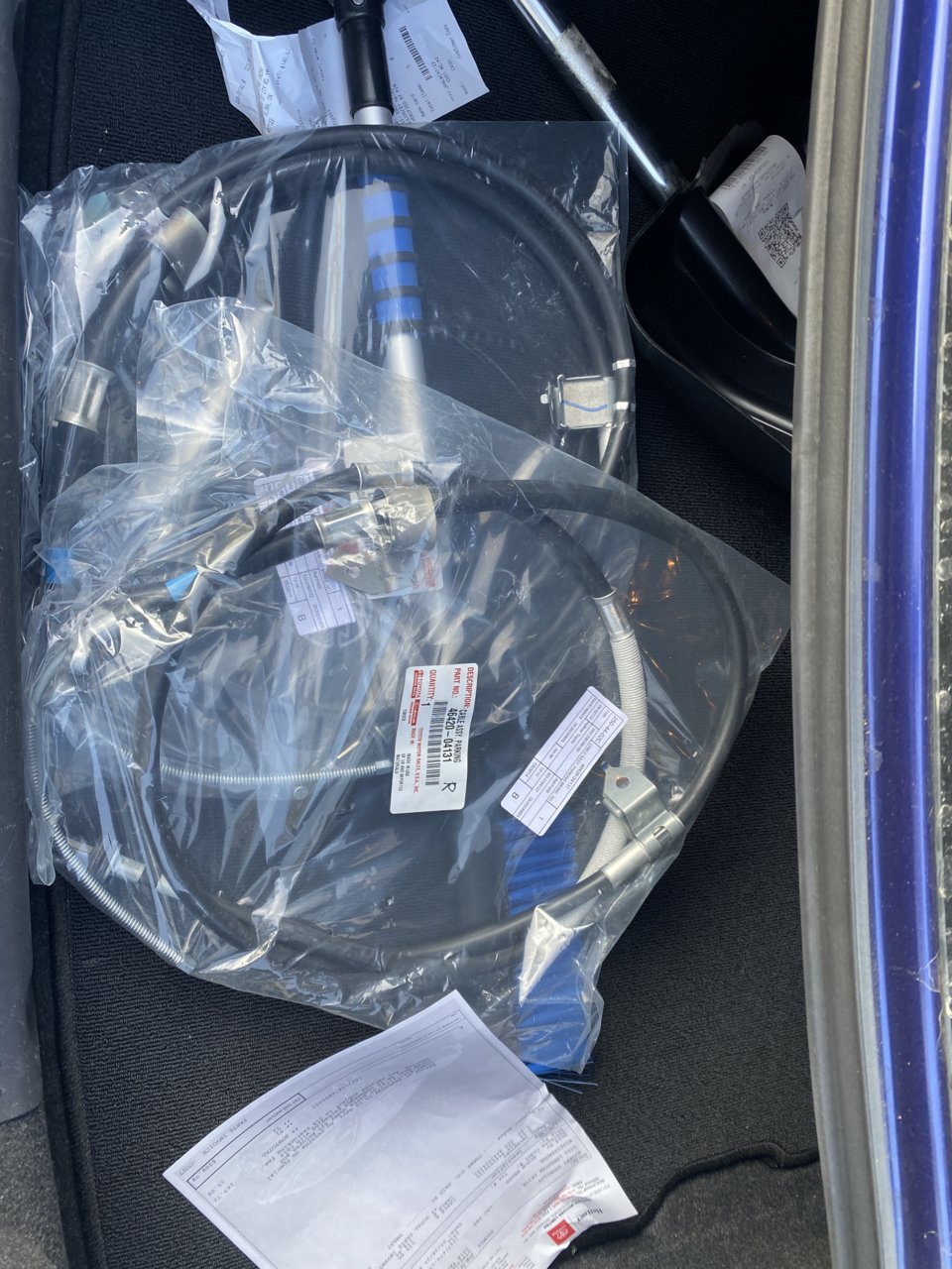

    I have a question this morning hopefully I can get some answers.
    I gave up on my parking brake about 2 years ago. never use it anymore because it never rally worked well enough to hold the truck on a slight incline. its the one located just to the right side and under the steering wheel where you right knee would be. sometimes I felt like i was pulling my wrist off to apply it.
    I did check it and it needs rear parking brake cables but before i do that...
    Dose anyone have this style of parking brake and dose it work for you?

    Your parking brake setup is the same as mine with an addition of a third cable that goes to that handle. Typically you need to change the cables that go from drums to the cabin only. If you want to go fancy you can grab parking brake handle from the third gen and it should bolt on to the location where mine is too (check if you have those mounting holes under console) that way you don’t need to deal with that pull handle.
    I just changed mine, easy job about one hour for both sides plus the time to do rear drum brakes. 12mm bolts on the frame all around.

    I have and use this style daily.
    I’ve replaced both rear cables in the past, because the plastic sheathing cracked allowing the steel cable to rust and swell inside the sheathing. This made the cable seize where it enters the drum backing plate.
    A year or two after replacing the cables, and messing about with the start wheels to get tighter engagement, I realized there was lots (about 5-10 clicks worth) freeplay. I assumed the new cables stretched over time, creating the slack. I adjusted the cable balancer under the drivers cup holder by taking up 1/4” of slack (freeplay). Been at least a year now and she holds damn tight. that adjuster was 5 minute ordeal, pull straight up on the cup holder, two 12mm wrenches, cup holder straight back down
