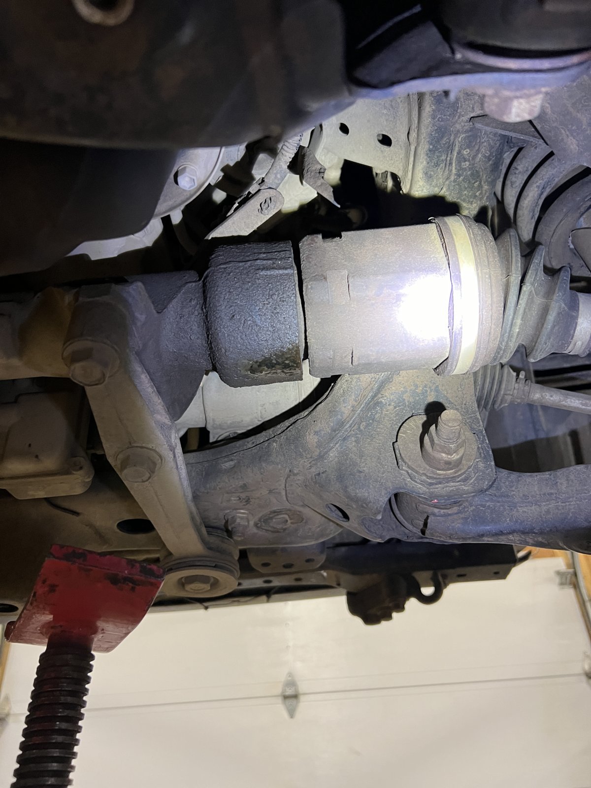

    A number of times. It’s not that difficult. You can make a seal driver out of a piece of PVC tubing. I think I still have the one I made.

    the only slightly difficult part is the CV axle can be stubborn to pull out and push back in. also make sure the C-clip is oriented the right way to make the CV axle reinstall easier and dont drive the new seal too far in.

    I found the pipe couplers to fit decent too for driving. saves buying a length of pipe and cutting 3 times

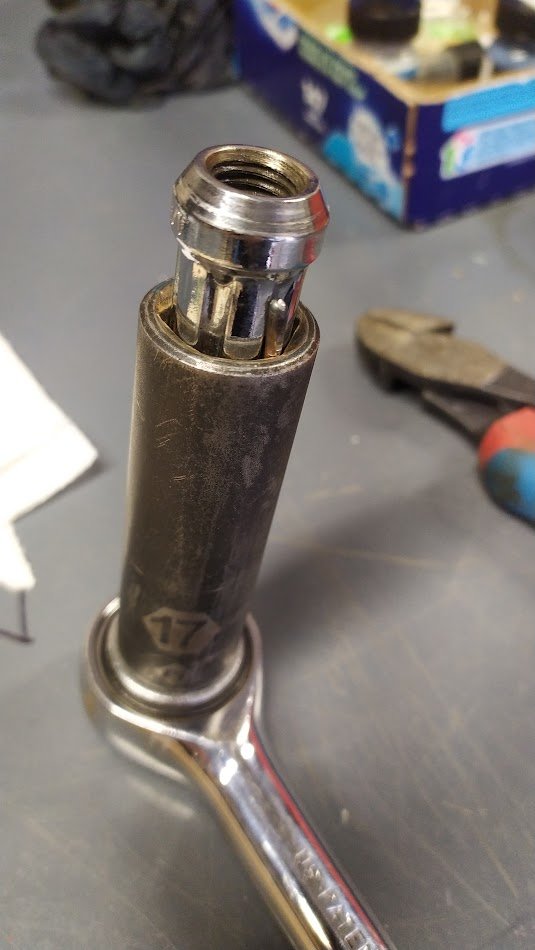

    in case you loose your special socket. a couple pieces of 3/32 wire and a 17mm socket make a perfect fit.
