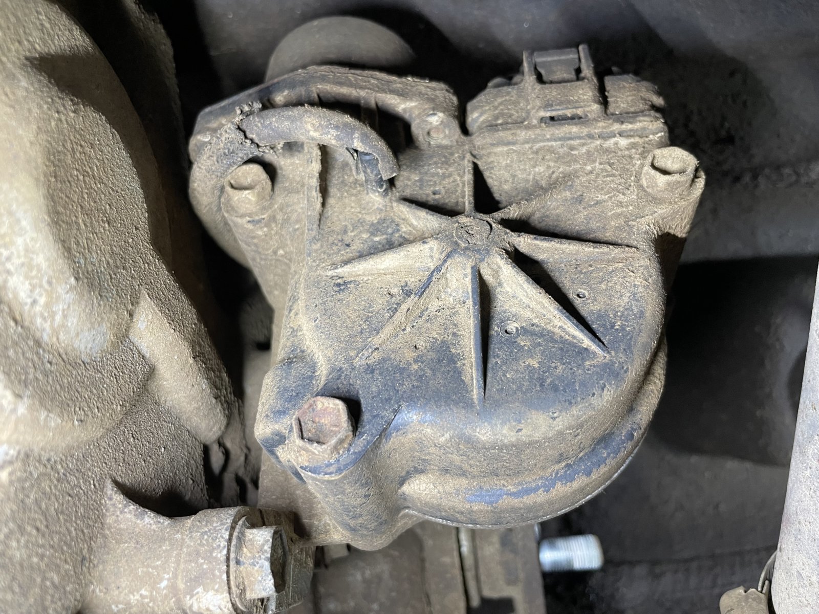

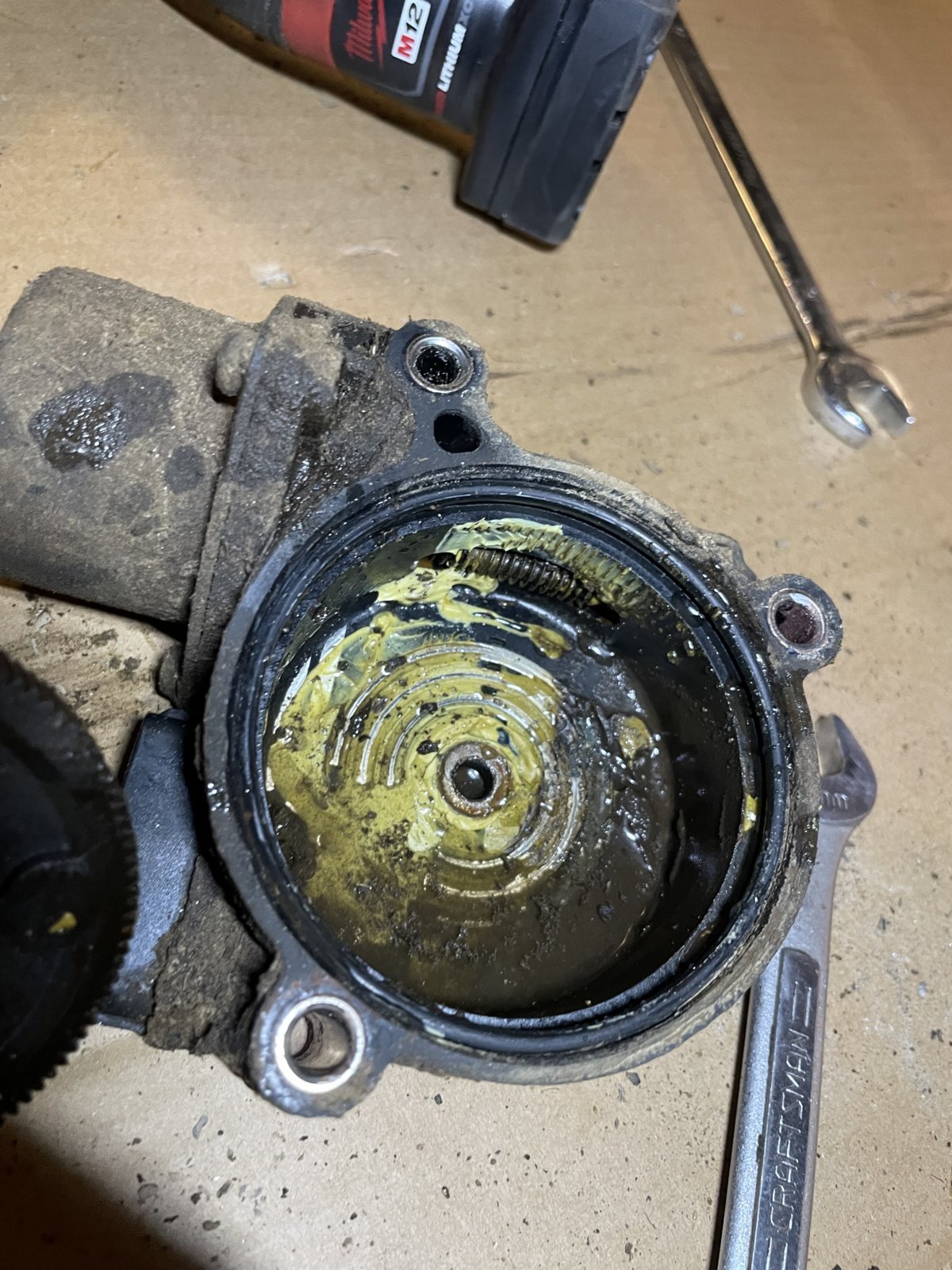

    Heres ur little PSA for ya’ll.
    Keep an eye on this hose or look into a better hose or.. just unhook it if you have a “not unless its broke” type of significant other
    probable cause of failure for my actuator.
    TunedUpTaco, Sloweburn and 3JOH22A like this.

    Which actuator is that? T-case?

    Yes

    3rd gen actuator is built inside of the housing not as easy to change, so yes, extend breather high and away
    Shveet likes this.

    Pretty easy to miss. The hose was split straight down so no way i would have even seen it with the skid plates on.
