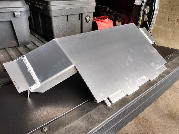

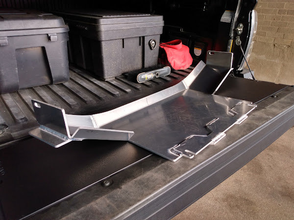

    Am I doing step 8 correctly? Dragged the skid back and forth a few times but the Gar-Fab tailgate panel still isn't "broken in" :confused:

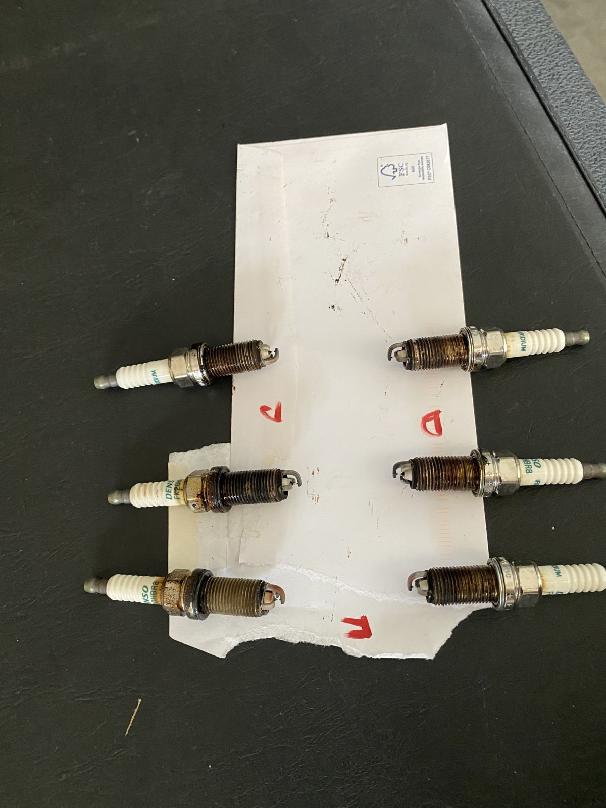

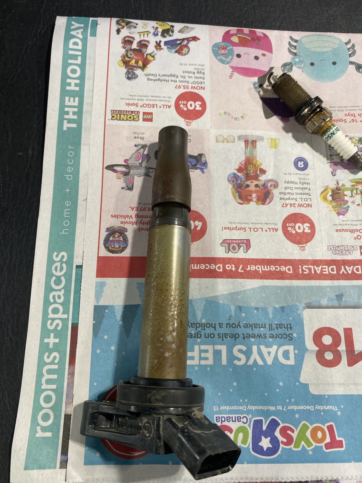

    Oh, how the time flies! Just changed another set.
    As you can see I got slight problem in cylinder 1 and 3, but that's a problem for another day. Truck is approaching 190K kms.
    I would assume valve cover needs to be done on passenger side, thoughts?

    ah... you see. it's aluminum, meaning it's too soft to scratch it.
    need steel skid plates for step 8 to work. hmmm try throwing like a BBQ or a stove back in there. should be fine

    Did the cyl 1 and 3 plugs feel loose when you tried to remove them? Do you see any oil buildup in the plug tubes?

    no, they all were torqued (I do 15ftlb), no oil build up either, no oil consumption either (unlike 1 quart every 6000 kms on GRZ:censored:).
    It's easy to get to those sparks, I'll check back in 10K kms and see what's up there.
