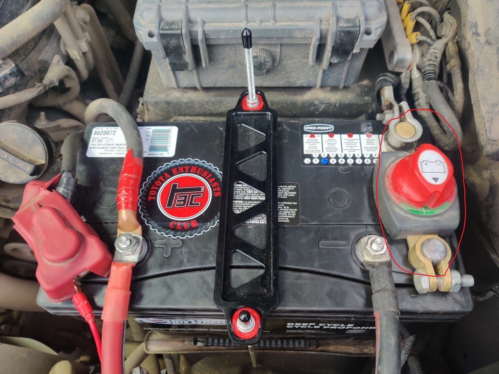

    It fitted. TEC approved. Just gotta trim down that CN tower of a J-hook

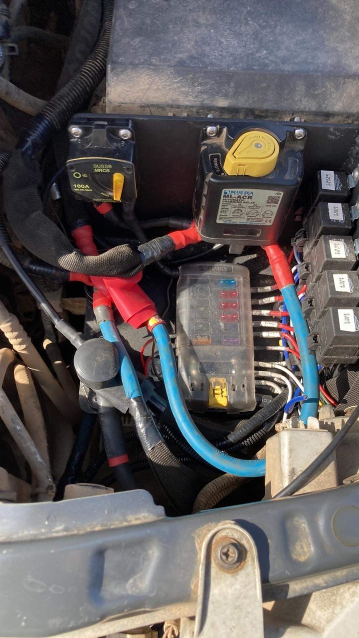

    Looks good. I usually save stuff but when I rerouted the batteries I didn’t think I was going back from this.

    is this in case someone tries to steel the rig.

    It can be. Don't get any ideas, I'm watching you.

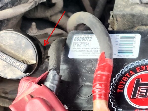

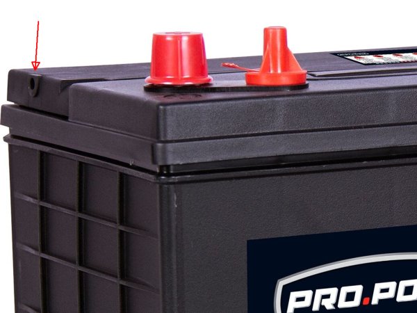

    When the acid spills out of the vents on the OEM battery, it collects in the tray and evaporates with time, saving the fender paint.
    Watch for acid coming out of the vents on each side of your new Princess Auto battery:
    Also watch your oil filler neck clearance. Don't want the filler neck to fall off when the engine torques in its mounts:
