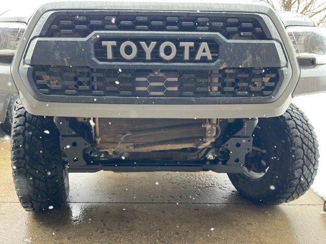

    Got rid of the weak AF 11 guage steel mounts that bent even with reinforcement brackets installed and replaced with the Rockhound Bumper Mount Kit.
    Cut the welds and peeled the mounts off...

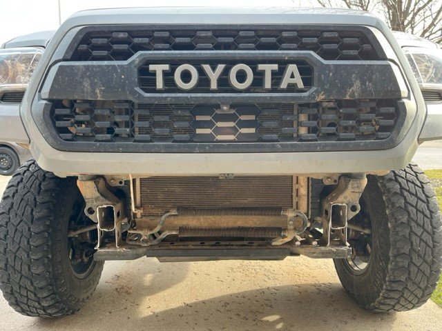

    Mock up to prep...

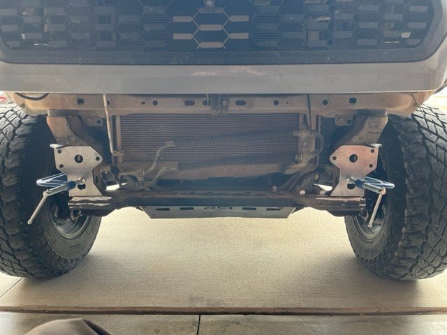

    Welded on 1/4 plate kit and painted...
    Toms2Yotas, tgelata, Windigo and 7 others like this.

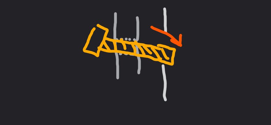

    ah ok, so you wont be able to hang/ locate the bumper to make your life easier to bolt things into place but would need to balance it on a jack or something to actually mount it.or the bolt holes are a tight enough tolerance that you can stuff the bolt in, hang the bumper and then toss a nut on without the bolt sagging downwards from the weight
    granted, its not like you're taking the bumper off once a week so it's a non-issue
