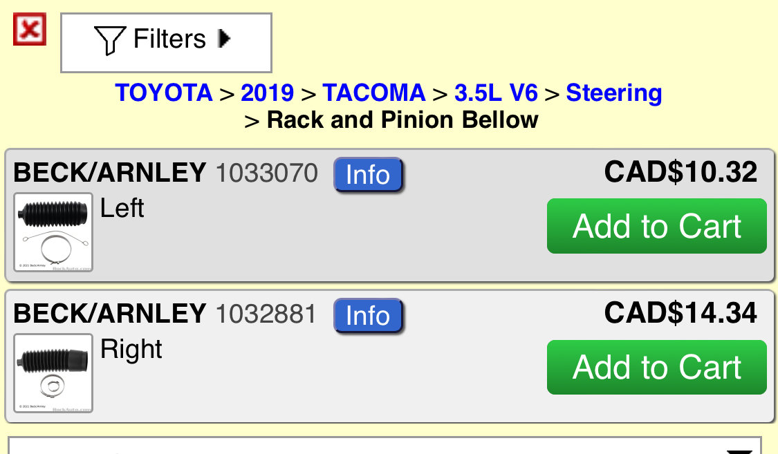

    some play starting to form or started to form a LONG time ago. when Tyler and i installed the ECGS bushing for the CV, we noticed it liked to weeble wobble.
    Could be the rack, Could be the inner tie rod ends that have play (If i hold onto the boot where the inner is and we jiggled the rest of the assembly, you can feel something move).
    i figure throwing money at the problem has a pretty good chance at solving it. Looking at Rockauto and the tie rod ends arn't exactly an expensive part; https://www.rockauto.com/en/catalog/toyota,2018,tacoma,3.5l+v6,3441741,steering,tie+rod+end,7428
    but i imagine it's a bastard to rebuild an entire rack if the seals go.

    ^Yeah that's probably a worn inner tie rod. Fairly easy to replace if you have the right pliers or a pipe wrench. @tacoma16 has replaced it in Ardbeg mid-obstacle...
    Rack replacement is a lot more onerous.

    i assume both sides tie-rods are the same? (driver and passenger)
    other questions is what's "better"? Mevotech or this Beck/Arnley brand?
    Figure i might as well get that tie-rod+ boot kit as well since Yota wants $50 a side for the boots. but Beck isn't a brand name i've heard before.
    https://www.rockauto.com/en/moreinfo.php?pk=4169967&cc=3441741&pt=7428&jsn=878
    https://www.rockauto.com/en/moreinfo.php?pk=10068772&cc=3441741&pt=7428&jsn=877

    If you want OEM supplier here they are
    https://www.asianparts.ca/parts/srt330-4550309490-555-tie-rod-end-inner/
    plus the boots from rock auto

    yeaaaaaaah i'll go with the shitty Mevotechs then.
    i want my failure point to be something cheap and relatively easy. beefing up a tie rod is good for some reasons but for the stupid shit we do, i'd rather the "kerchow" stance than dropping $1000 on a new rack.
